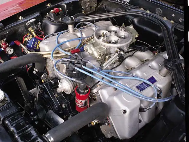

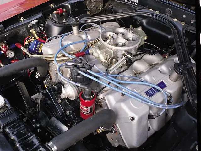

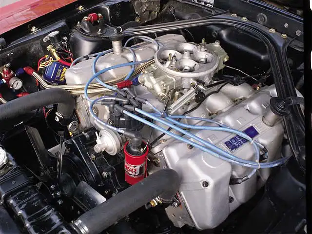

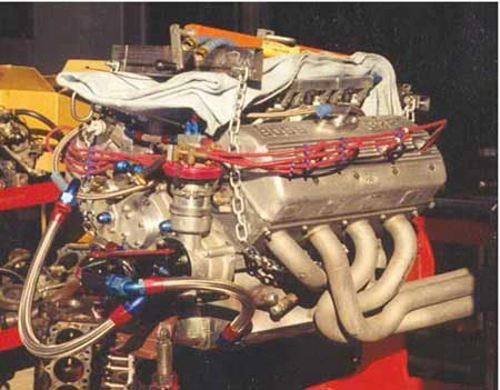

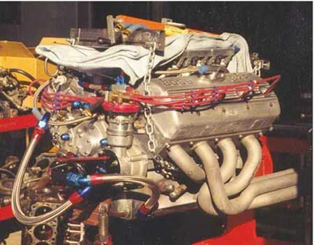

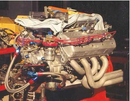

A Boss 429 has hemi heads with very distinct valve covers.
Regular 429's have regular style heads with standard stamped steel covers.
If it's really a Boss (I'd really be surprised) I'd recommend that you buy it for the $3000 and turn around and sell it for the $10,000+++ it would be worth.

Thanks for the pics.... it does look more like the one on top with the wider heads(if my memory serves me correct).... I need to get the pics from him, I saw them a while back because he originally was going to sell it to me for 4500 a couple months ago..... I'm helping him with his car which is partially why I'm getting a great price on it.
