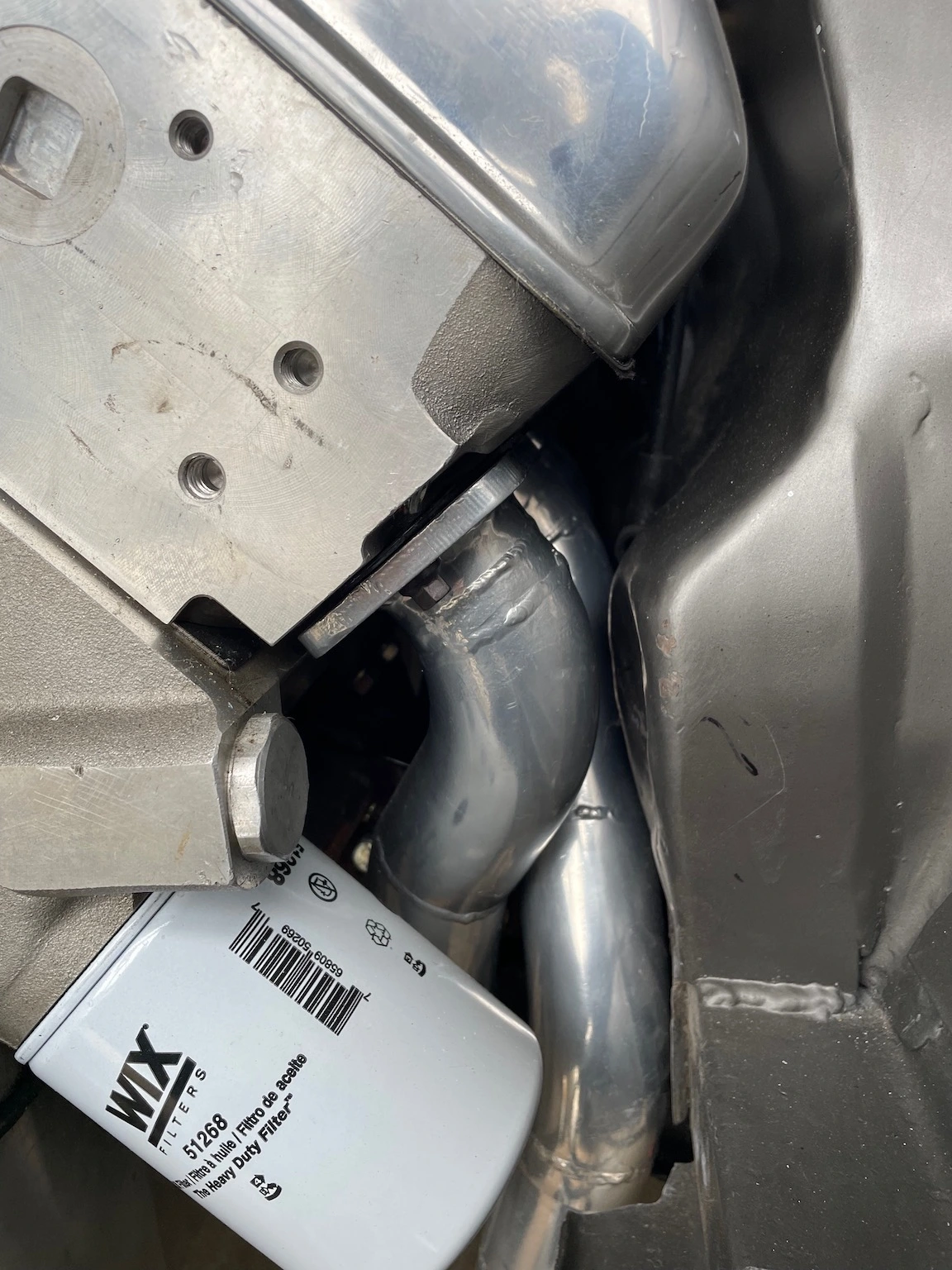

nice project.i did this in 2008 on a 68 coupe,now redoing entire car.what headers and mounts are you using?i wouldnt use the stock type mounts as thy move the engine forward and up about an inch.the crites gen 2 mounts work the best if you can find them.and thats the problem,hedman use to make nice headers for this and stopped a long time ago.make sure you leave enough room to remove valve covers.also,the mount for the lower control arm needs to be trimed on top to clear the headers.i run the stock control arms and and moroso drag springs,close to shock tower.

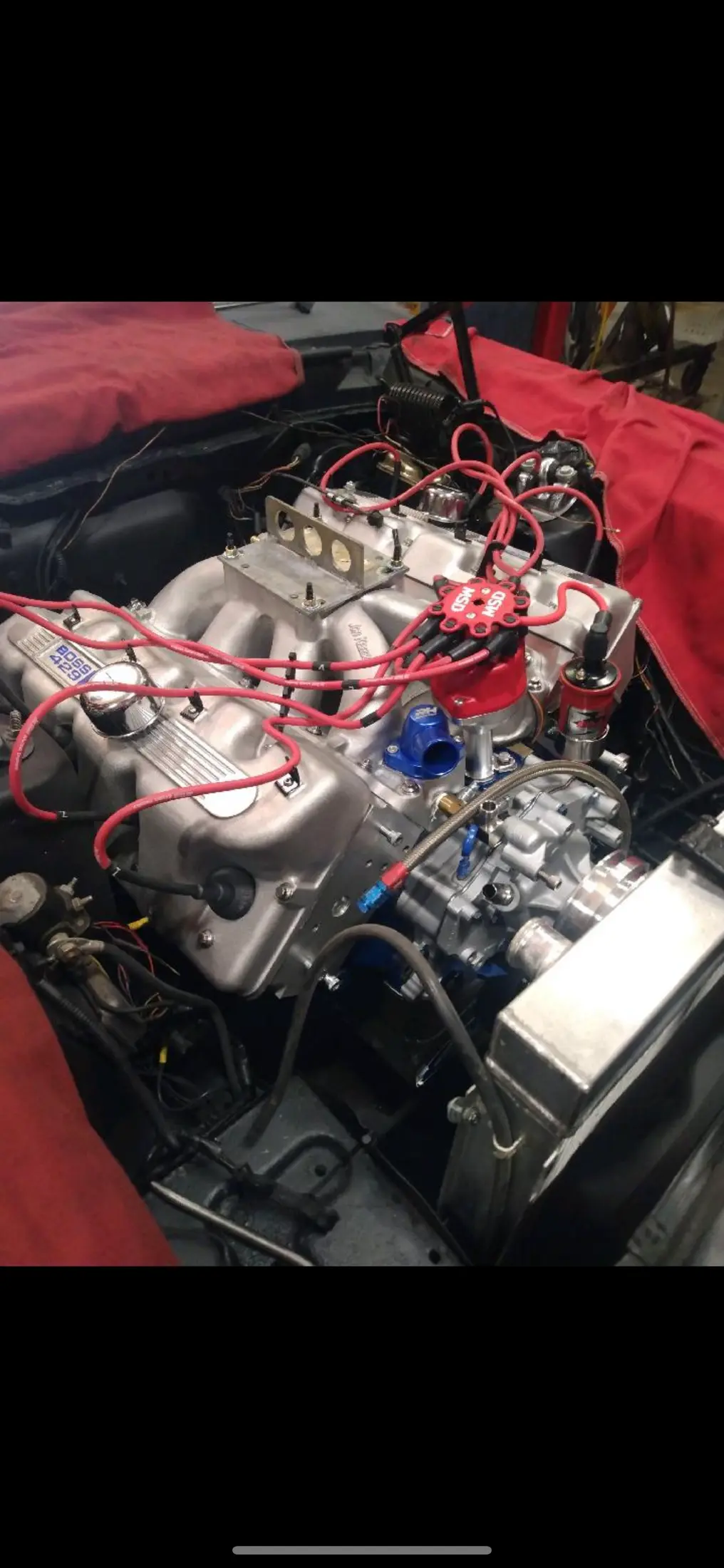

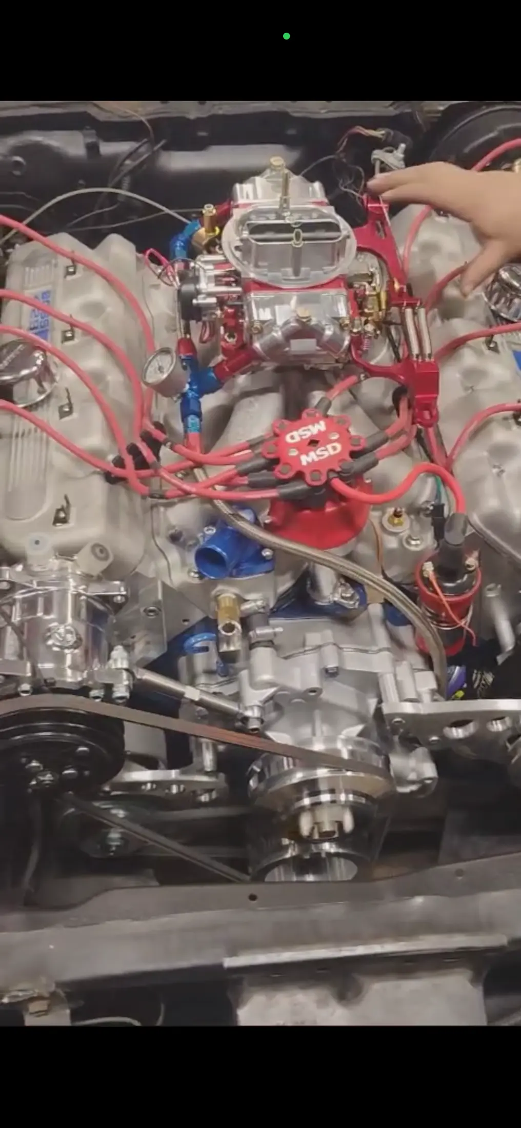

Afternoon ALL, ITs July 17th, LOTS of Delays regarding Header Installation and now some Front End fitment issues but slowly making progress. My engine builder has been nothing but GREAT and I realize things take time with this type of project. Baby Steps but ITs ALL GOOD!!! Enjoy the Summer Boys and I’ll post a pic as soon as I have something NEW to post!

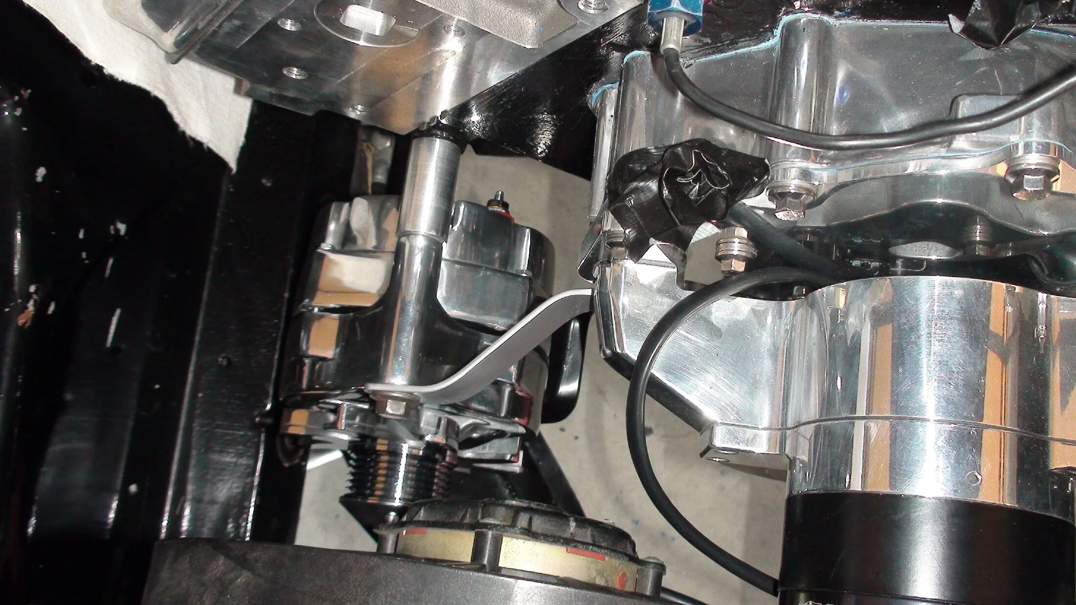

what motor mounts did you use?the crites gen mounts work the best and give enough room for a puller fans on radiator with maziere electric pump.
this is the best picture i can find of the first build on 68 mustng.had to trim the fan support to clear the maziere.

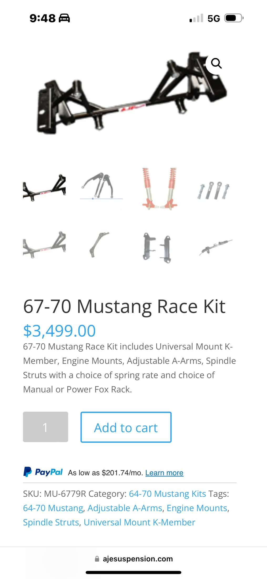

Not sure what mounts that my builder found for the car but this is the front end set up that’s going in, AJE Colt 65

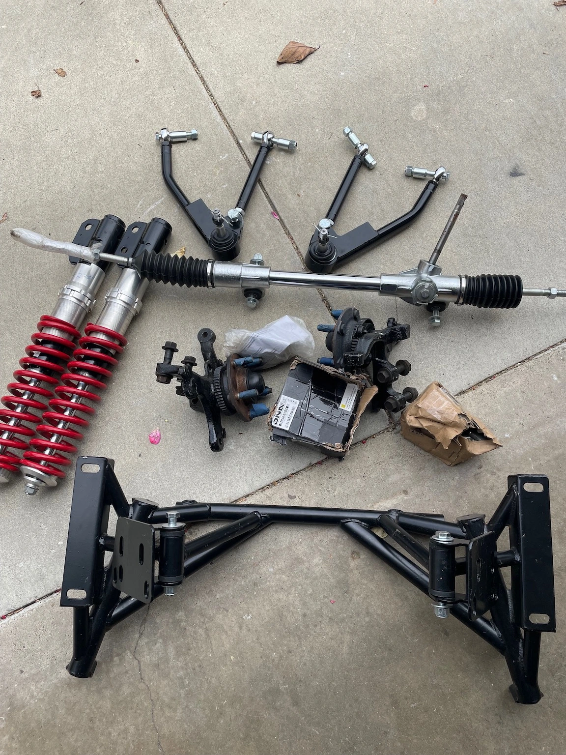

i have this same kit i would sell for $1800.it does not have the spindle struts like the picture,those ar a $1600 upgrade,mine has sn95 spindles that bolt on to the strut.also it was originally for a 64 fairlane but will fit the mustangs as well.also comes with new steering rack.and bump steer kit,and adjustable lower control arms,and adjustable caster camber plates.
also i started a conversation with you.its like a pm.
