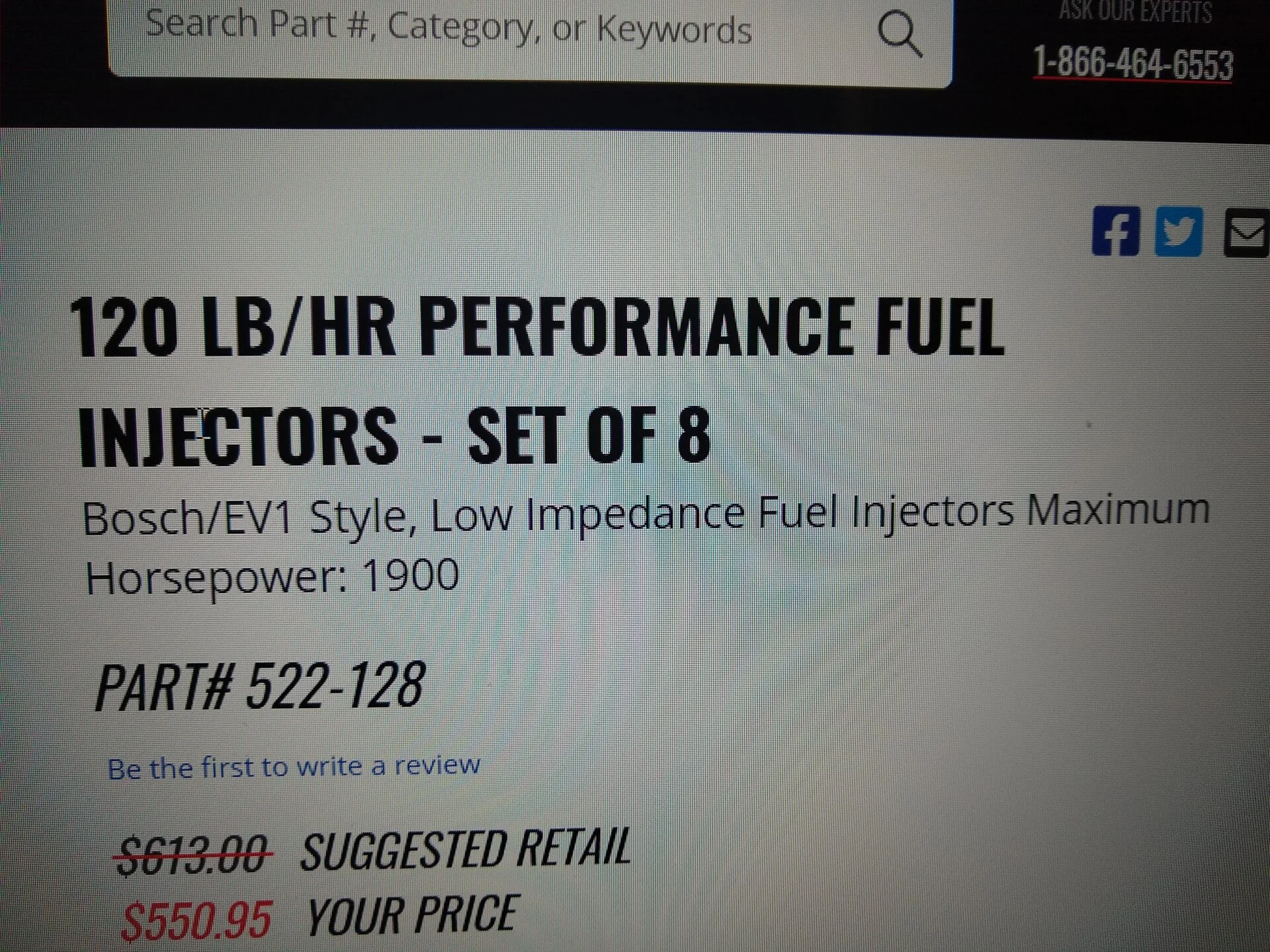

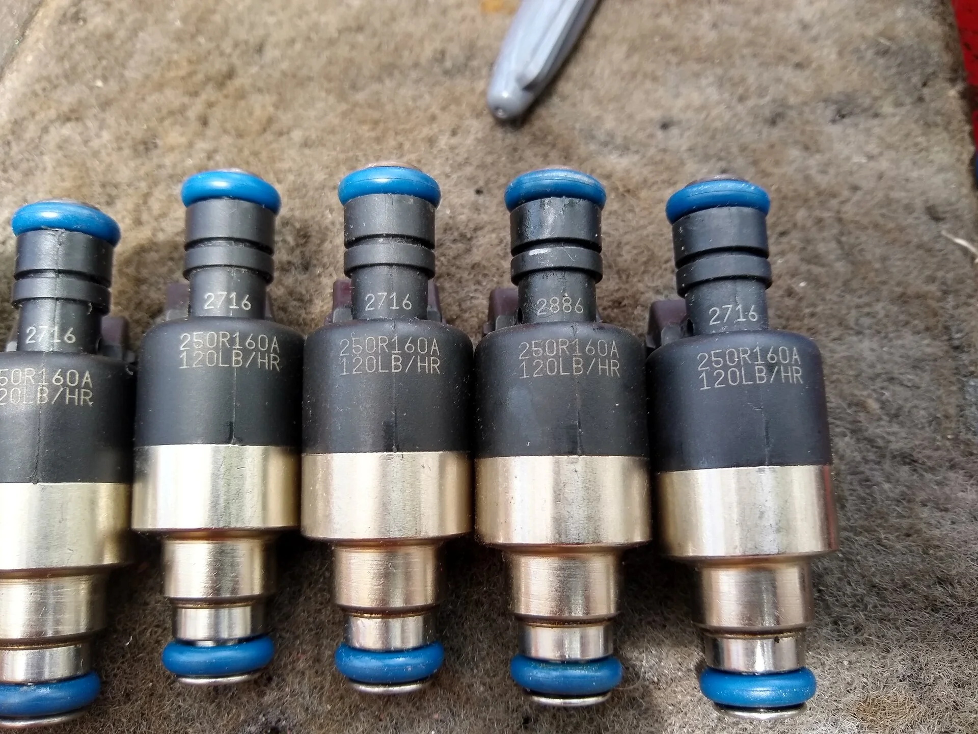

Now for the 210lb statement...Holley sent me 120lb injectors in a 36lb box and I didnt realize when I installed them.Theres no way low impedience injectors can be controlled in a high impedience environment without overheating the injectors and even with my chip I had giant issues getting it tuned until I realized the issue and I had them injectors in with a Terminator X setup that I thought was junk then ripped it out and put a Ron Francis harness and after debugging the harness still had major tuning issues with fouled sparkplugs and very gas loaded oil until I noticed the injector size was way off the mark..
Holley made good on sending me the right injectors but didnt respond to my gaswashed cylinders I had to rehone,pistons I had to rering or bearings I had to replace either and comes to show they dont stand behind their BS...........

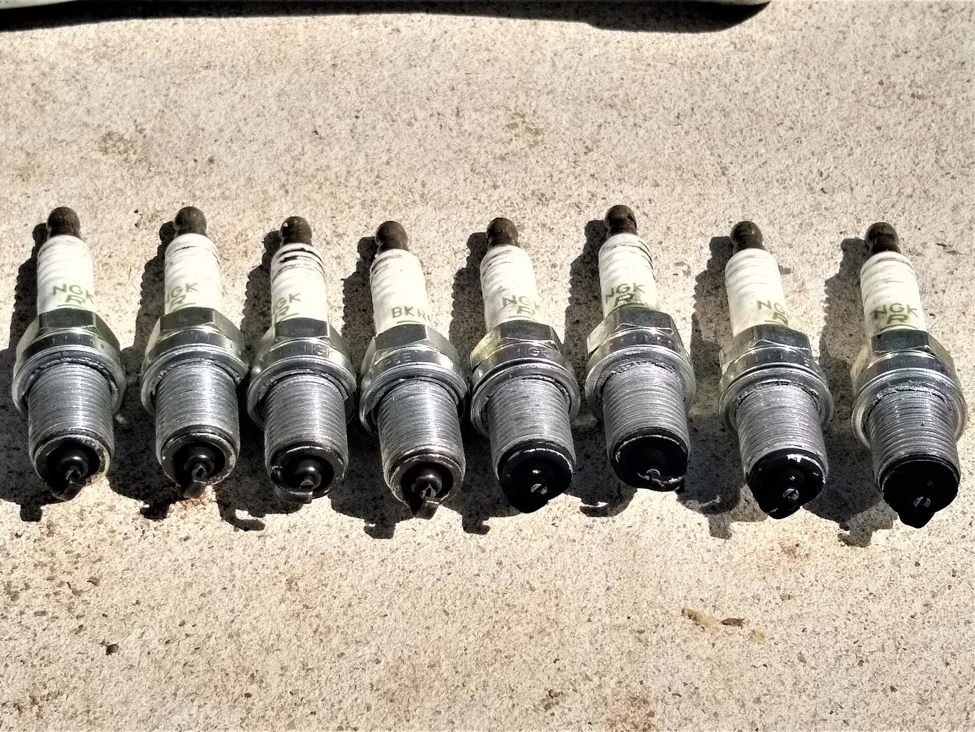

Let me tell you my engine didnt run very well and sparkplugs lasted 10-15 mins idling and not even driving............
These plugs have literally 10 minutes of runtime on them........They look like they ran alot longer...............LOL
The exhaust was so rich even outside with a slight breeze it made my nostrils sting badly and it gaswashed the hell out of my cylinders too.........
