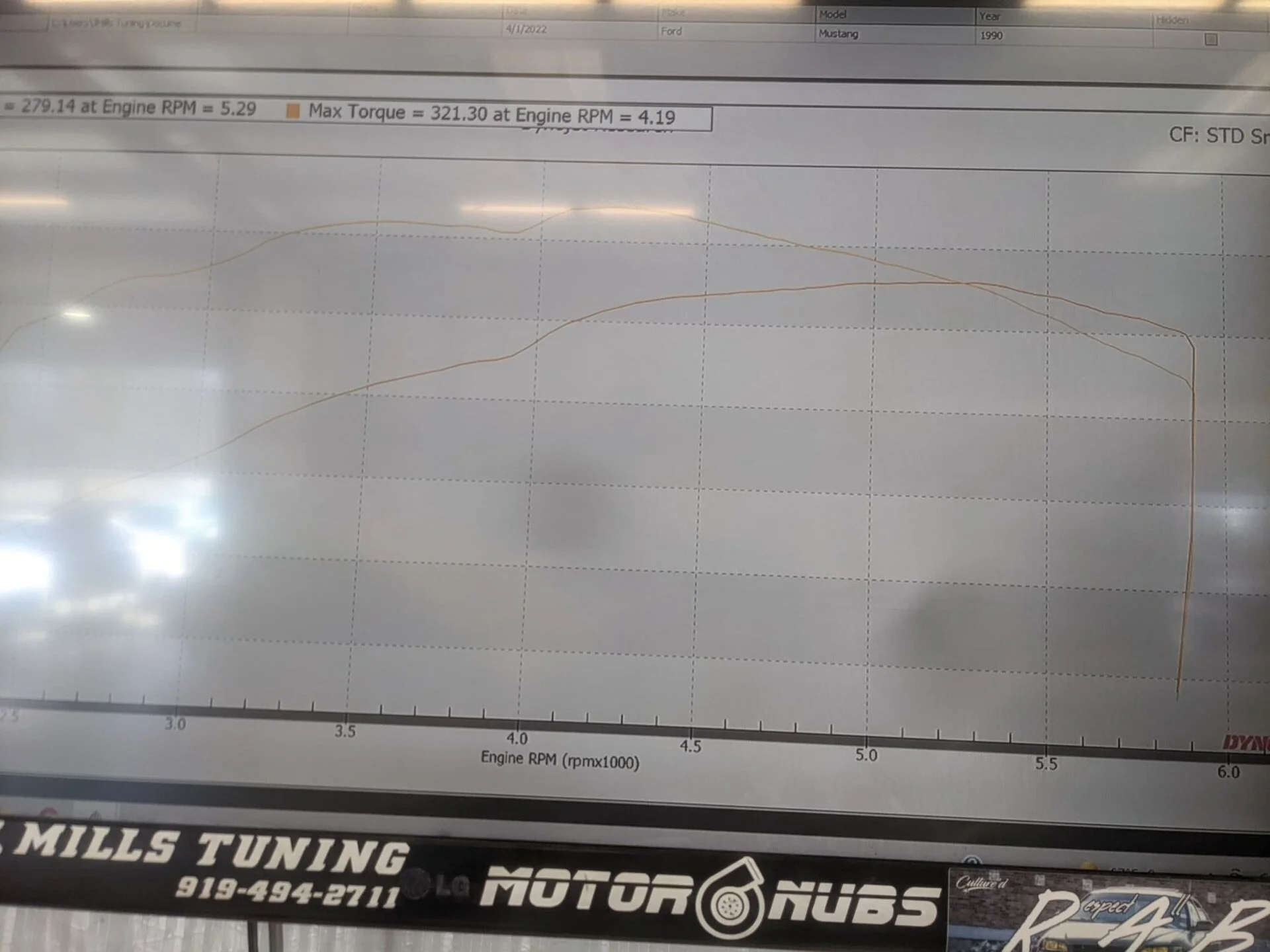

5,200 rpm stop making power on dyno

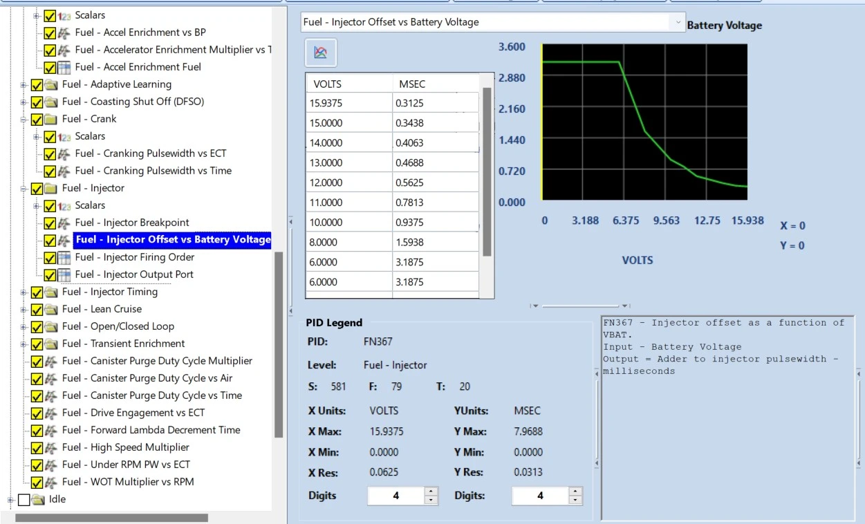

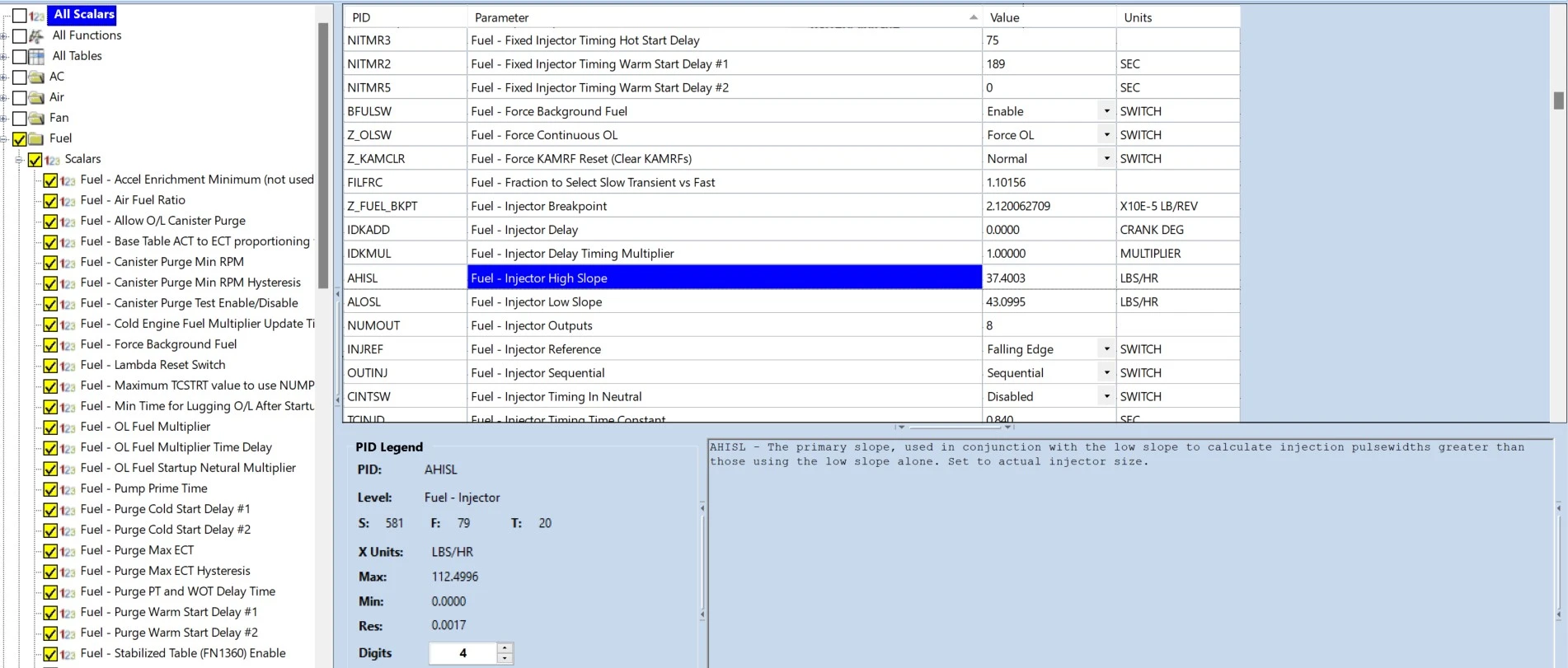

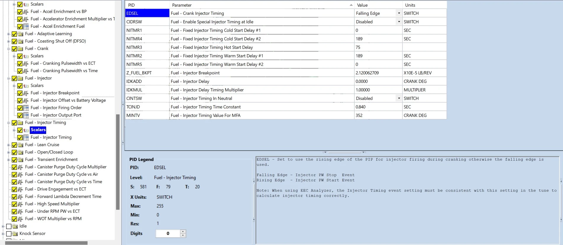

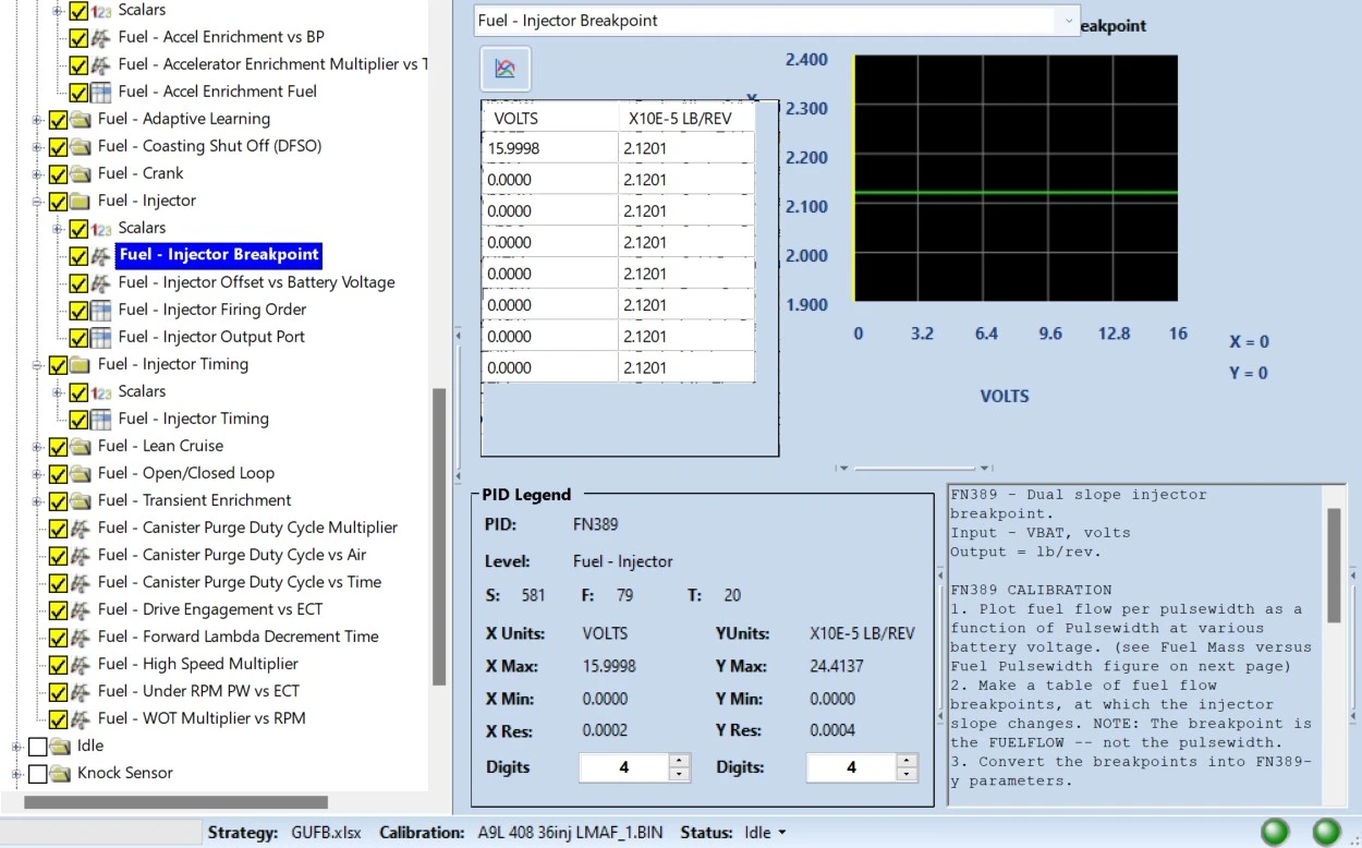

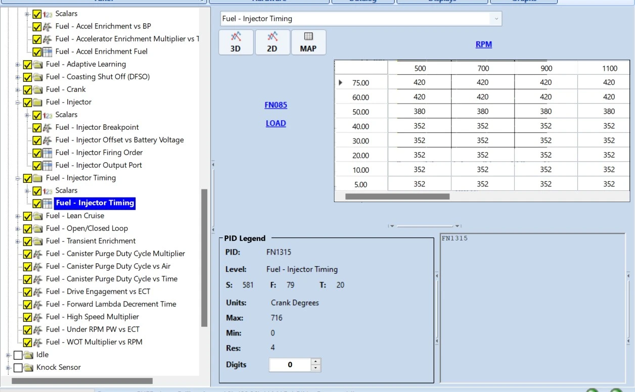

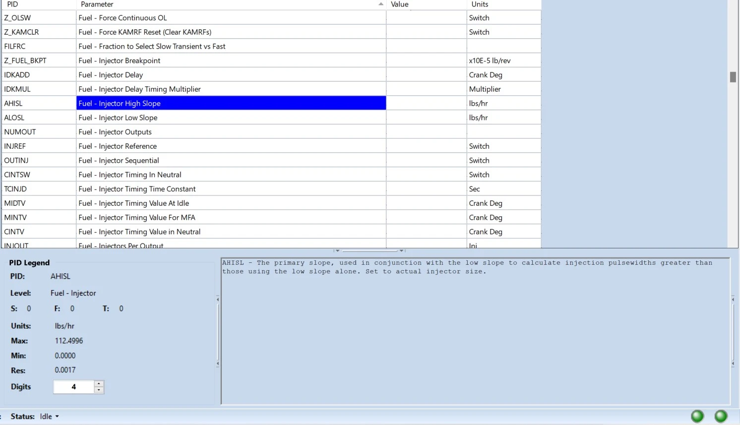

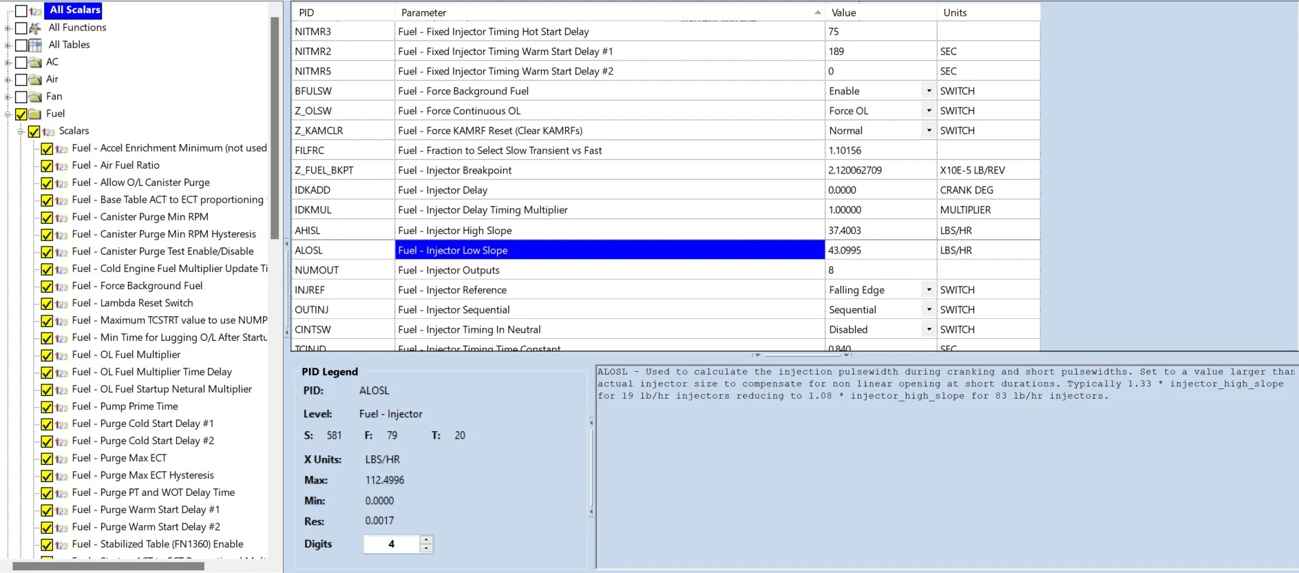

Heres some screenshots of the internals of an EEC...
Notice on the injectors its very very comprehensive especially the injector High and Low Slopes....
Injectors have very specific on an off times/etc and must be entered into the EEC correctly to worl correctly...Theres no magic into trickingthe EEC other than having the injectors youre using upgraded.......

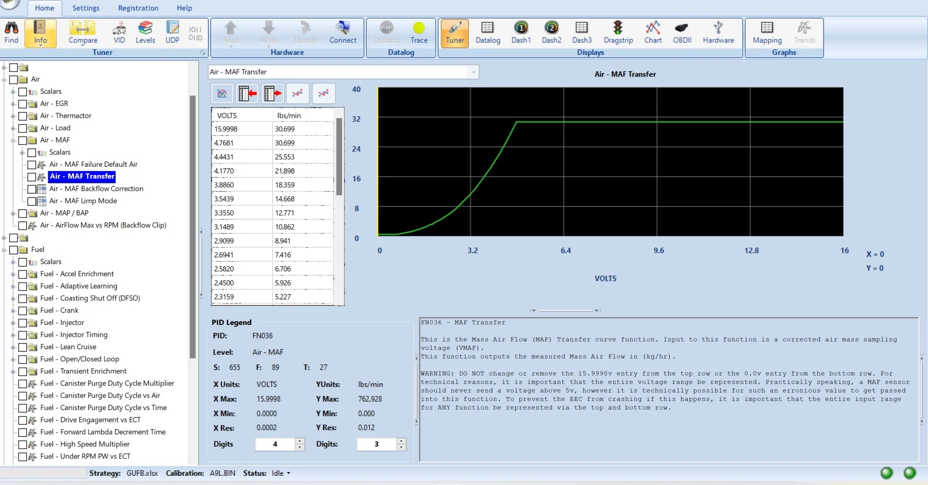

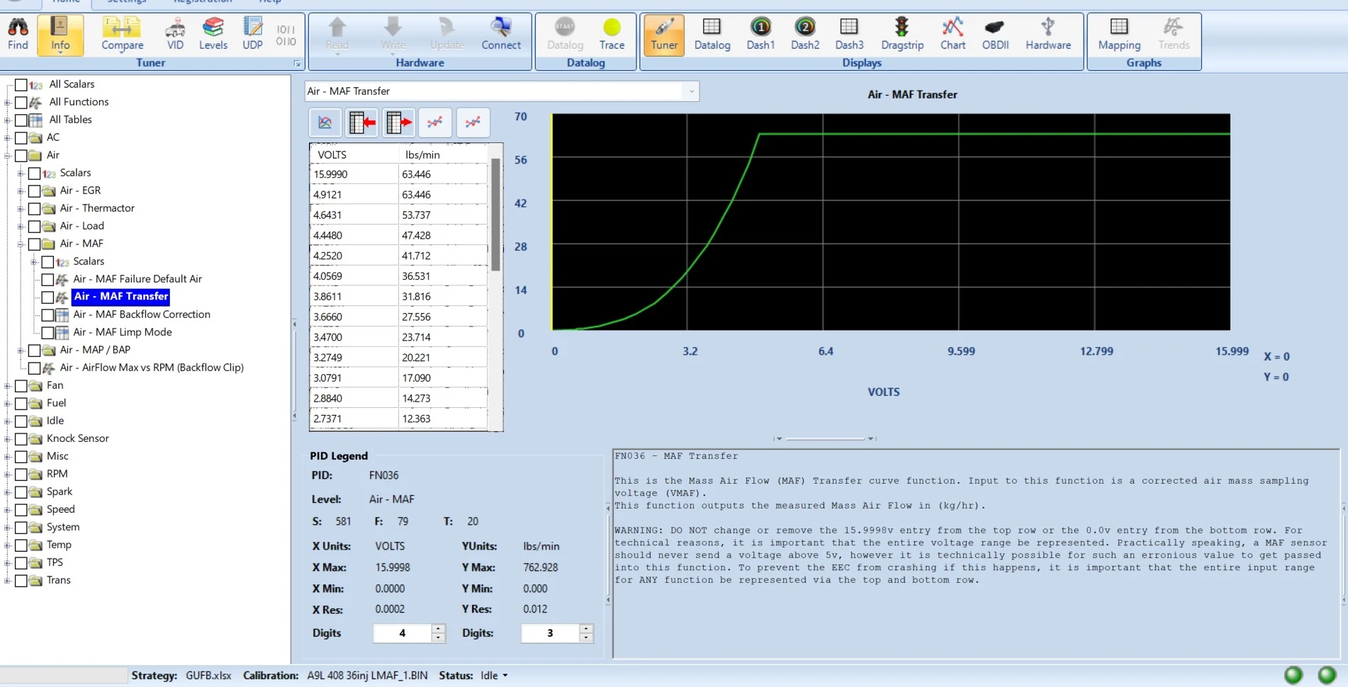

Thats just thetip of the iceberg....The MAF transfer must be fixed too...

Stops at 5200 - does it hit a brick wall and lay over ? Is it breaking up ? Are the valves floating ?
.234/.232 .555/.565 on a 112 I wouldn’t consider big . It’s decent for sure but duration is on the smaller side I’d think . How high you think it should be going ? Will it even make power there is another question
Are you sure your timing is correct, advancing etc? I had a situation where the car fell flat around 5k and i had messed up my timing. this was on megasquirt but if your balancer slipped before you timed it could be off enough.
