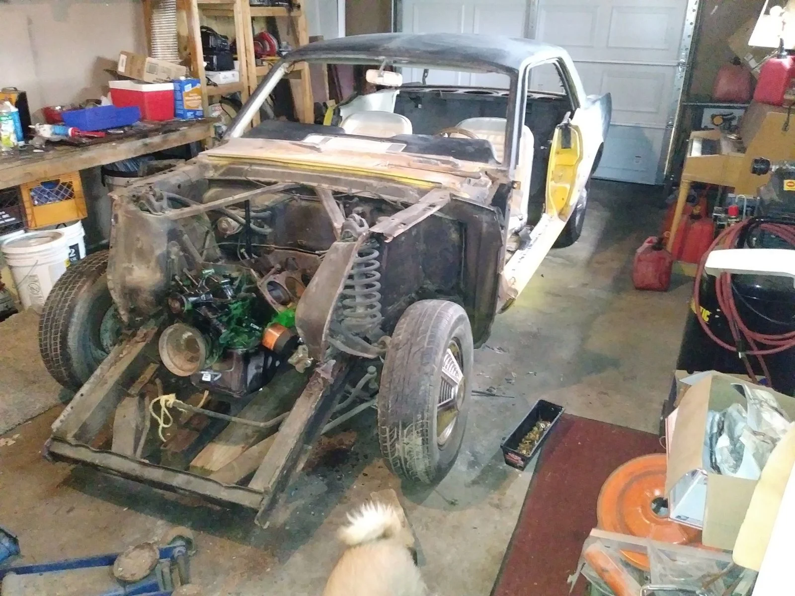

No way im gonna be able to fit a turbo'd 351 between the 65 shock towers.
Its hard to include the cost of the Mustang II into the swap because it would cost about the same to add a nice brake and suspension setup, plus i already need to do something about my super loose power steering setup.

Under $6000 for 550+ horsepower and a complete new front suspension and brake package. For now this is the route im going to plan on, but things could easily change. Order of tasks to be done on my car: complete the back half thats been started, next is the Mustang II, then it will be motor time.

ive decided to hold of on any of the engine build until after i'm done with the chassis and re-wire? its getting a mustang II regardless so i'll just go from there- and thanks to those of you who have come around and given me a lil' support
