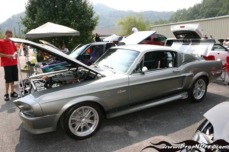

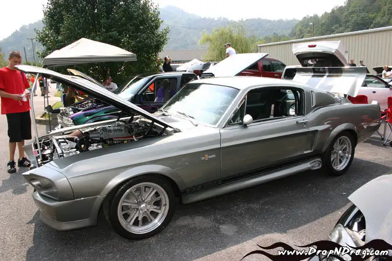

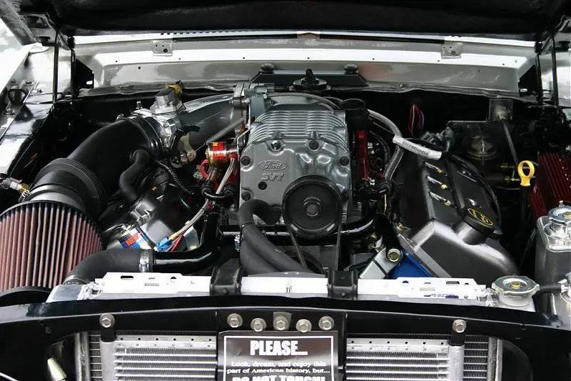

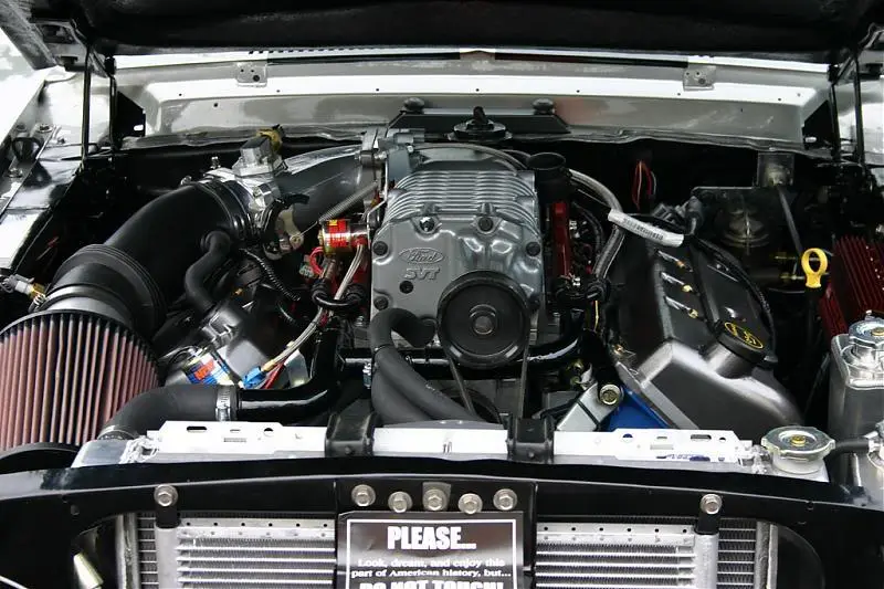

Heres my 5.4 in a 67. There is only a quater inch clearence between the hood and pulley and crossmember to the oil pan. The 69 should have more room than a 67 asnd the 65 about 2" less. I used an Accel DFI Gen 7 to run this engine, easier than fooling with the factory ecm. Have at it and keep us informed.

aftermarket harness runs about $800... you will need to pull the shocktowers, I dont think a 5.4 DOHC is going to fit. You already have to notch for a 4.6 sohc... a dohc can still be notched but most of the shocktwer will be gone with another 3/4" on each side.
