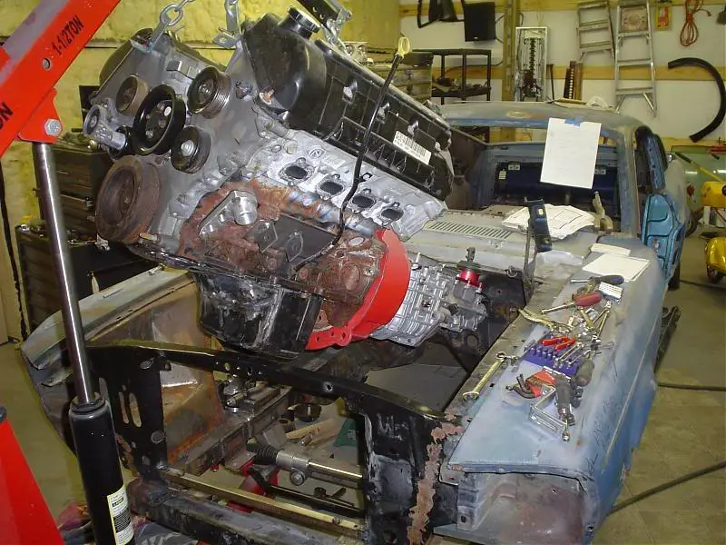

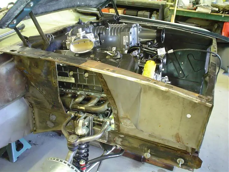

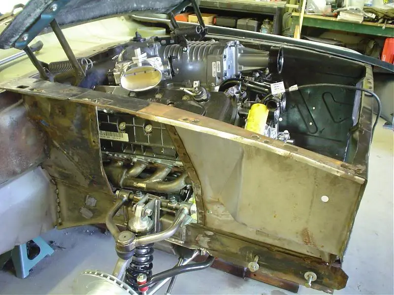

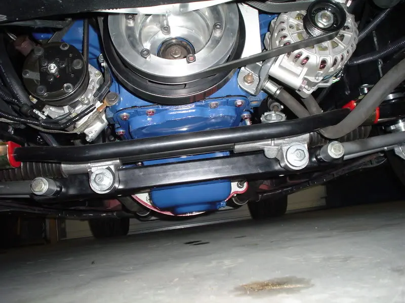

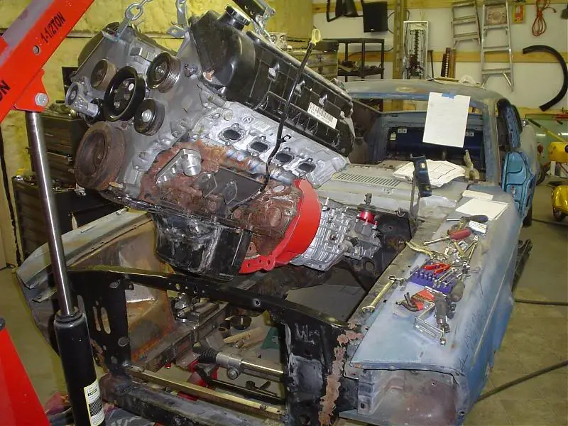

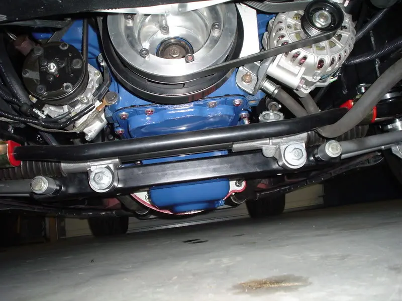

Like someone else said in this post, the height is the issue. I had to chop the oil pan as close as I could to clear the crossmember. The hood will just close. Heres a couple of other photos. I have more on my other PC if you need. I also used a manual rack as it is smaller in diameter than the power. No place for pump anyway. Alt has to be moved to clear the frame rails.
