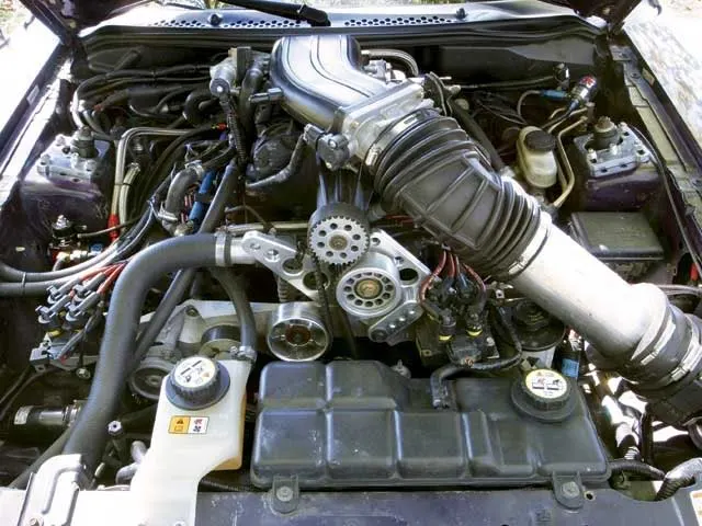

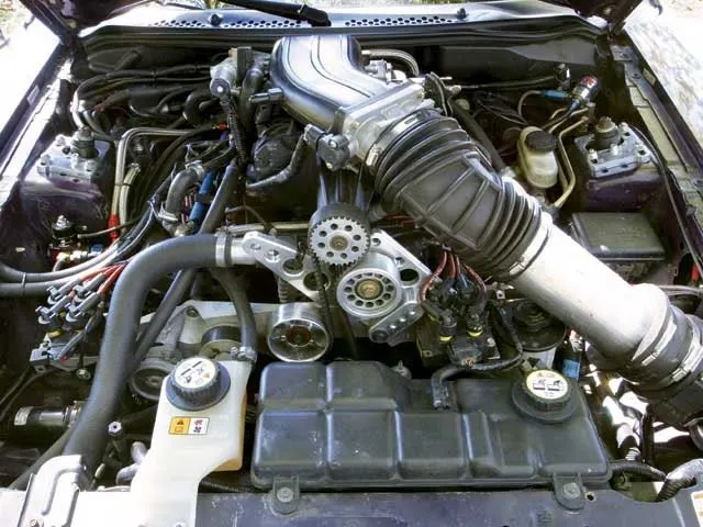

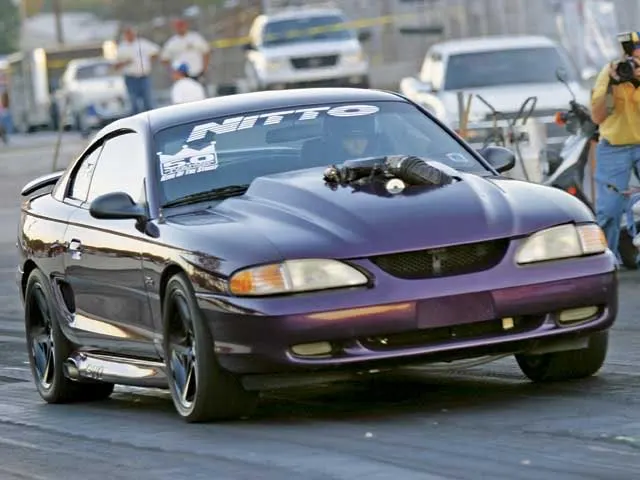

Theres a girl who used to post on here that has it in her purple 96, even with the Cobra R hood they still cut the hood open for clearance. Ran well though, it was in the KOTS (king of the streets) competition in a magazine last year and makes over 500rwhp/tq.

i have a 98 gt with a 01 lightning swap it has a vortech v1 sc and i had a custom intake made but it fits under a 2 in cowl hood the swap isnt as bad as everone says mounts r same as 4.6 and harness is similar
that purple one looks sick as f**k with the black Saleen's on it. I would never atempt that kind of swap though. Im sure it would be a lot easier to do a terminator swap. Plus, isnt that engine a hell of a lot hevier than a terminator motor:shrug: Probubly wouldn't handle worth a s**t
