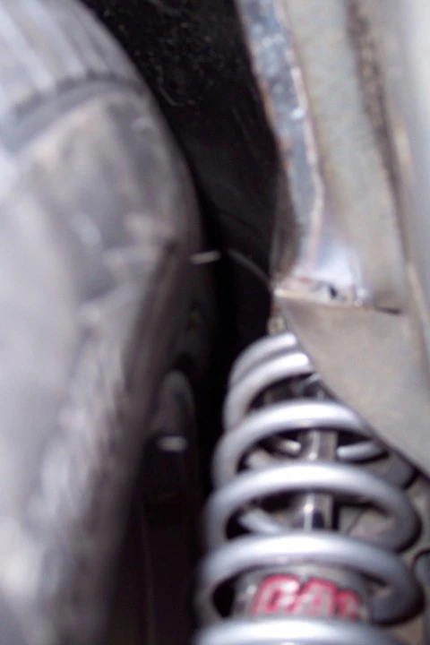

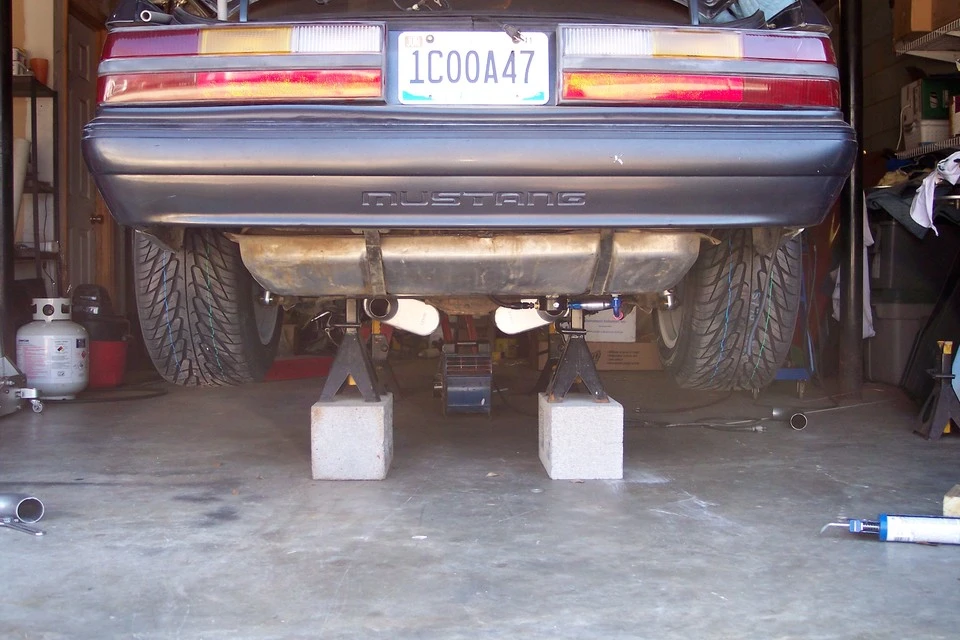

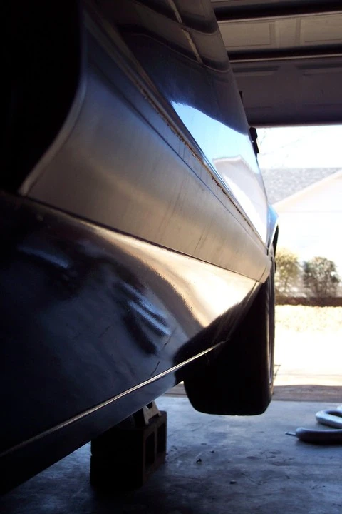

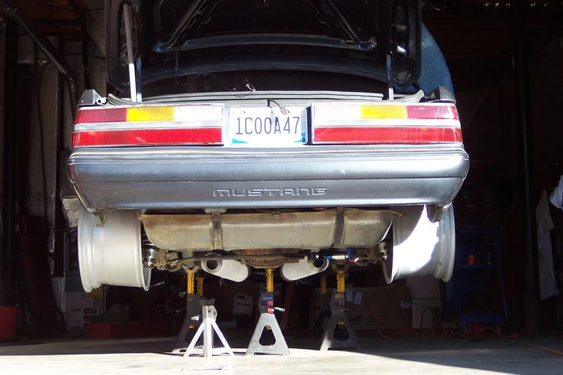

While I kept the stock lower mounting points, I have my coilover upper mount points moved inboard along w/ the wheel tub. So unfortunately, you'll have to consult somebody else on the interference issues between them if you go as far inboard as you can.
Again, my wheels are 7.2" B/S w/o any spacers.
What tha.....how old is this picture?.....Are those Fox tailights on my car?
I think I threw those things away.
They don't stick out even a "tad bit"
I couldn't see to take this, I just stuck the camera up and pressed the button. So don't bitch about the blurry pic.
