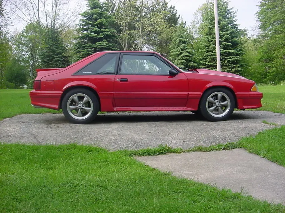

5-Lug, 10th anniversary wheels, and a fox body chassis
I hope this helps someone when I put these on they rubbed on the inside a little in a hard turn
but then I changed over to 1994 axles for disc brakes everything cleared. The fronts rub when turned all the way. (last 1/6 turn) But keep in mind the tires are huge 235-55-17 I'm not sure of the back spacing but it should be easy to find this is a stock mustang wheel very popular wheel 17x8 one more inch would fit on the outside with a fender roll easy
