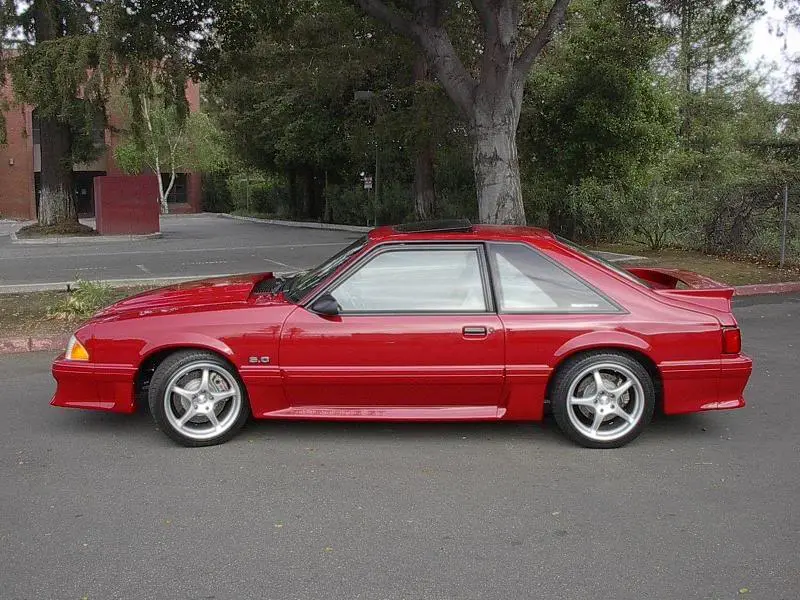

Backspacing is 5.95 according to Steeda, but they didn't know if anyone was using them with my setup. As tunedin302 stated the question really is about the front snout and cap. Does anyone have any pict of a FOX with steeda ultra lites
The wheels I have are the SSR wheels which Steeda copied to make there Ultra-Lite wheel with so the wheels look identical, with the exception that the Steeda Ultra-Lite wheels are just slightly a darker silver than the SSR wheels.
Hopefully these pics give you a good idea of how the Steeda Ultra-Lite 17X9 wheel looks on a fox.

Thanks for the pict Almoststock!!! The wheels look great and since your car is the same color as mine or close to that helps my purchase dicesion even more. I don't suppose you know if they would fit with my brake setup. I looked at your site and you have the brembos, I don't know how different those are than my setup. Thanks again!!:D
