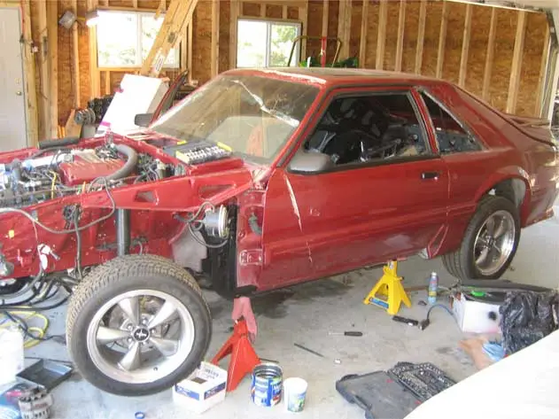

Don't buy that kit, that's just a rip off. All they're selling you is what you could get at your local parts dealer/junkyard for half the price.
All that is is:
two driver axels out a 83-92 ranger, drums for it too
and
Pair of rotors for a late 80's mark VII
Go to a wrecker, get the axels, then buy new brake parts. And with the money you saved, pick up a set of late 80's lincoln calipers, they're 73mm, replace your stock 60mm ones. Cost me $30 for the calipers (cheap as a mofu) and roughly $125 for everything else involved in the conversion + $30 for wheel spacers & $50 for lugs because I put bullits on it.
Came out nicely for a $125 deal i must say...
not sure if they'll fit saleens or not...

that does look pretty good, thanks for the info!

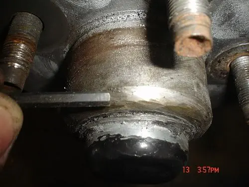

To fit saleens you will have to grind down a bit of the rotor - essentially the outer edge where the dust cap fits. This is needed to allow the wheel to sit flat. You will also have to remove or flatten the dust cap in order to run the saleen center cap. Good luck.

I agree about not wanting to grind to make it fit but it is only a small lip on the hat of the rotor that needs to be modified. This is all it takes:
Easiest ways to make the Saleens fit are either the baer kit or the sn95 spindles or both
