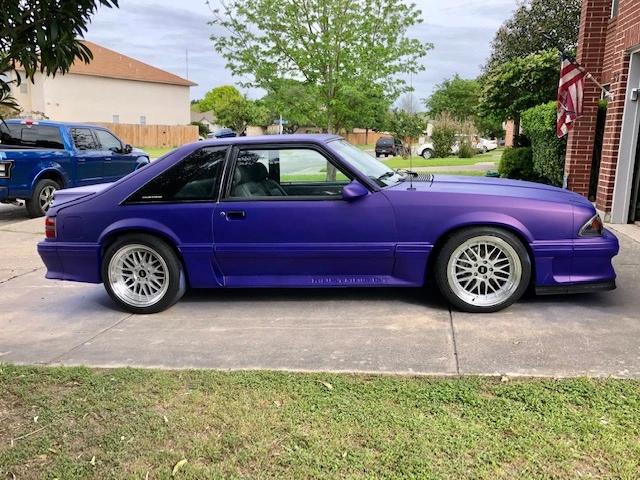

The Valencia is very similar to the SVE Series 1 or 3 wheels LMR has. I have the 18x9 & 10" series 1 on my car without any issues. I used 95GT spindles, 99GT calipers, and Yukon axles with Ranger drums.
285/35/18 rear and 265/35/18 front.
The rear wheels wouldn't fit with the factory exhaust pipes, so I had to cut them off. Aftermarket exhaust, that you can loosen and move around might be a different story. I also had preemptively removed the quad shocks. Not sure if I actually needed to do that or not. On the front I just had to give the fenders a few love taps with a hammer on the top of the arch. Not much at all, and only on the driver side.
@africansnowowl - appreciate the feedback! what size tires are/were you running on those wheels?
@nickyb - looks nice! i am going for that chrome look to compliment my black GT.

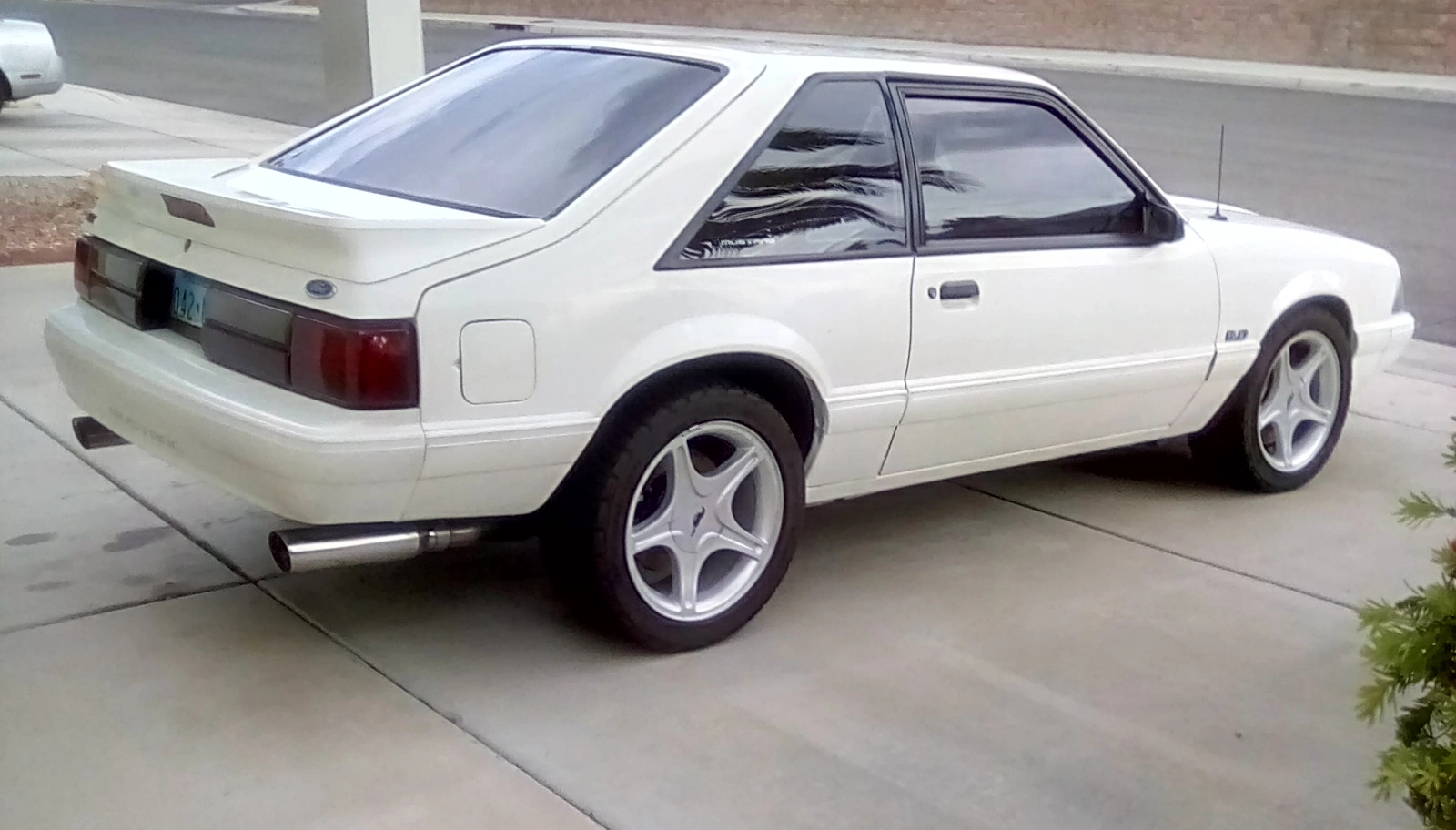

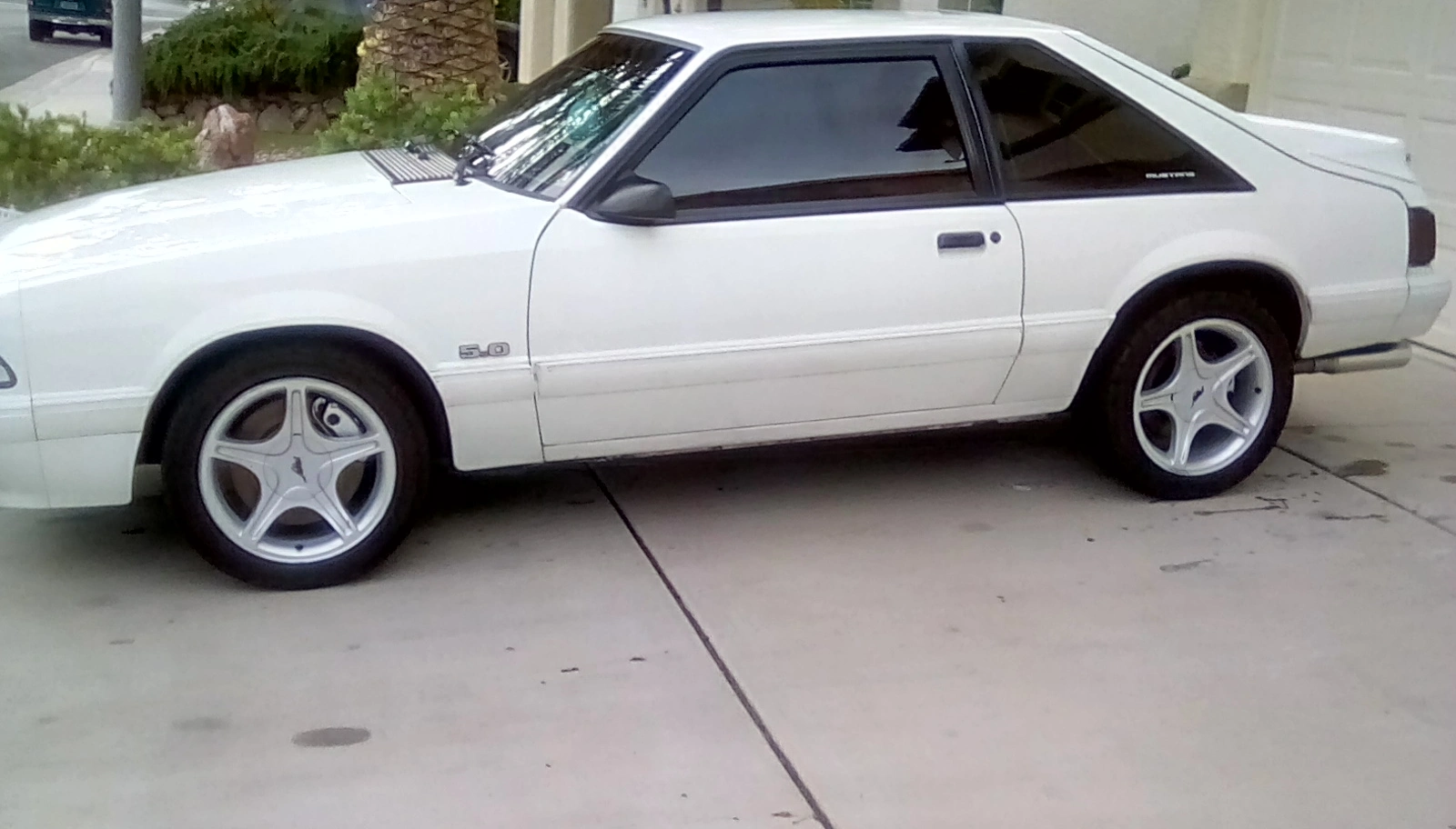

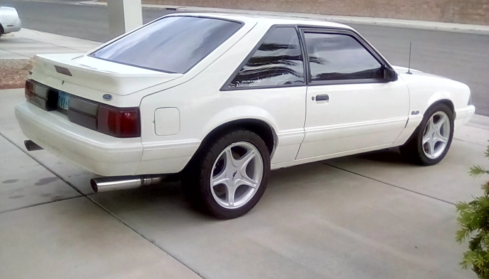

95 spindles,Fox length five lug 11.65 rotor centric ( lmr) I be live Moser street axle,245\45.17 inch
I have no issues rubbing. Don't know if 40 will fit outback, as I have 3 inch tailpipe and no room to spare.
