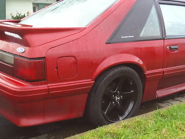

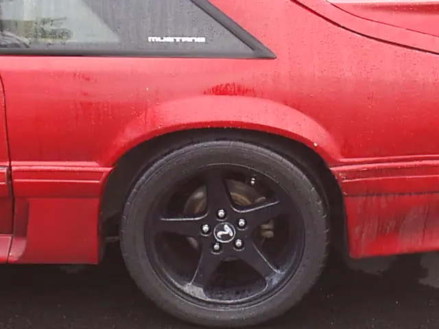

i used sn95 axle w/17x8 wheels and with 255's it brings the tire right to the fender....
