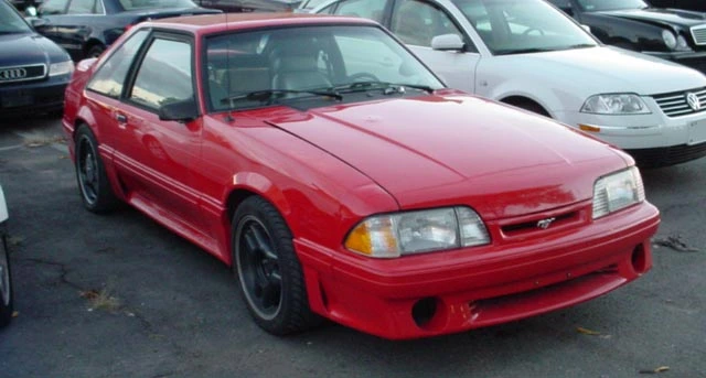

I like tri-bars!! Lincoln rotors onthis one.

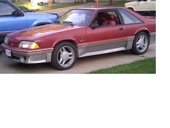

good choice on wheels, will be interesting to see what they look like on a teal/green car.
here is the best pic i can find of what my car USED to look like before i went to wider wheels.
