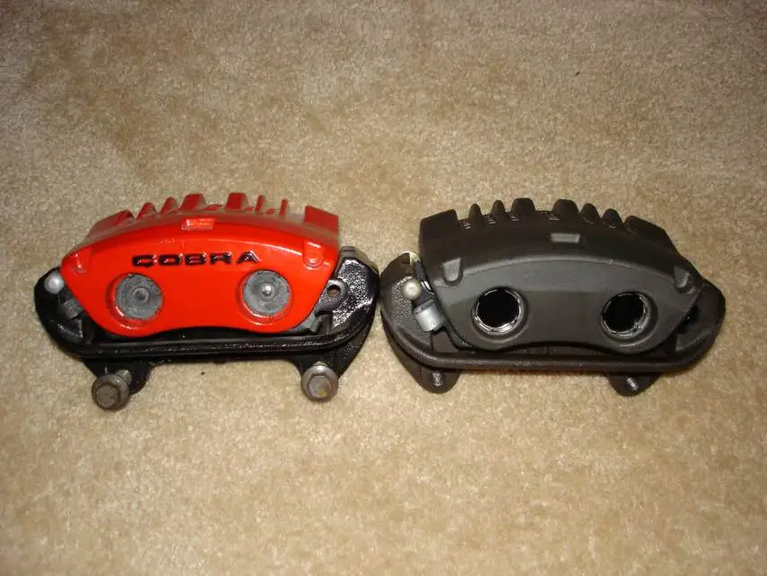

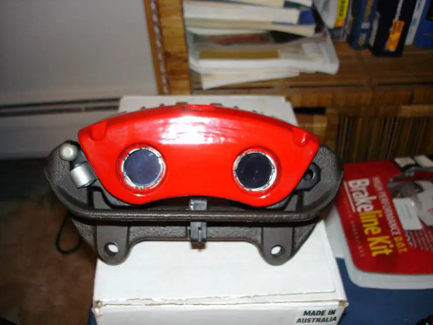

90mustang_GT5.0 said:
mine brakes are black tho, what would i go about doing to make them red like yours ? i mean what type of paint would use to make the black red?
It's not that hard, but you'll need to take off the caliper. It's gonna be tough as hell to do on the car.
The CObra caliper I did with VHT spray caliper paint. I did a few coats in red, let it dry and then used a small brush to paint the COBRA in black. Other guys tape the COBRA lettering very carefully and then paint the caliper and peel the paint off.
The Mach 1 calipers i did using the Duplicolor brush on paint. It worked pretty well and was easy since the Mach 1 caliper lacks any wording.
They look a little orange due to the camera. They are red
