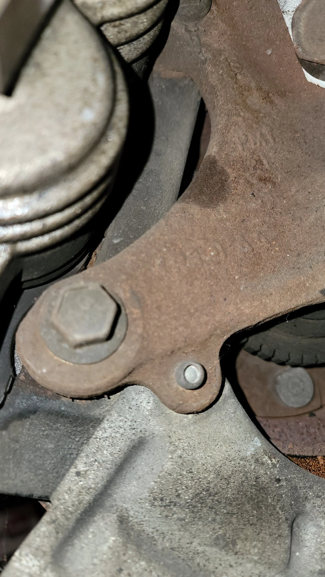

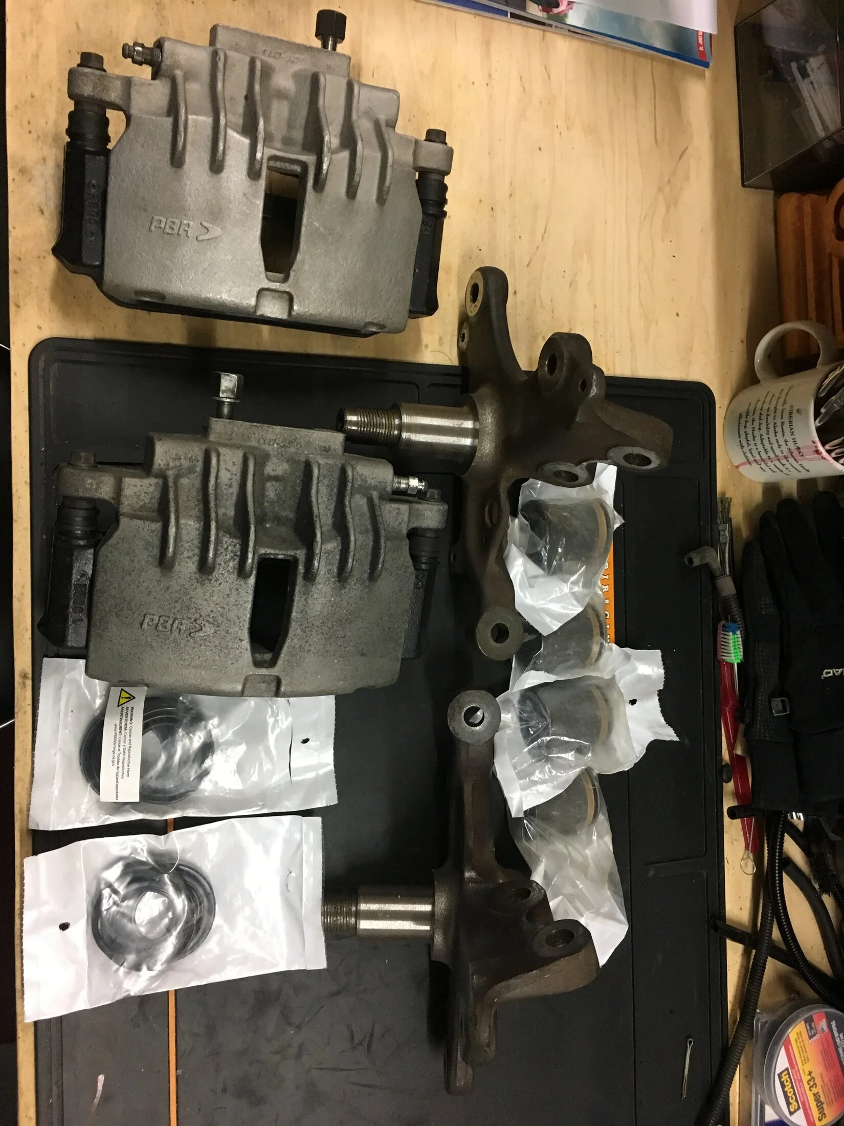

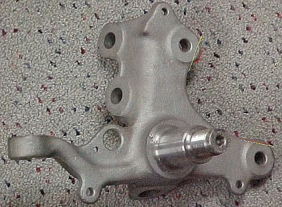

The front calipers look like the 99-04 PBR units. Easy way to tell is pull one and look for the grinder marks on the spindles that are required for clearance to install those calipers on the 94-98 spindles. This picture shows where it will be ground.
The 99-04 spindles can be used on a Fox but they push the front wheels out a bit more than the 94/95 and 96-98 spindles.

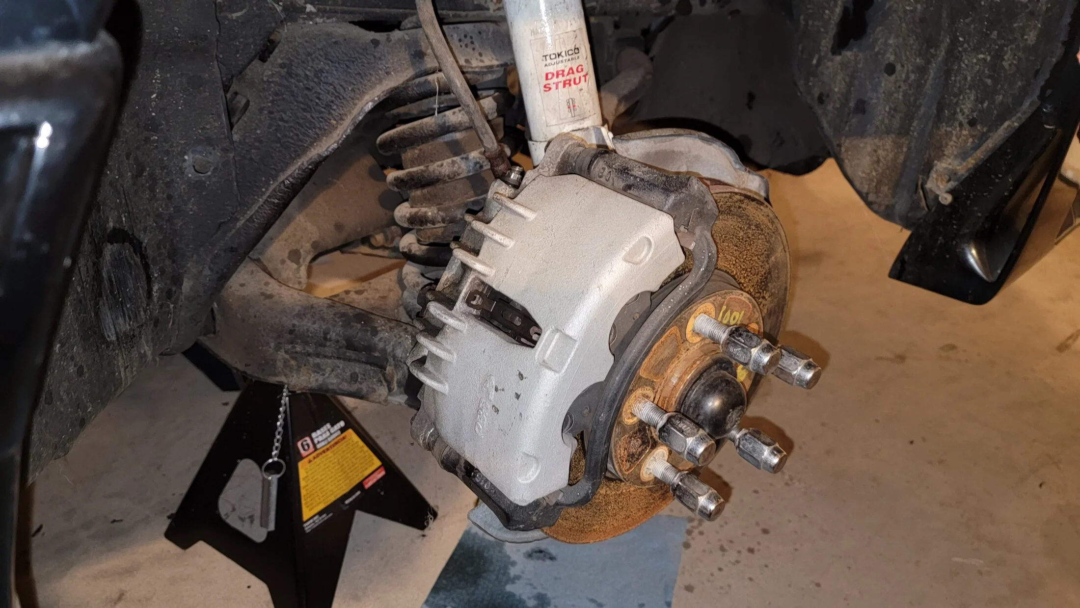

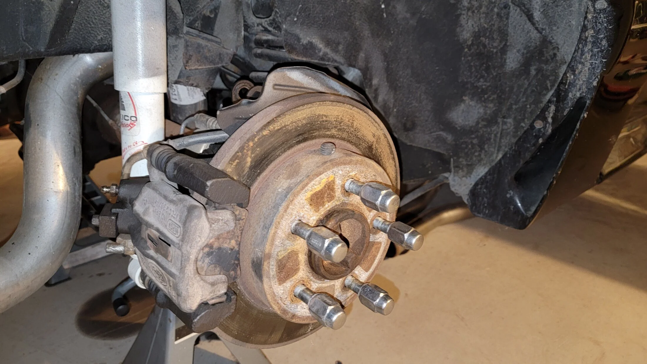

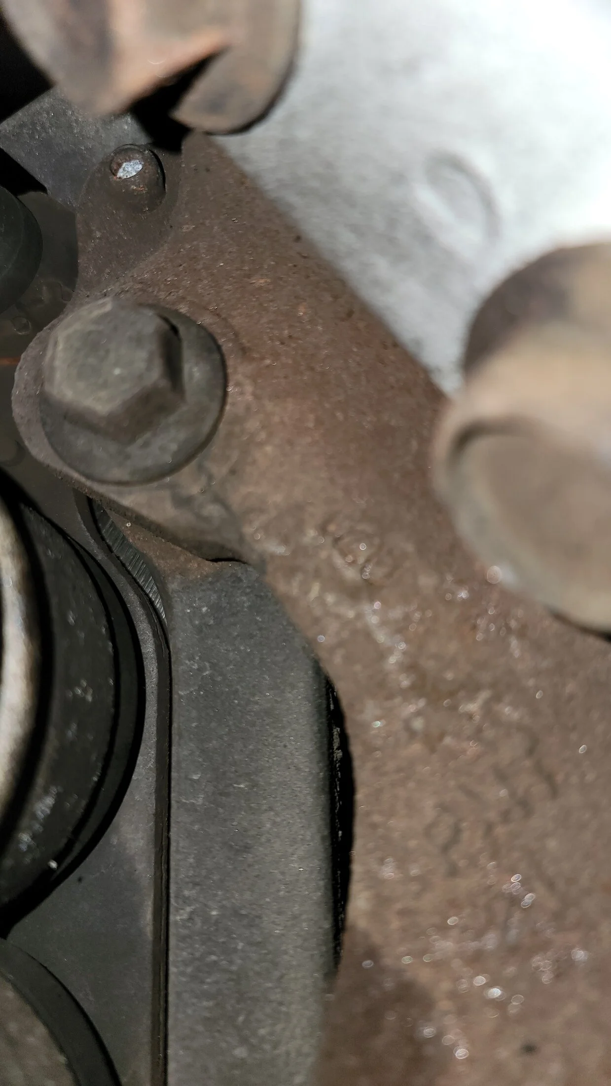

The front calipers do say PBR right on them.. would this complicate how I buy replacement parts? You nailed it too lol
As said, those are 99-04 GT/V6 calipers and rotors. Cant tell the brake lines from that angle.
Rear setup is standard 94-04 GT/V6 rear brakes as well.
The part number on the spindle indicates those are 96-04 spindles.
It’s a decent brake setup. Good stopping power and fits in smaller rims. Downside is the front calipers are notorious for dragging/sticking.

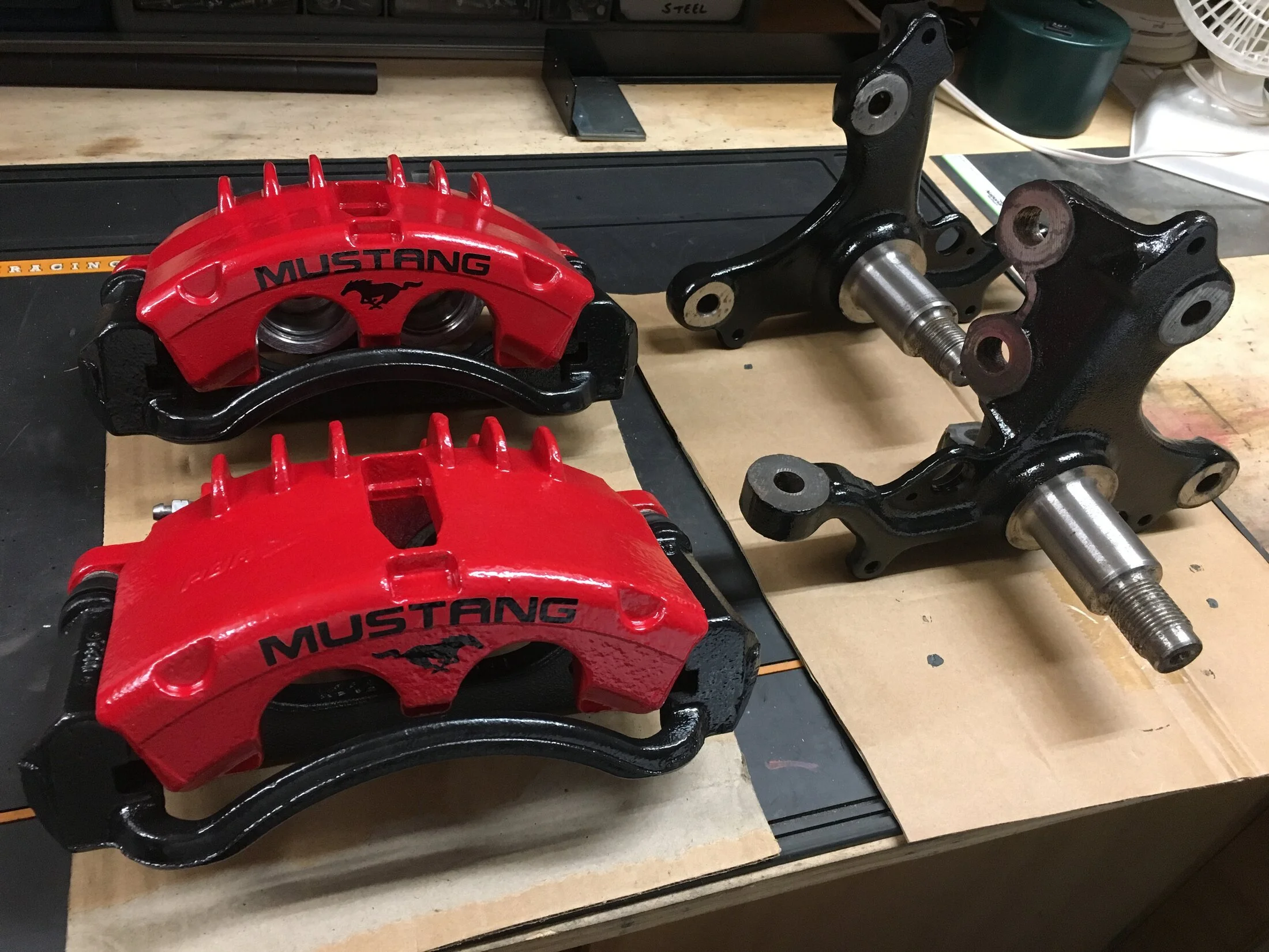

Not to sway you from going Cobras……. But I took an eBay set of calipers from old and warn, to like new with a full rebuild. The boots for the pistons are the trickiest part. A few thousand miles on them, and very happy so far. Rears got same treatment as well.
Ran 99 PBR’s for a couple years with Hawk pads with zero issues. Lots of folks made this swap as they are far superior to the single piston 94-98 V6/GT caliper.

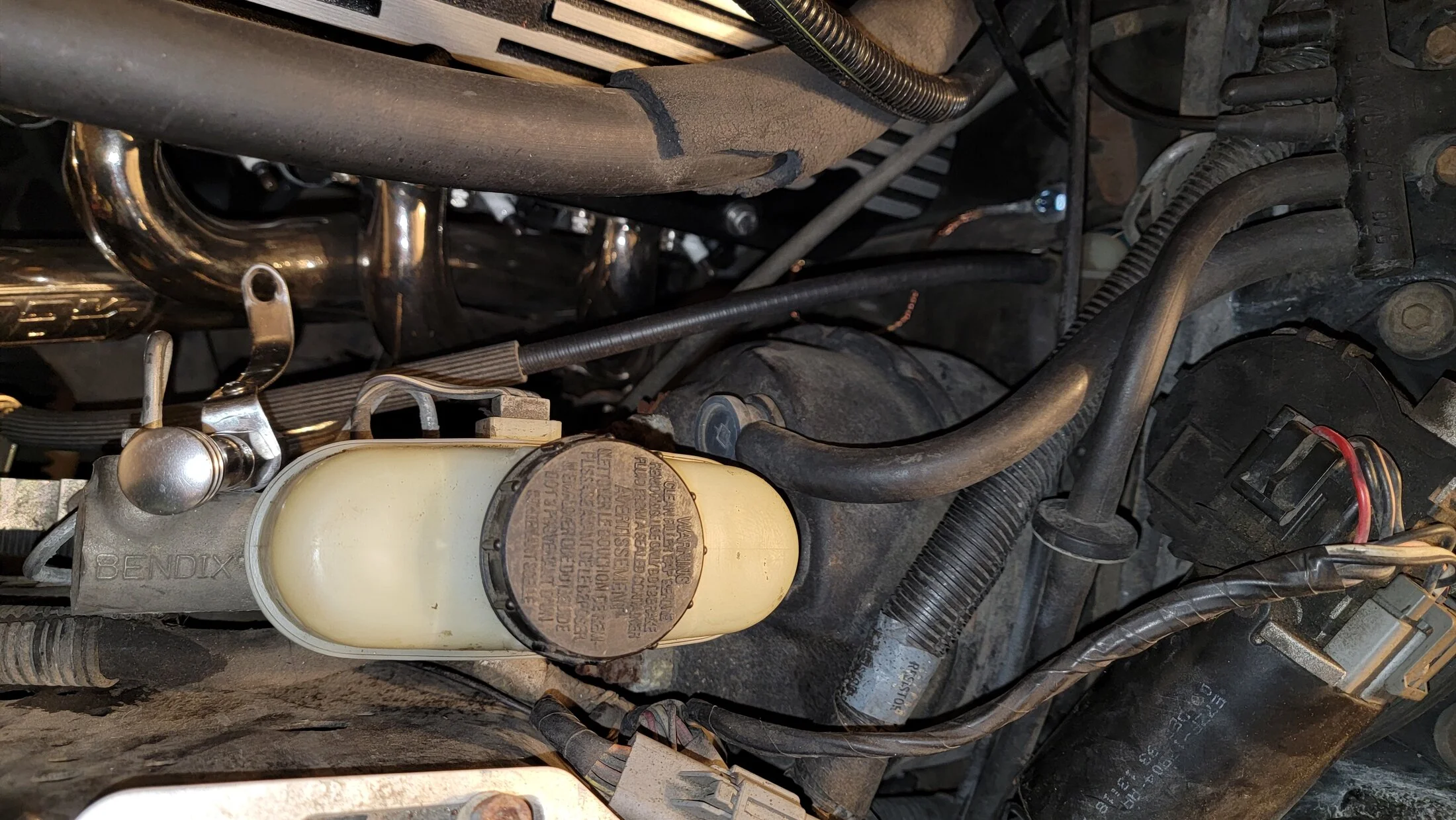

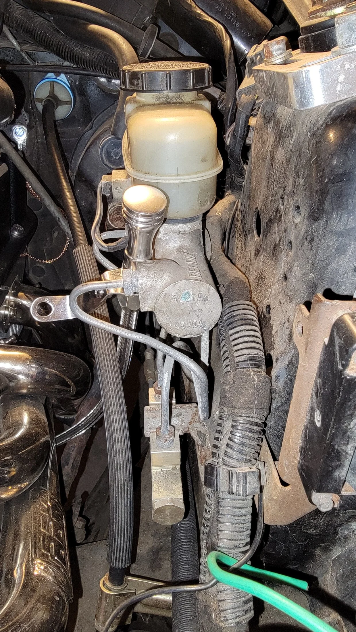

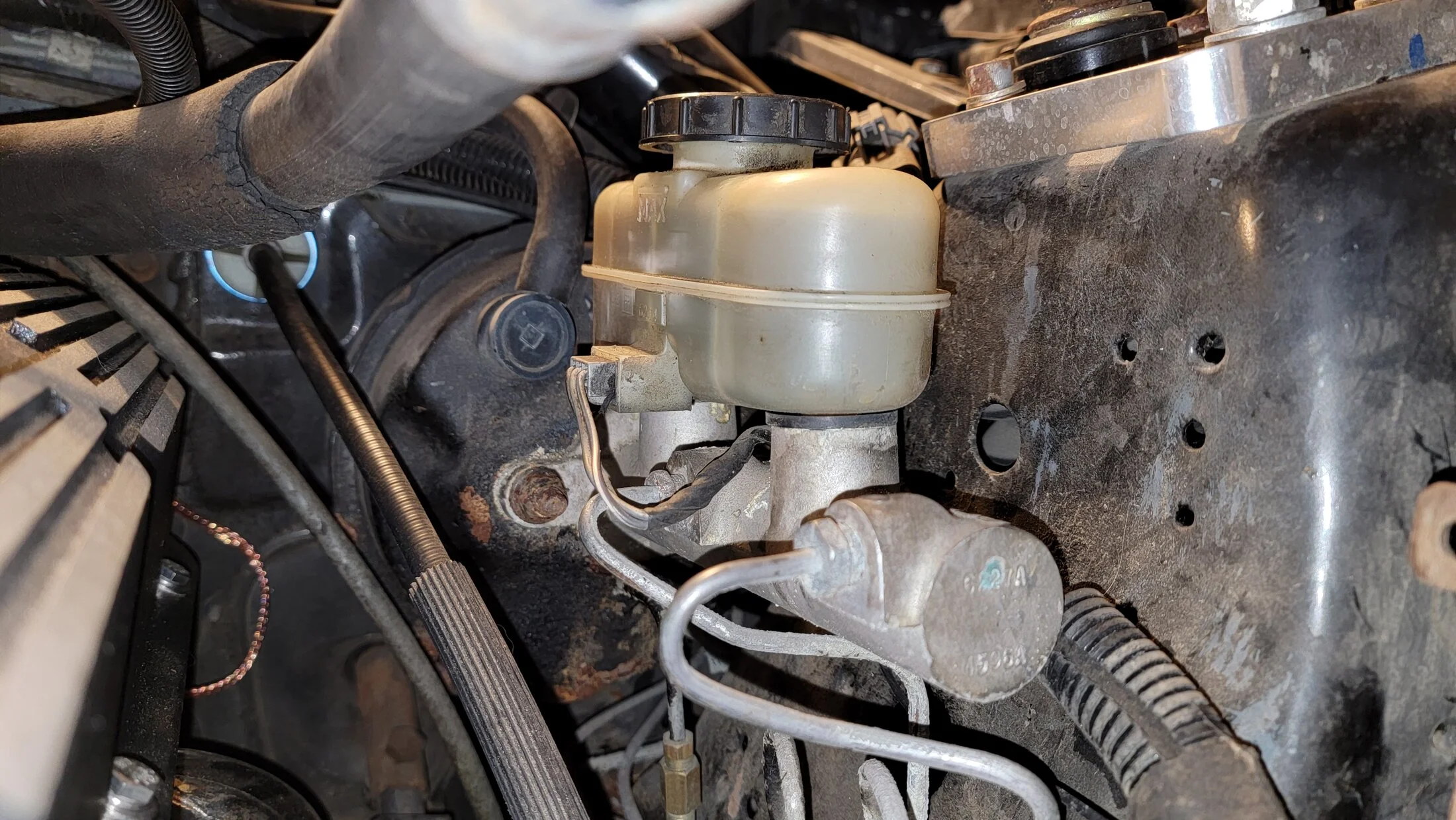

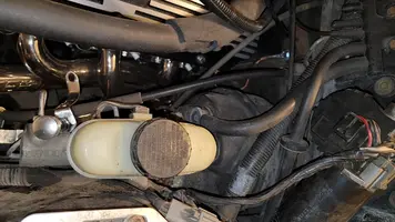

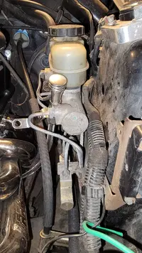

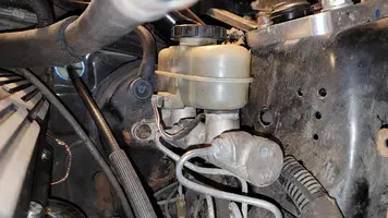

Sorry for the delay, here's some pics of the master.
