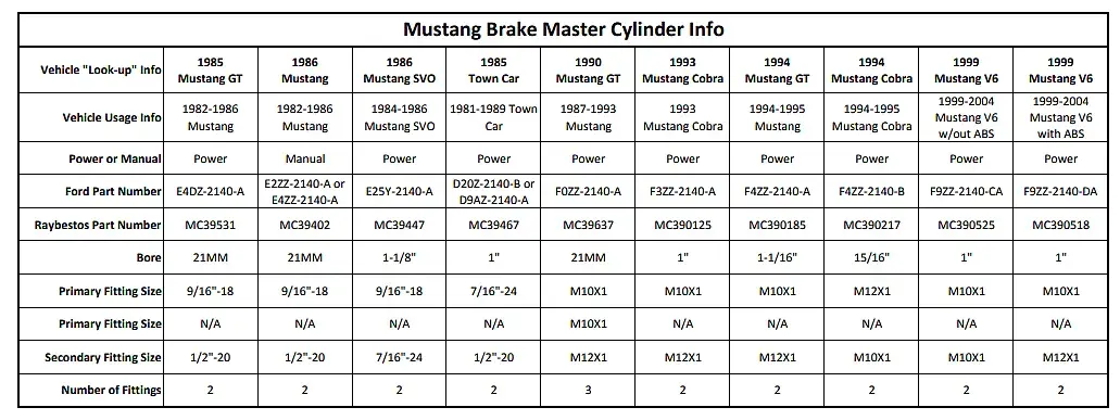

From the pic, it looks like the front fitting (rear brakes) is larger than the rear fitting (front brakes). So front is likely an M12 fitting and rear is M10. You can se in the chart below the potential MC's. 1987+ cars use metric fittings.

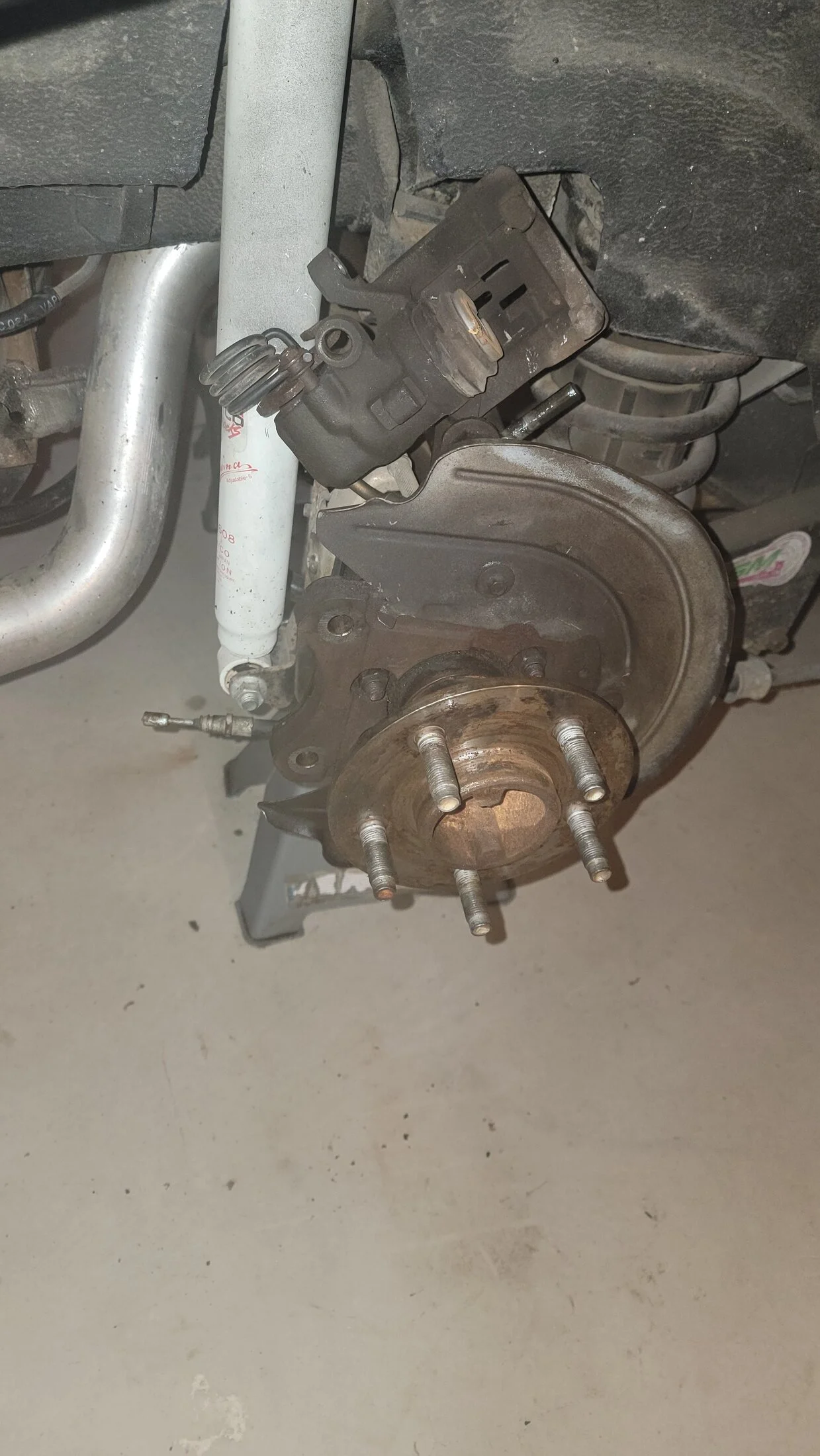

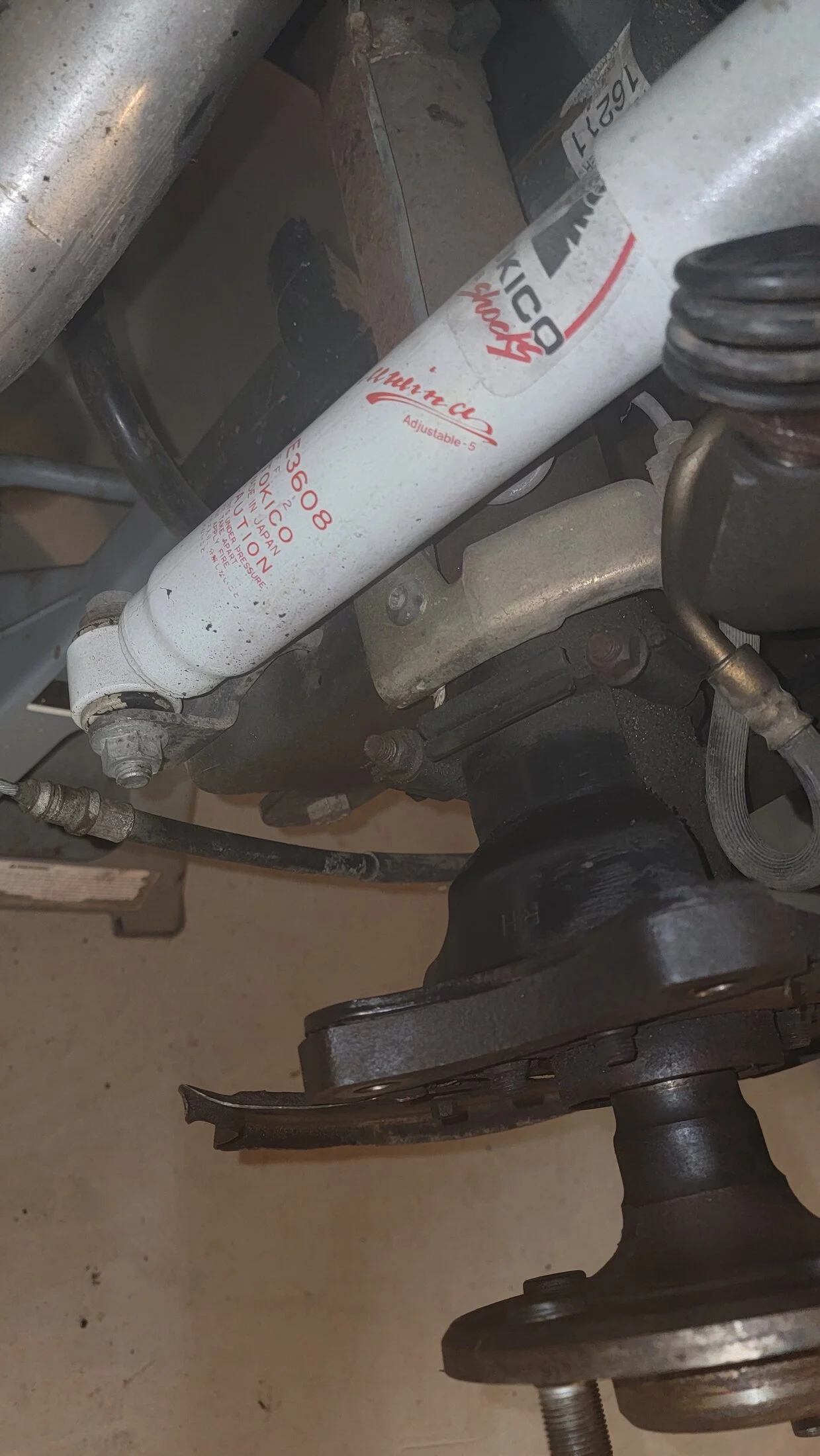

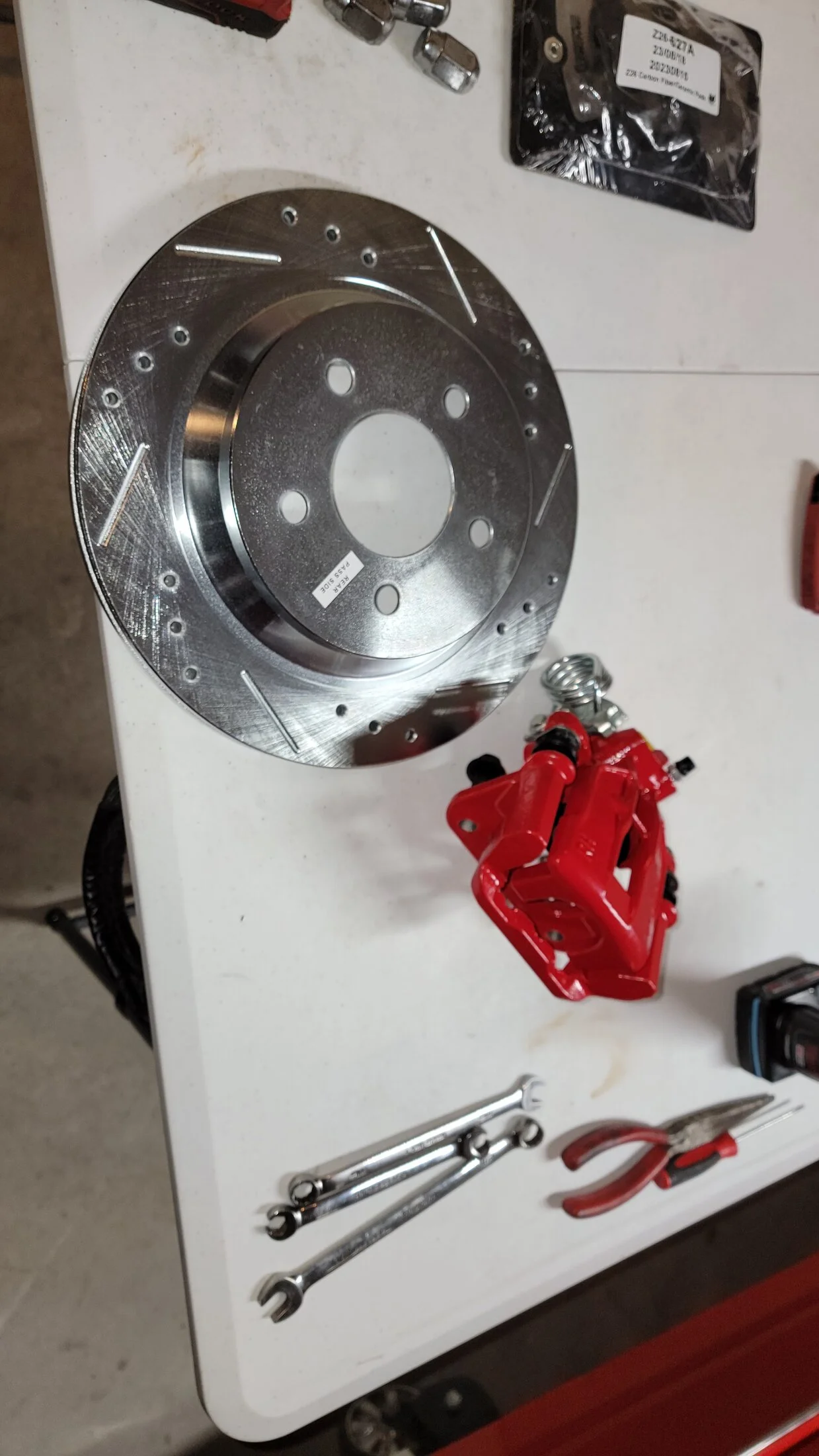

Ok guys, I ran into a hiccup with the rears. The brackets are a little too small and I've found out there is a cobra specific bracket.. no problem, but I can't figure out which one I need. LMR says the thick one that looks very similar to what I have now is not for a foxbody. And the other one they sell doesn't look anything like what I have.. I honestly don't know if this rear end was out of an SN95 or if it was converted. Can you guys point me in the right direction please? I've attached some pictures. Thanks!
The rears are standard 94-04 GT/V6 rear brackets and calipers and rotors with 94-98 SN95 axles. Everything I see in the pic is factory GT stuff.

Cobra rear rotors are vented and 11.65” in diameter and the V6/GT’s are solid and 10.5” in diameter.
The calipers are the same however the axle brackets are different which you are noting above. The caliper brackets are different as well. The difference can be seen here:
I sourced the caliper brackets from Autozone. Not sure if they carry them anymore or not.

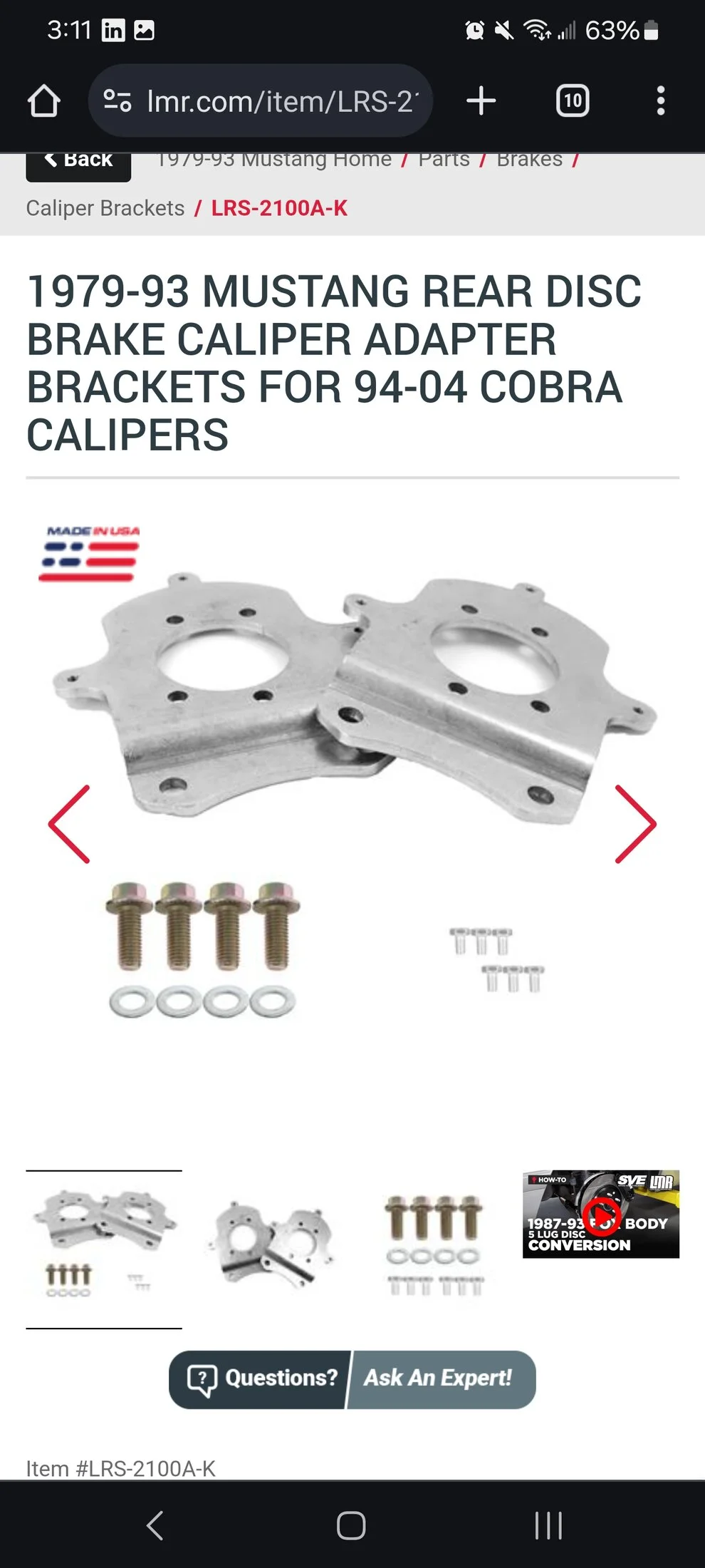

I bought the front and rear kits from LMR if anyone needs to find them.. I'm just stuck on which bracket kit to order. The thin bent ones don't look right to me, but why would they say the thicker ones are not for a foxbody? They look like what I have already. The rotor and caliper lines right up but the mounting holes just need to further out in space to accommodate the rotor. I'm sure I'm over thinking everything lol
