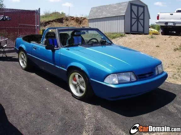

i did a quick chop that doesn't look so hot of what my car will look like...minus the cage...by spring.

I know you went with the black interior but that color would look badass with the white leather interior.
i agree BUT did you ever see what my interior looked like before? it was 100% blue...faded and beyond being able to be brought back without re dyeing the same color...and ive always wanted a black interior so this gave me a reason.
