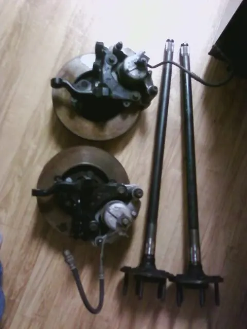

i picked them up today...
here's a camera phone quality pic of the axles and fronts.
so now just down to the breeze automotive rear rotors and i'm set for parts.
