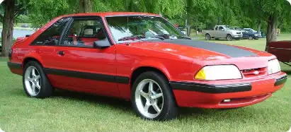

i have all of the parts to do the front but what year rangers and aerostars have the axles that i need ??????? just wonderin i have a set of 5 lug 17's that would look good on the car n now im gettin around to doing it any help greatly appreciated

They'll fit...mine has 245/50r17 on ROH Snyper rims with stock springs.
The only rubbing I had was lock to lock,and that was barely..
I've had the car loaded..3 people with luggage on road trips and had
no clearance issues.
It's amazing what can be found by using the search. I will concede that this came from the 5.0 forum, but it's been covered so many times that something surely would come up in a site-wide search.
-Ranger/Bronco II: I4/v6 2.3, 2.8, 2.9L (83-92) 2x Driver-side Axles 29 5/32” long,
(Do not use 4.0L parts)
-Aerostar (86-97) 2x Passenger-side Axles
