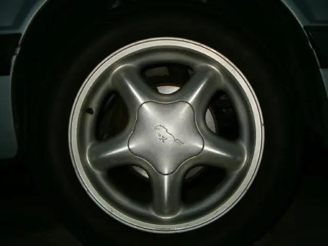

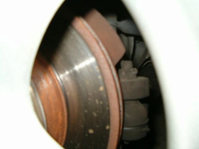

Here's a couple of pictures of the final product. They were a month or so after the job was done. They both show how much larger the Ranger rotor is in comparison to the Mustang rotor. See the rust ring on the braking surface around the outer circumference? There's your difference.
It may not rub when you bolt it all together and spin it. Mine didn't make a noise at all until it I got on the brakes going home.
