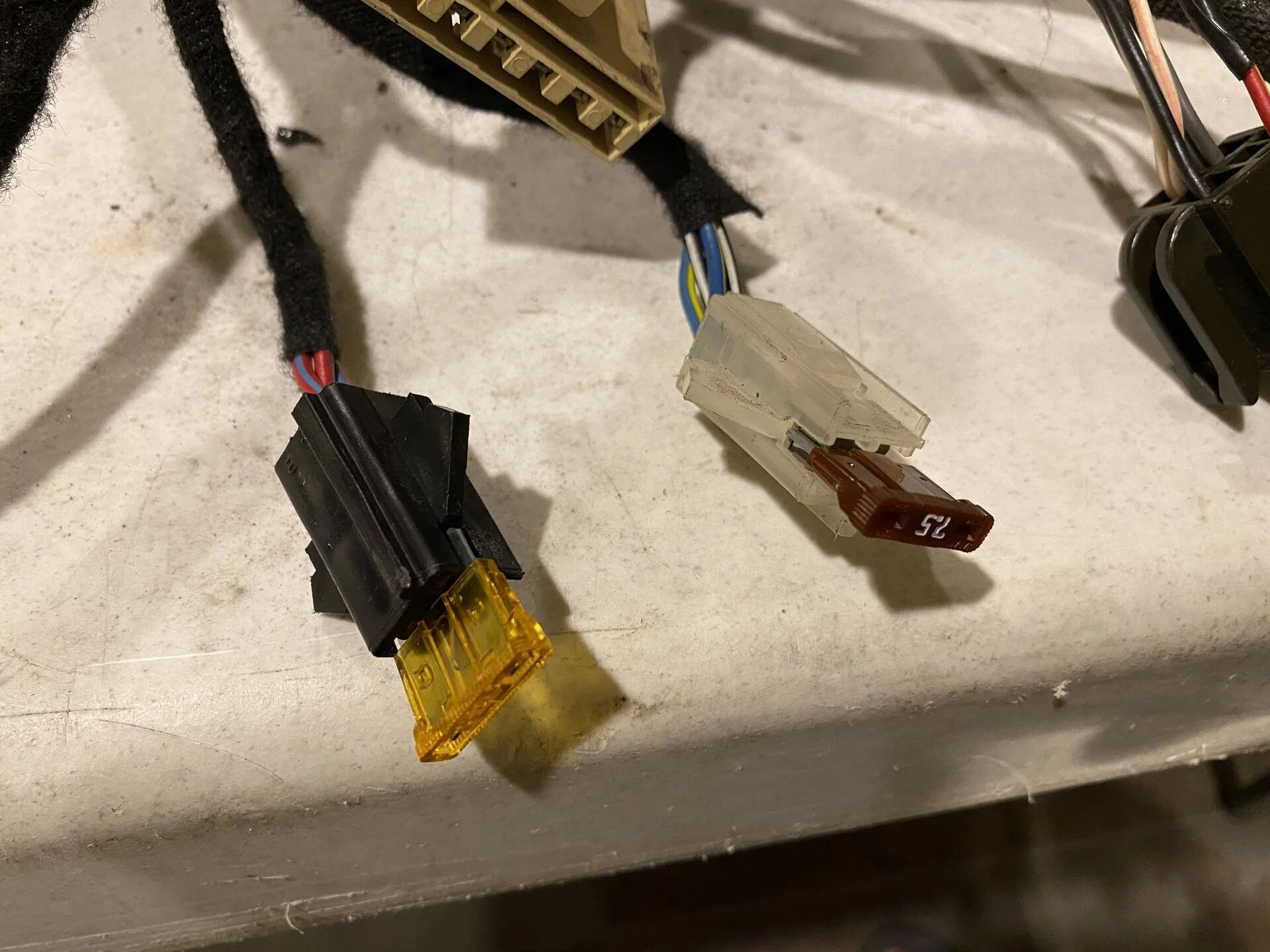

the manual trans cars use a clutch safety switch that requires full depression of the clutch pedal to start.
to bypass this for testing purposes, remove the black plug from the clutch switch (red/blue wire) and junp it with a blade fuse. This will eliminate the clutch switch from the “doesn’t crank” scenario. Obviously make sure car is in nuetral
