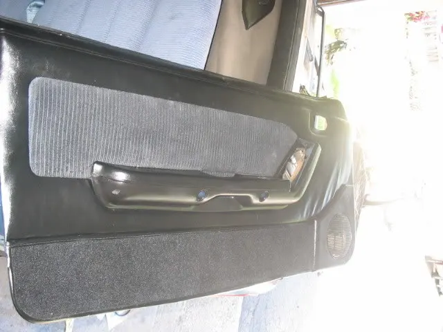

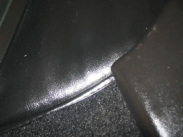

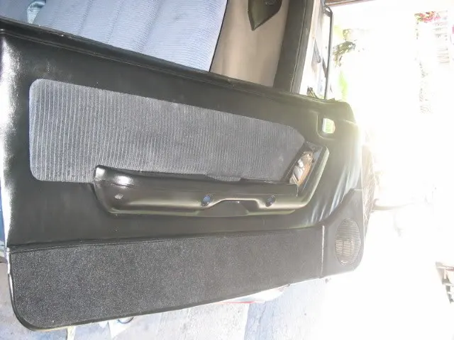

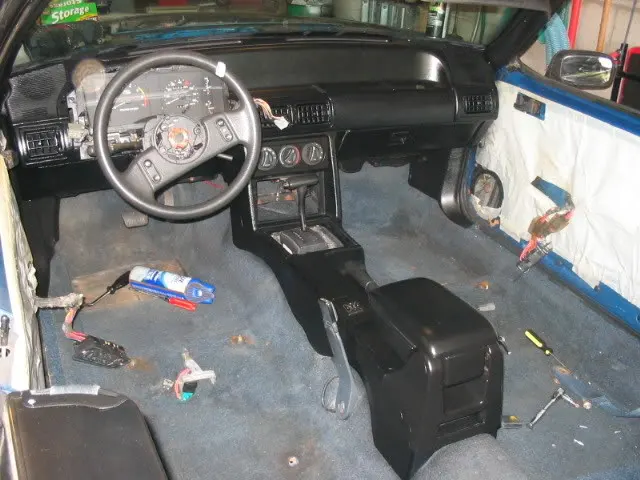

i dont know why you guys even using a primer for this...
all i did for mine was
1. pull all panels out...
2: wash with soap and water...
3. degreased with simple green..
4: washes with soap and water again..
4: rubbed panel down with achool
5: put one coat on...waited 15 mins... and repated this step 4 times....
ive droped screw drivers bolts my cell phone and it has not scratched our chipped anywhere....sit stuff on my dash while driving with it sliding around and nonthing...it dont chop crack or anything...
the ONLY pieces i have problems with are the door sils from getting in and out of the cash that over a few times getting in and out it rubs off from the bottoms of my shoes....
i dont know whats up with everying getting **** for results lately...just take your time...

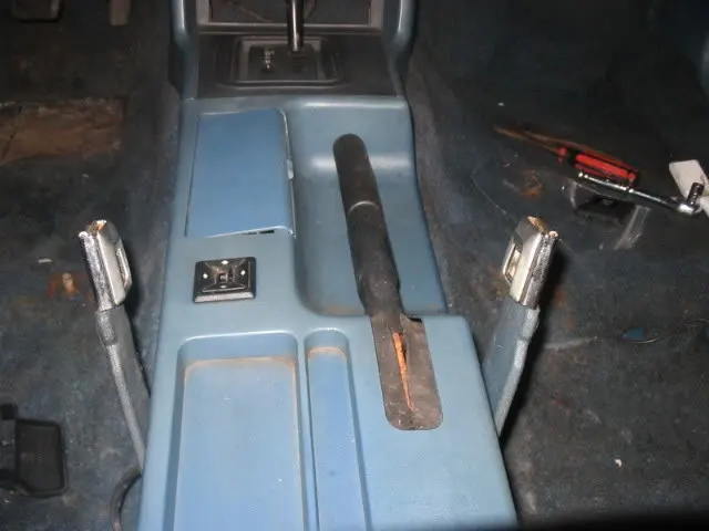

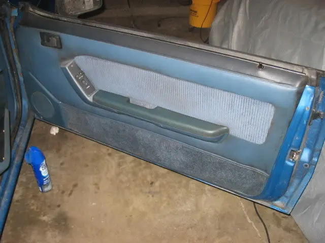

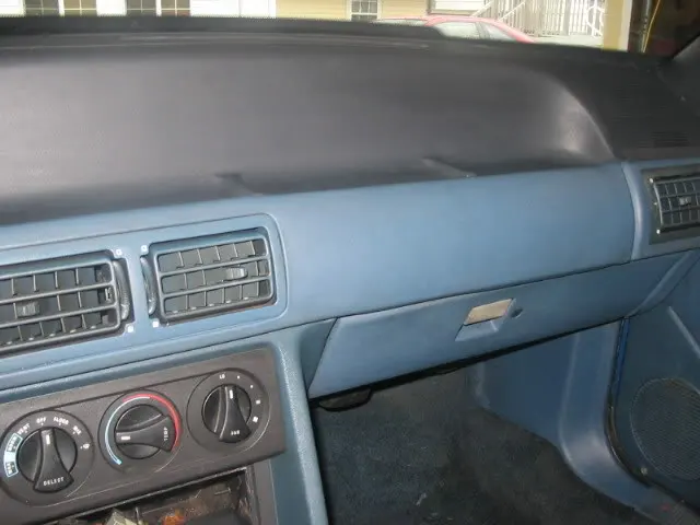

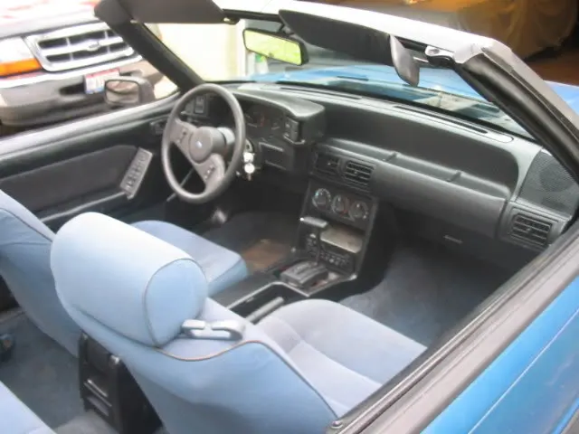

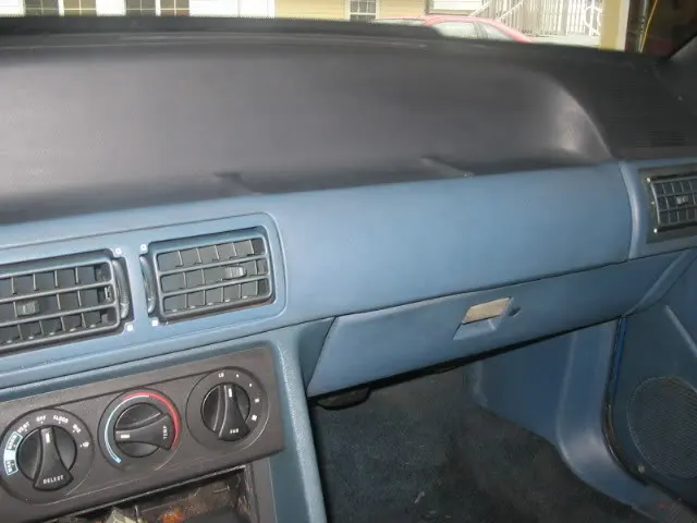

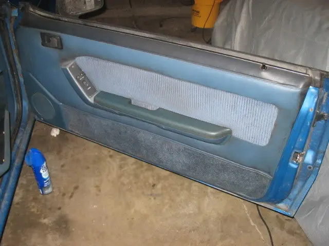

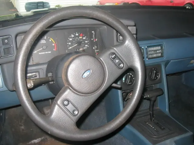

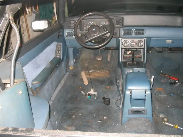

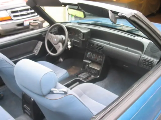

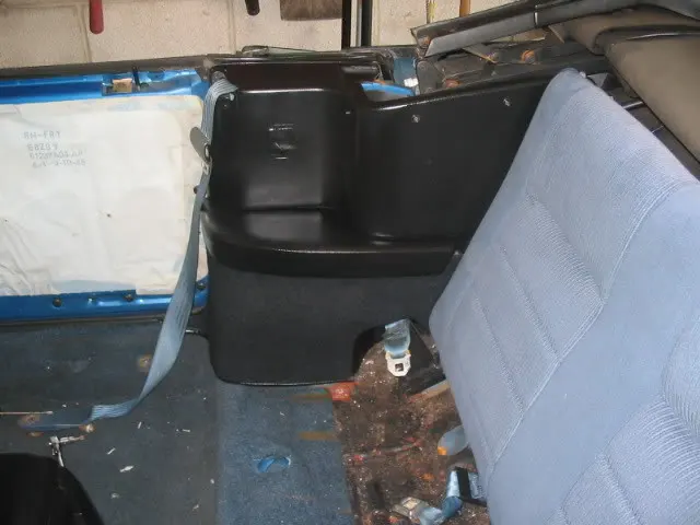

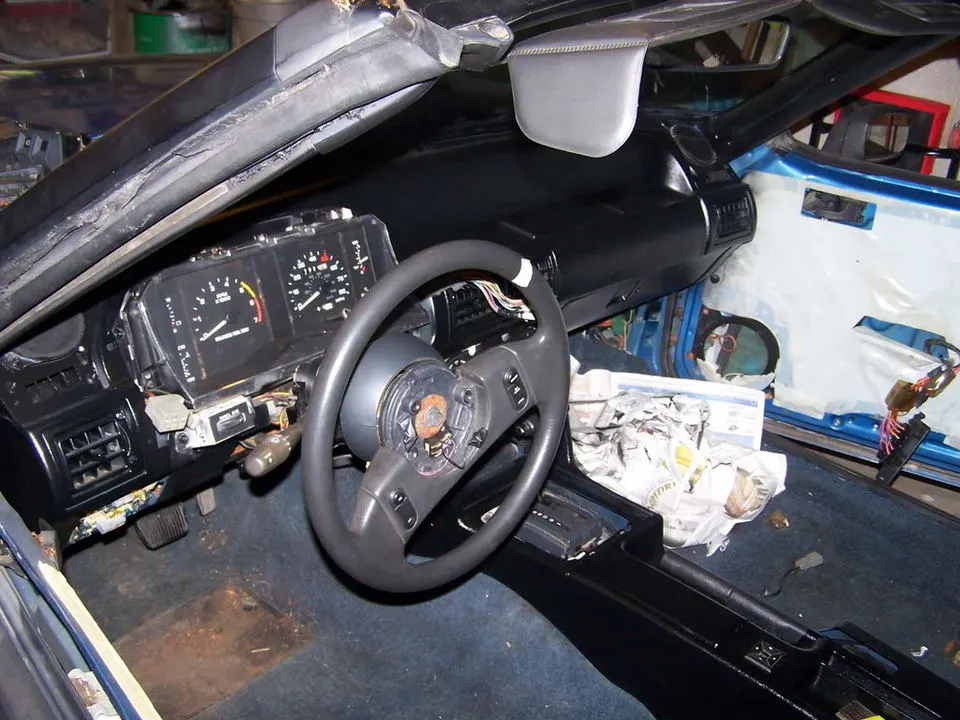

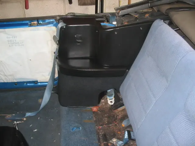

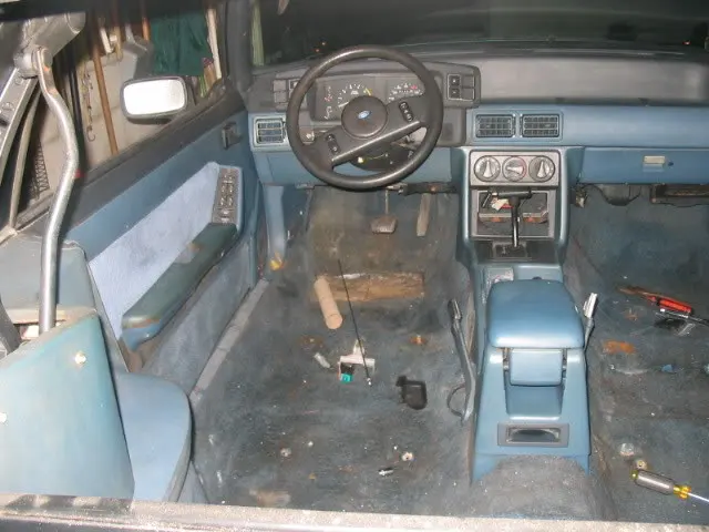

pics...before and after
AFTER
DONE

Ryan drive your car as much as some of the other guys and see how long it lasts. I know 25th did a hell of a lot of prep to his and even 4-6 coats and his still scratched ff.
since mine was done the car has been drive a lil bit over 500 miles...it gets driven more then you would think...my dads been driving it too work a few times a week i drive it on the weekend to piqua and back...3 hour drive there and back about 180 miles round trip...im no gently with and like i said it dont crack chip scratch or anything...
its not like my car sits in the Conner and its only driving is in and out of the garage :nonono:
it was my dads DD for 2 weeks while my moms truck was getting a new trans put in..(under warenty) and she was driving my dads truck and i know my dad is not easy on it either...

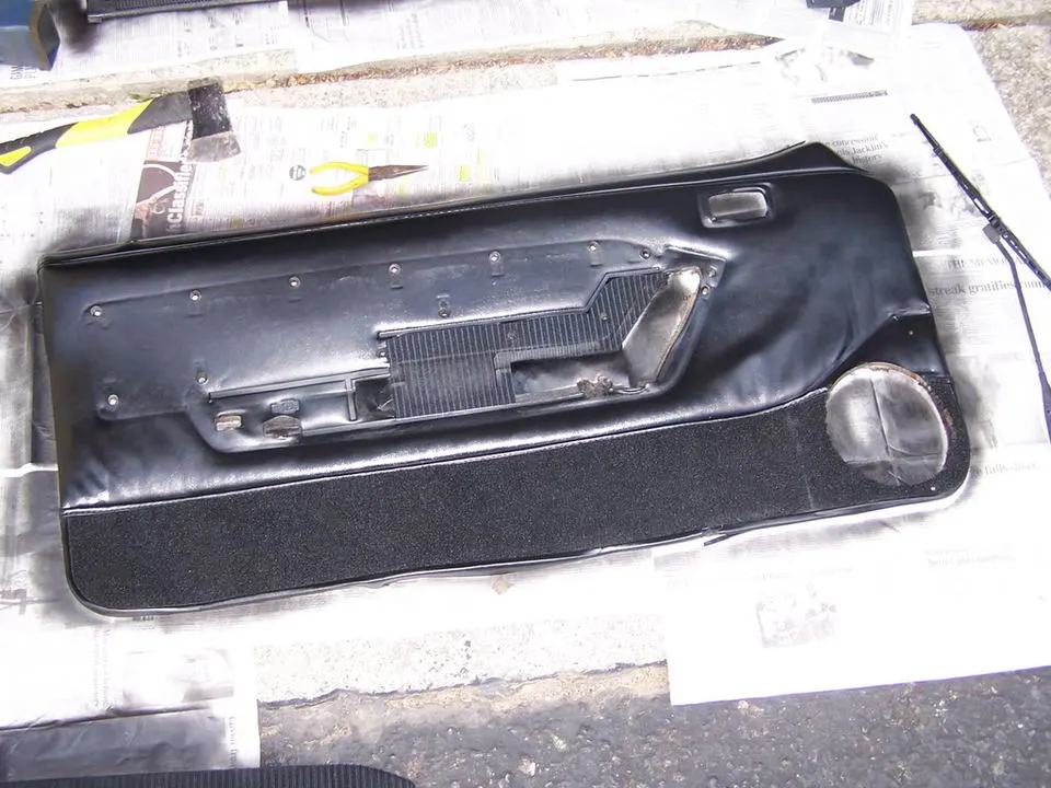

took out all the parts
sprayed down with Fantastik, scrubbed with brush, rinsed
sprayed down with Tuff Stuff, scrubbed with brush, rinsed
wiped with denatured alcohol, let dry
not like any of this matters. the primer cans were practically spraying grey powder onto my work. I would quickly swipe my hand over the piece after it was dry, creating a sandstorm in my garage. the cans didn't spray right either...the paint came out in spurts, with drops of resin splattering onto the piece. other times, globs of pigment decided to fly out of the spray head. also, a steady, constant spray was never attainable, no matter how much I shook the cans. thats all i can remember right now.

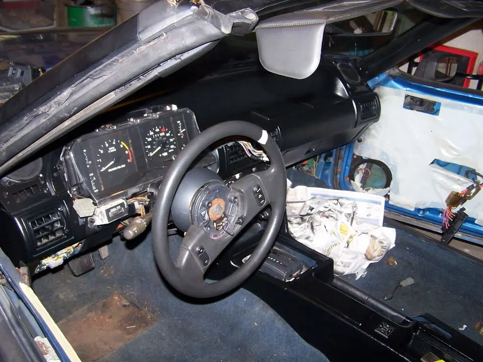

I have driven my car probably 3500+ miles since it has been on the road (2 months or so). The arm rest wore off, I have easily 4-5 scratches or areas that have worn through, and another place where it is coming through, the seat belt buckle on one side is half red now. I did a lot of prep, scuffed, degreased, 3 coats of adhesion promoter and from 3-10 coats of black.
I will say it is eay to just touch it up with more color when needed, but a real black interior is the only way to go.
