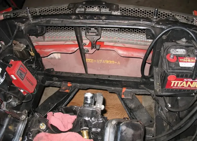

If you look closely at the following pic, you can see where I cheated when I swapped the radiator support. I bought the support without the front frame connector and rather than mess with the the holes that the wiring passed through and with trying to get the old layer off, I simply overlapped the support about in the middle of the frame connector. Made for a good place to weld and the work is entirely hidden by the radiator and the battery:

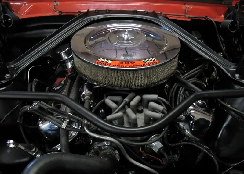

I use a curved to clear the added height of the 393w. As mentioned, the curved Monte Carlo does little to nothing for support. It looks really, really cool though:
