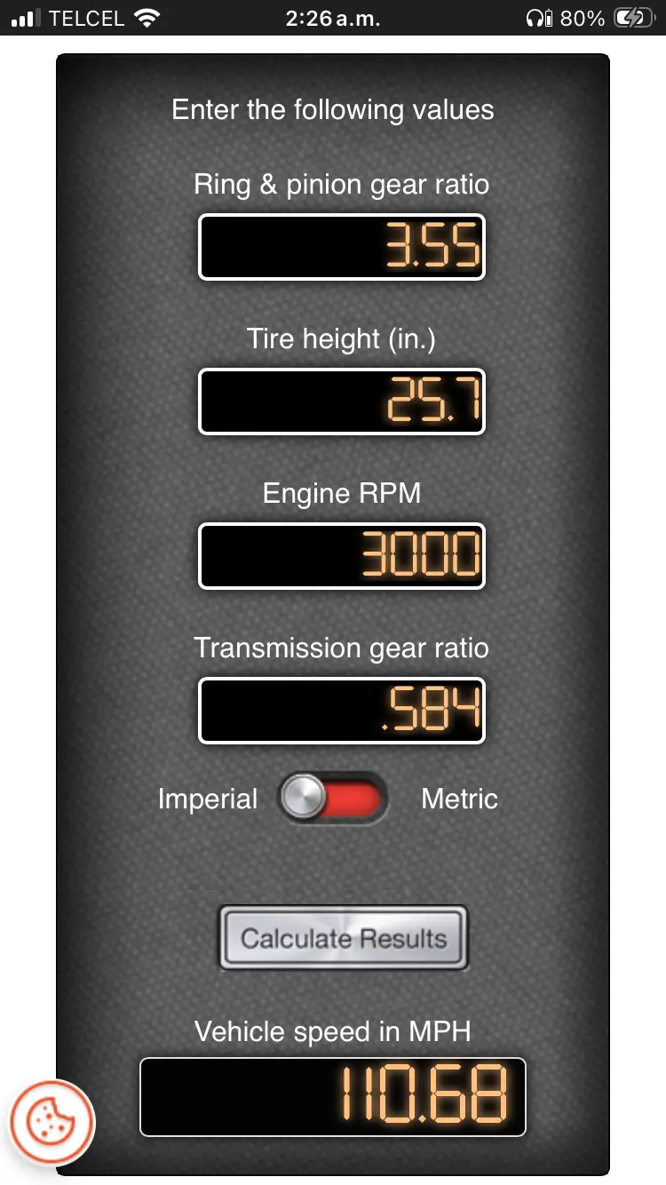

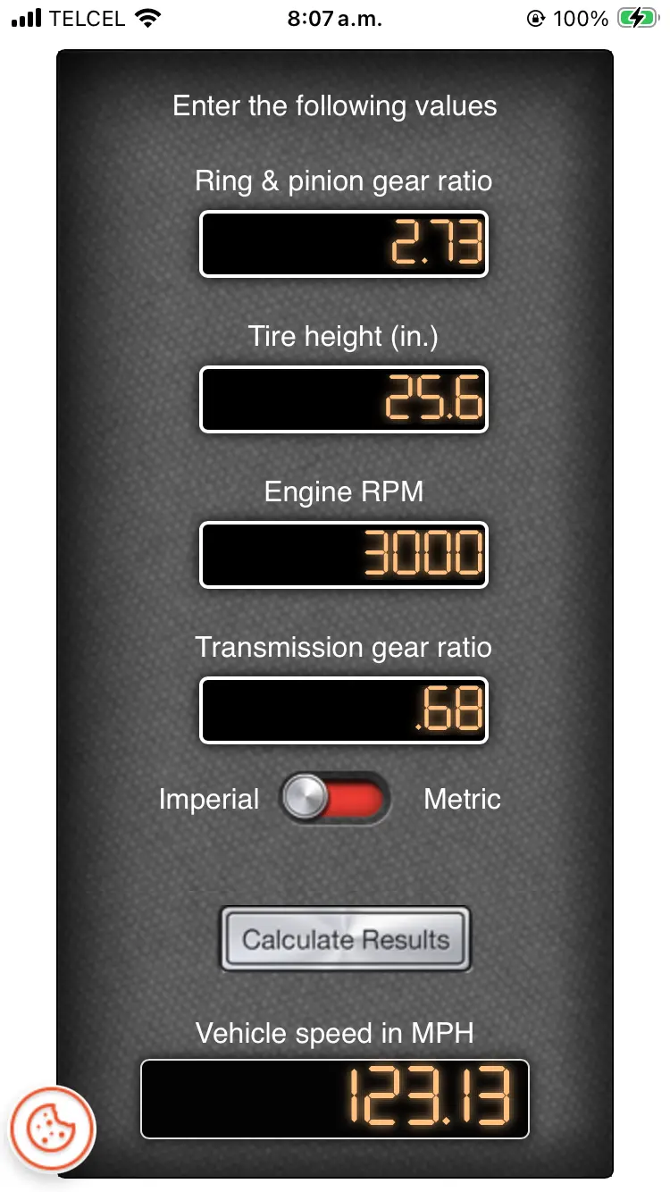

I hear you! I replaced my 2.73’s about 14 years ago and never looked back after I installed the 3.55.
Those 2.73 make a nice road runner!
Here are the speed/rpm comparison in between the 2.73 with .68 ratio 5th gear and the 3.55 and .584 ratio 5th gear at the same given rpm.

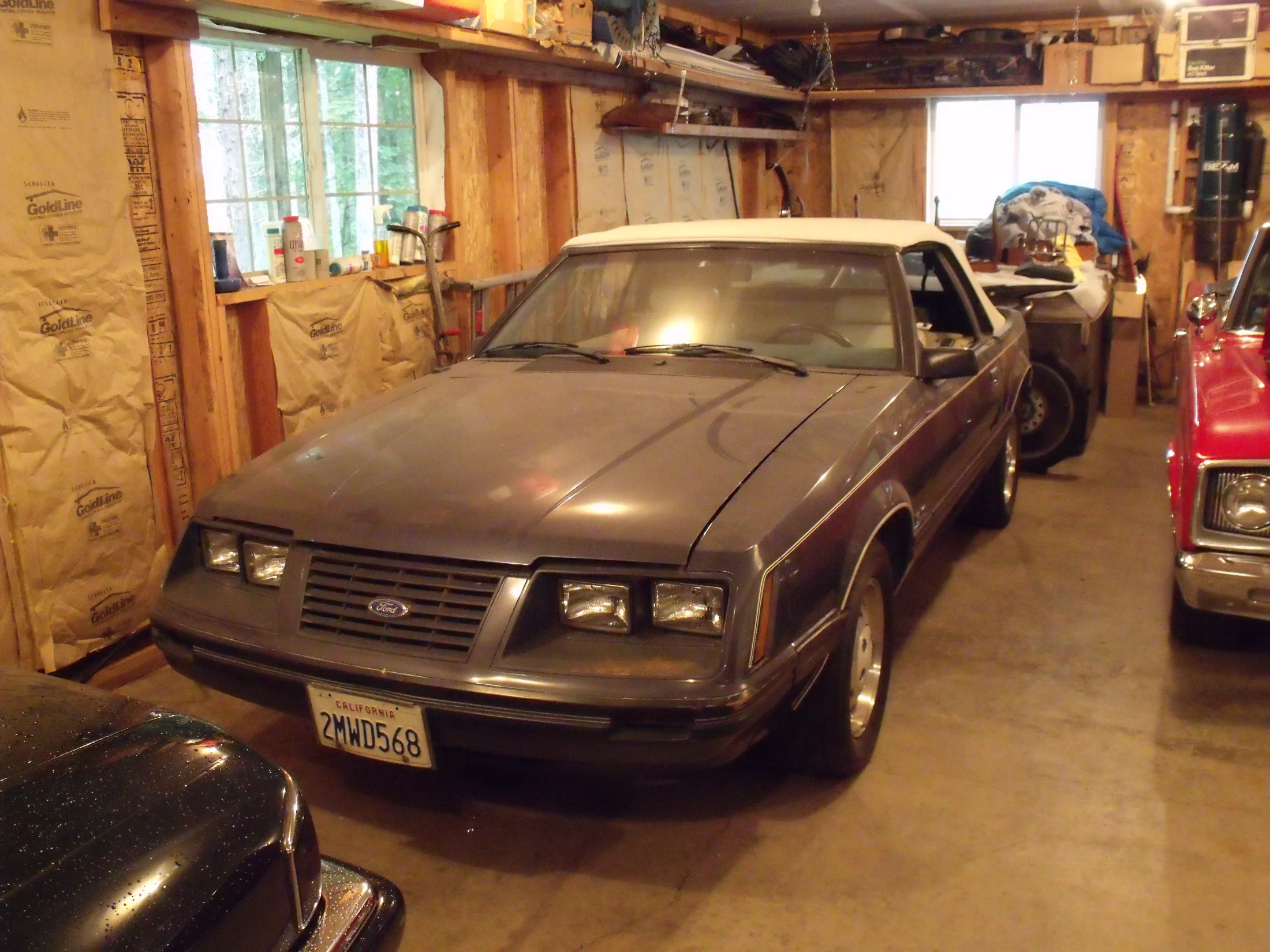

My 83 I am working on came with a SROD 4 speed ( .070 OD 4th gear) and according to the tag on the 7.5" rear, had 3.07 rear end gears...
My sister bought this car in 84 and I drove it occasionally in that time frame.... I can't remember any RPM settings but my mechanic friend and I used to joke it would probably go 150 mph .... It cruised at 90 - 100 effortlessly when I drove it from Oregon to California a few times....
