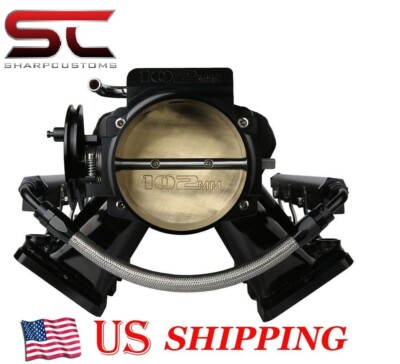

Stay away from short runner intake manifolds.

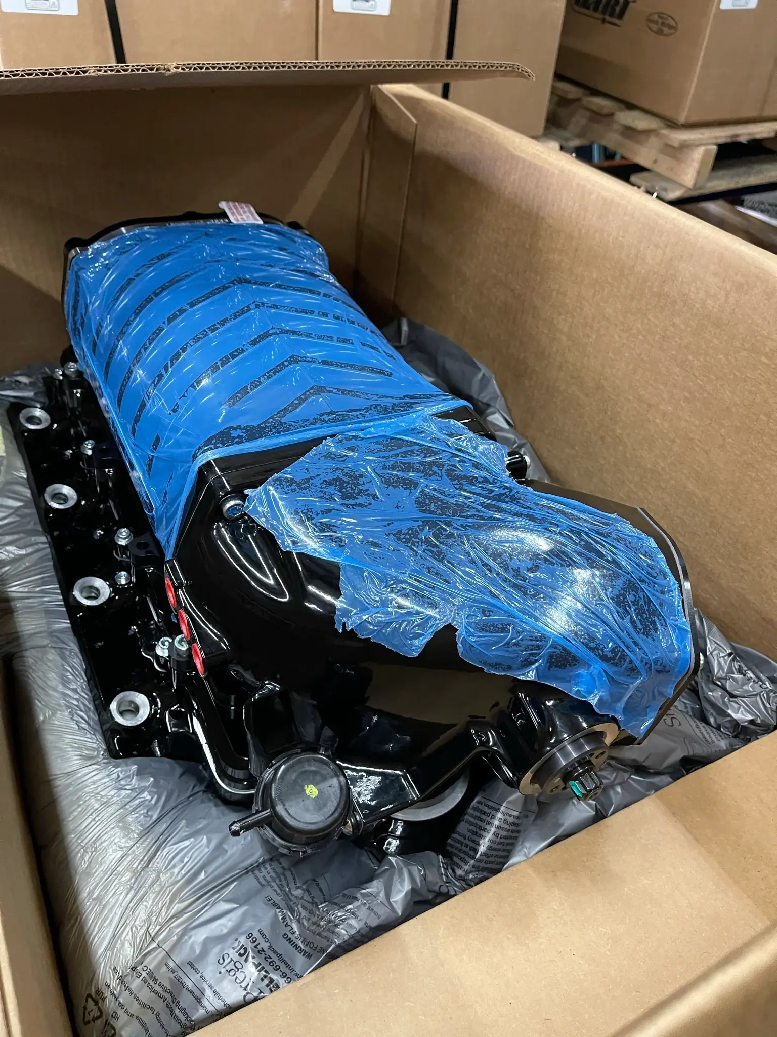

You have any intake recommendations?

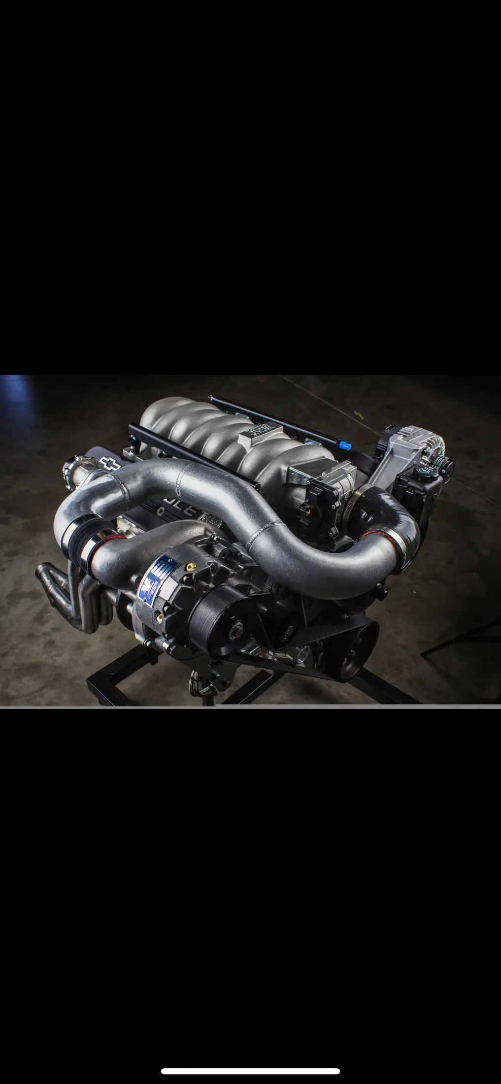

One day I hope to add a PD blower for it.

If you are doing a cam, get Johnson lifters and trunion upgrades. I wouldnt do heads unless you wanna make over 1000hp. Stock 5.3 heads flow more than enough already. I would do a blower long before heads.
