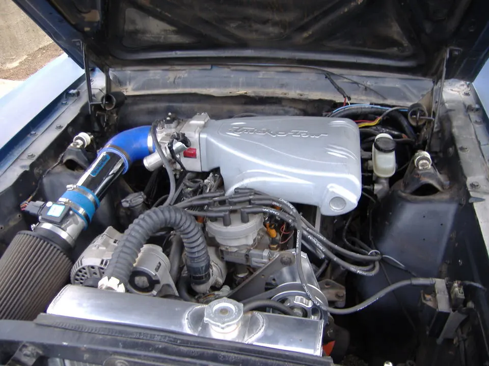

Both rides are very nice. I have never thought about using a Retrotek or Edelbrock efi system. Any issues with tuning on either?

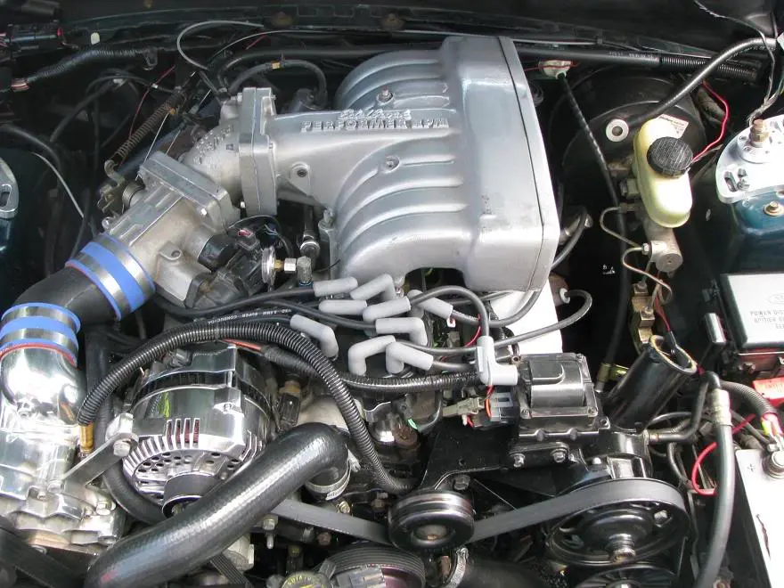

Not to hijack, but I am wondering the same info. I have a 331 w/S-trim in my 95 coupe and was curious if my Performer RPM EFI intake would fit under the stock 66 hood?
I have the Edlebrock Performer EFI and it fits. It is very close to the hood but but it works. My other issue I had was the V brace. I tried a couple different brands, but ended up making my own to fit. I have heard that the GT40 intake with a little porting is a great intake especially for the money!

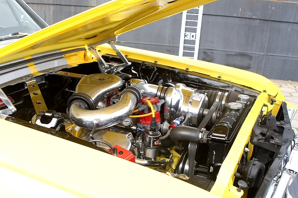

I have the paxton supercharger on my 331 with a vic jr and a carbhat.
Decided not to use the carb enclosure !
With a low style carb hat i didnt have to mill anything from the intake to make it fit.
Its a squize but its working.
The most work was the dyno tuning, everything is good now and it has loads of torque ! A blast to drive !
