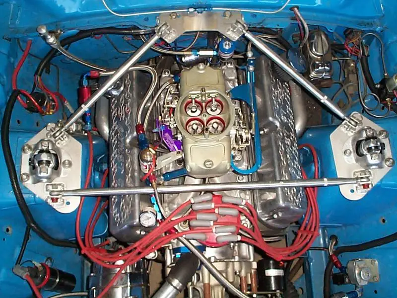

Tubular makes 1 7/8" headers.
6208 Hooker SCs are 351w swap headers with 1 3/4"... but I have seen them used on SBFs with only spacers between the head and flange. Fit better than with 351. I know of a guy that runs them on his 1/4 mile car with a 347 (205 AFRs). He used a set of header flanges as spacers.
Edit:
Crites restorations also makes a set of 1 3/4" headers.
They claim they fit either a 351 or 302... I was skeptical at first.
Such tight engine bays, how could they fit either engine?
I have seen install pics for both engines with this one header in a Maverick and both ways looked great. (65-66 Stangs and Mavericks have very close engine bays and can interchange most headers)
Edit2:
Found a pic of that 302 (347) with the 351w Hookers... 6208s.
You can't tell much other than the headers do fit and will support a serious engine.
