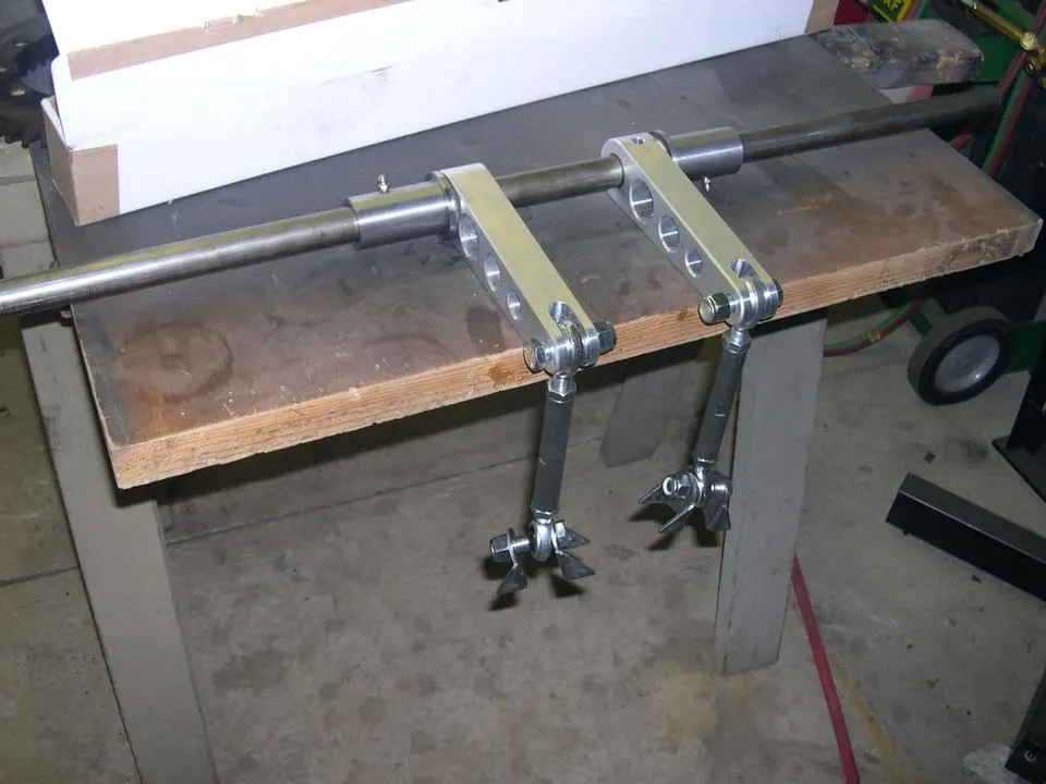

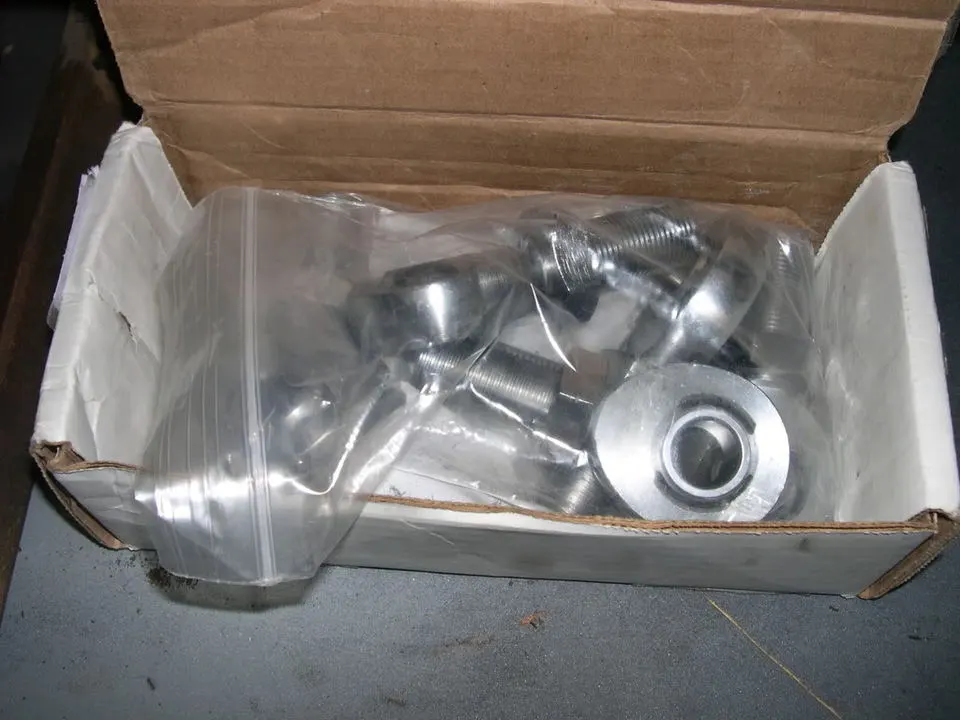

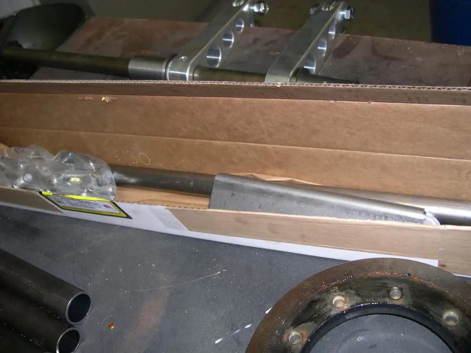

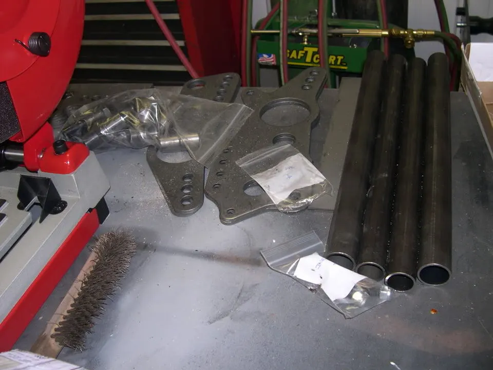

I thought maybe you guys would like to see what the parts ordered look like for reference. I also bought some new tools to help out which were long overdue purchases.
yes, those brackets are 1.4 inch.

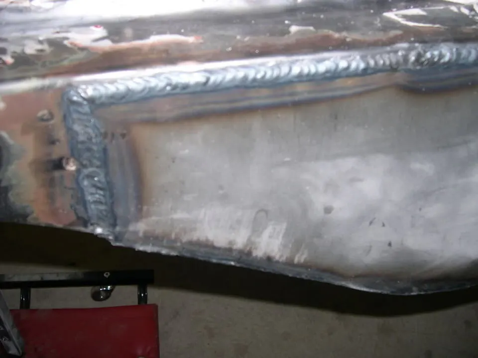

Some of my better looking welds, not perfect but I am satisfied. Those are 14 ga frame boxes to connect my front frame rails to the subframe connectors.

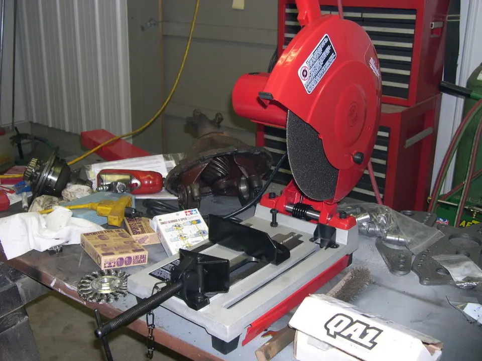

I like the new cut off saw.

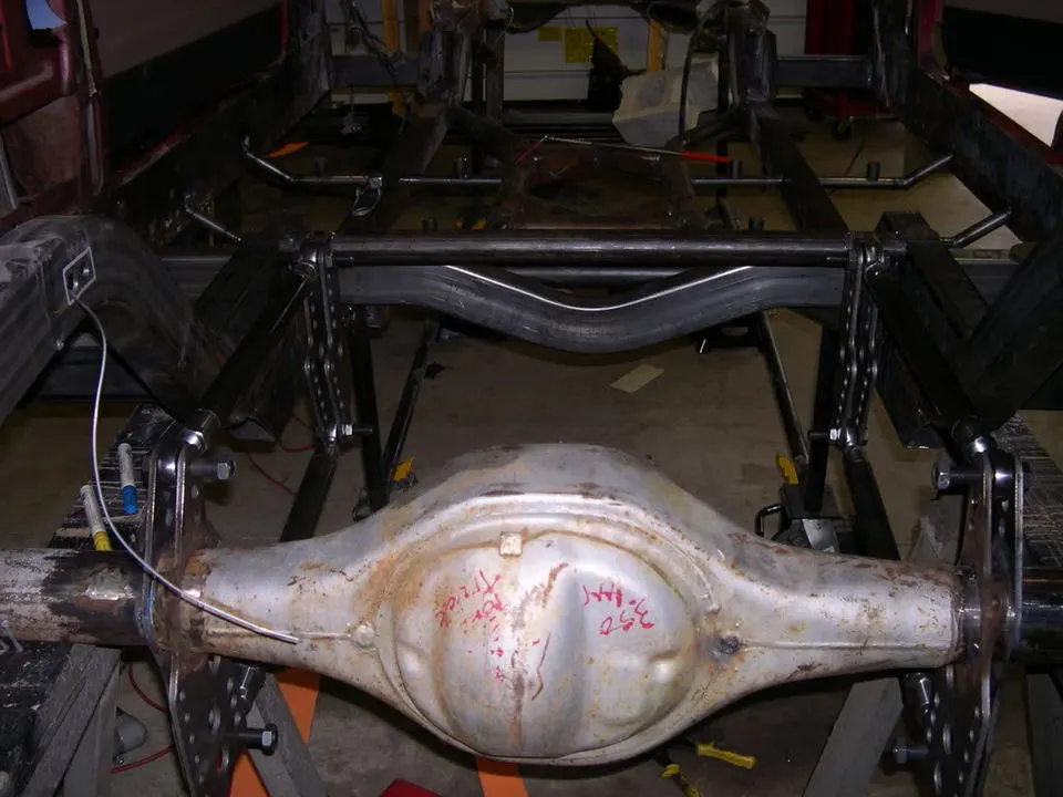

That is my sway bar, it is really cool. I cant wait to get it installed but I'm not sure exactly how to install it, it might have some clearance issues with the cross bar for the coilovers.
I have wanted that chop saw for the last 2 years and finally decided to just buy it because I could afford it (sort of).

I wish I had one, I am using my Mitor saw, and basically cutting metal with it has basically ruined it.

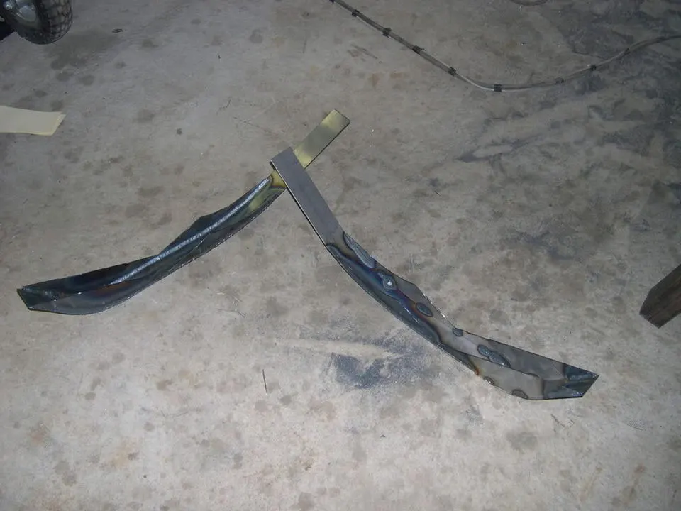

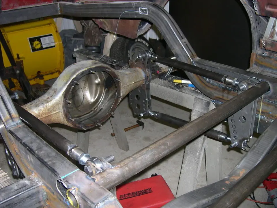

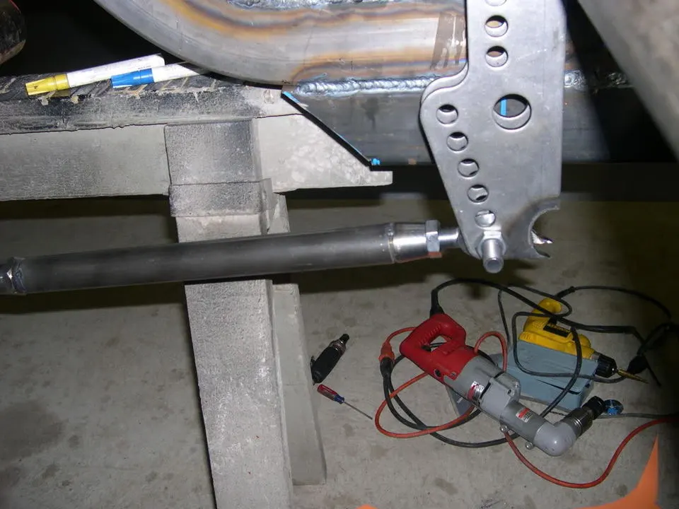

Well, I made a little progress in the last couple of days. I have been tied up in school work until now but it is finally finals week so instead of studying I have been working on my car. I ended up putting holes in the wrong place (oops) I guess I just made some more work for myself. Here is some pics.
These are a couple of pieces I made to smooth out the back of the frame rails and provide a mounting point for the bottom of the four link cross bar. They are not done yet but almost. You can see where they will go in the last picture.
