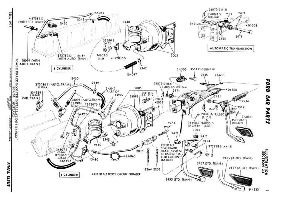

clutch pedal assy
As was said earlier, there are no springs holding the clutch pedal to the brake pedal. Maybe you are calling the spring washer or the retainer clip the spring? If your's is bad, I have two clutch pedal assemblies for sale. If you need one let me know. In the pics the plastic shoe (7A630) is on the hanger and not on the pedal as it should be.
Hm? 7A630 goes at both ends of the spring, I thought the diagram showed that pretty clearly. Your photo seems to lack the one at the pedal end, too. The one at the spring end is the more important of the two, to eliminate squeaks and prevent the spring from cutting into the pedal arm.
