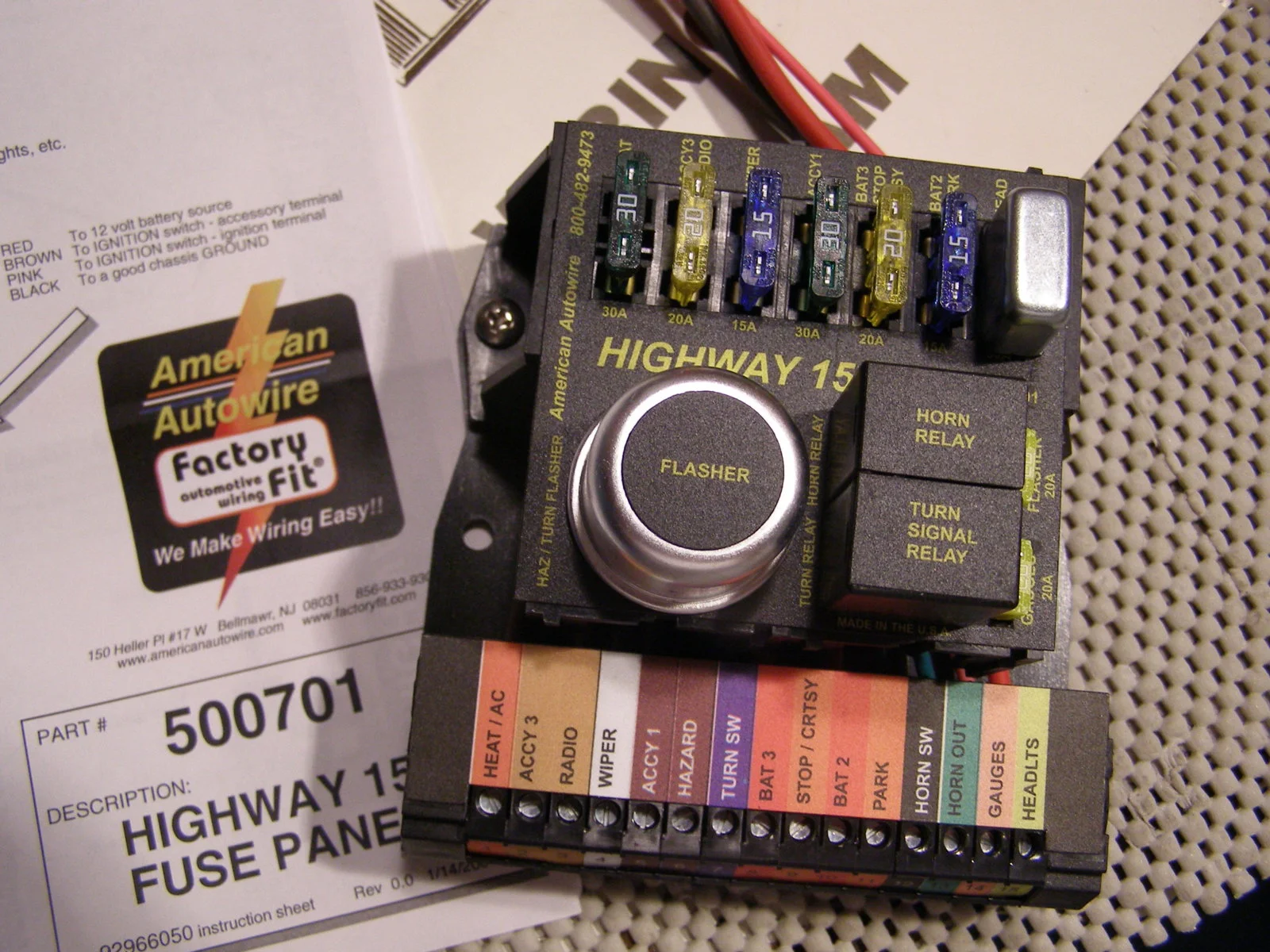

I used the AAW highway 15 and I'm very happy with the results, I use electric fan, electric fuel pump, Ac/Heat, driving lights, Ect... I have pictures of the install as well. 10 years now and still stable system. 3-15.webp

I installed the kit you linked to a couple years ago an I am very pleased. The most difficult things were mounting the panel, mounting the turn signal relays, and routing the engine harness around the backside of the gauges and cowl vent. Print out a couple copies of the wiring diagram and one copy of the installation guide. I followed that step-by-step and didn't pop a single fuse. It has flexibility for items like electric fuel pump, stereo amp, electric fan. These are the same style crimp connections used in the weather-pack connectors. The connections are very secure and quickly gave up the notion of the need to solder any of these connections. The crimp tools are a expensive but they work well.
What sold me was the detail of the installation guide. I owe that guy a beer or six.

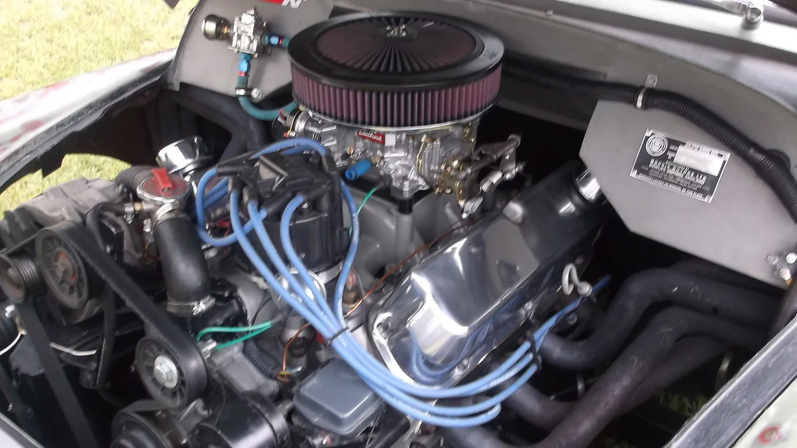

I ran a 140 amp Lincoln alternator in my small block Windsor powered Morris Minor street rod. Over kill, but it came on the engine when I bought it. Just wired in the regulator. Most people run a one wire alternator b
ecause they really don't understand car wiring. Notice the voltage regulator mounted in front of the valve cover on the pass. side.
