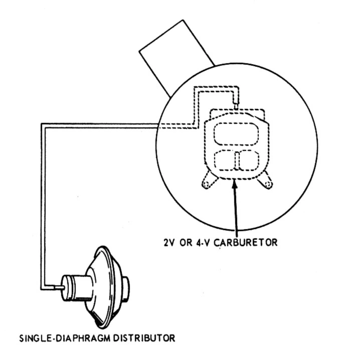

If you are getting vacuum advance at all during idle, the advance is connected wrong. It should be on the ported vacuum port on the carb. The 66 289 should be connected like this diagram. The advance port on the Holley in on the right side of the front bowl metering plate. BTW, the advance curve of both the vacuum and centrifugal advance almost certainly needs to be set. Even fresh reman distributors are usually way off, and need to be adjusted. The best way by far is to pull the distributor and have it done in a distributor machine.

Thank you for the information. I do have it in the metering block and it is not advancing off of a idle. It is once you nail the throttle the vacuum kicks in the advance goes too far and takes a long time to come back to the correct iddle. It is almost like it gets stuck. This has happened with both the Porcomp and the stock rebuilt distributors that I have tried. I will look for someone with a distributor machine and get it dialed in.
