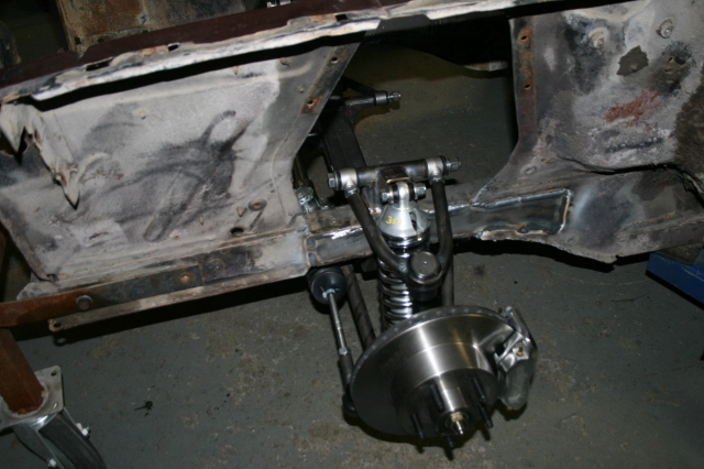

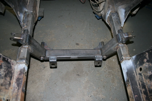

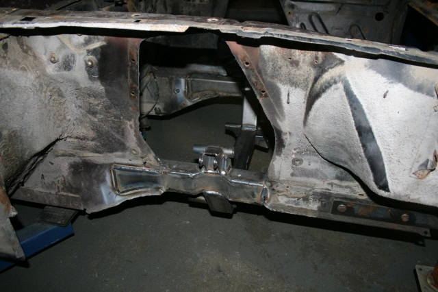

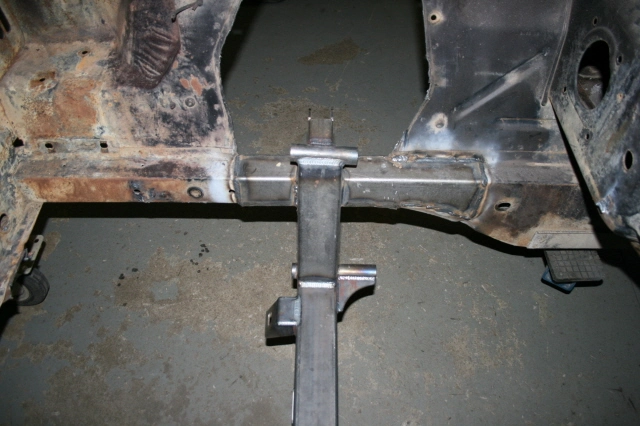

decided to go with the super ride instead of the pro g ,got a deal on it

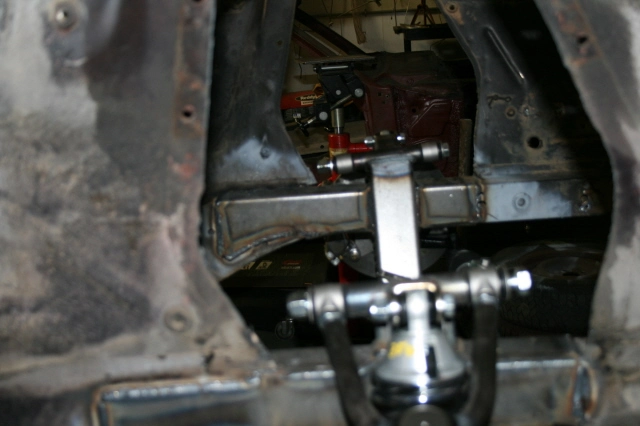

ron has the boxing plates and the front member welded in

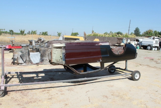

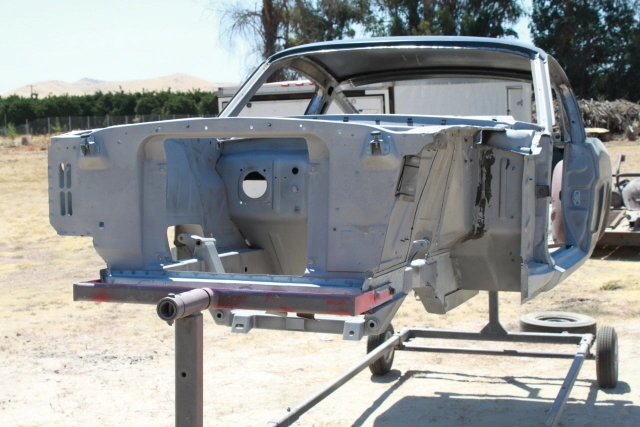

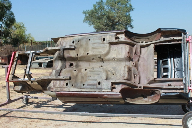

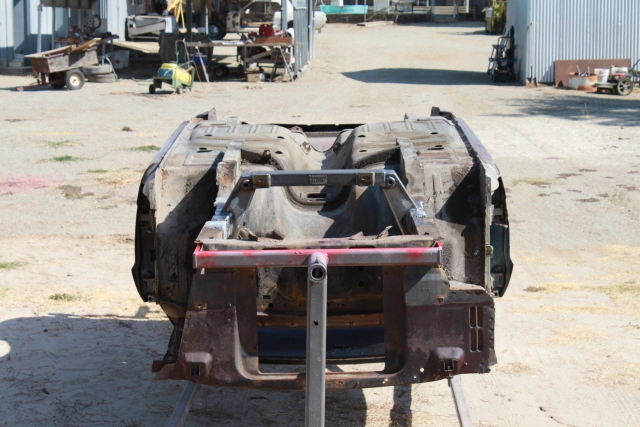

its back, the new owner wants me to sand blast it for him, not going to be to fun its supposed to get up into the mid 100s . going to blast tomarrow morning probably wake my neighbors but there parties keep me awake so i figure it fair play ,doors are still on it so it wont be that easy but we can handle it
The bottom of that car looks like it was a great donor, but I dont know if I would have that on a spinner without torque boxes on the front, theres nothing holding up the front?
yeah the bottom is realy nice if it were washed you would see very clean brown primer hardly even any rust film anywere ,with out the motor and trany and front and rear suspension there is no weight to it ,torque boxes will be added by the new owner after blasting, he has the four bar rear suspension as well it will go in after blasting,cant wait to see it all in one color primer.

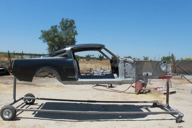

fired up little Leroi and

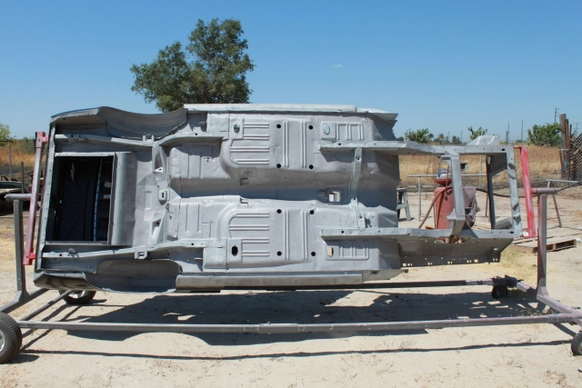

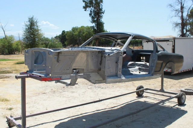

got it blasted ,this was the easiest car i ever blasted the primer was so thick under the car there was no rust, i couldnt get all the paint drips off they were so thick .there is still a little tar that will have to be scraped but not a lot, the inside was realy clean but i did find about 8 tiny pin holes ,quick zap with the wire feed and they will be gone.
going to be a realy nice car. i guess its going back to stang-aholics, they are going to install the rear 4 link and front torque boxes. i will try to get more pics after they epoxy prime it, i want to see it when its finnished

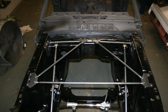

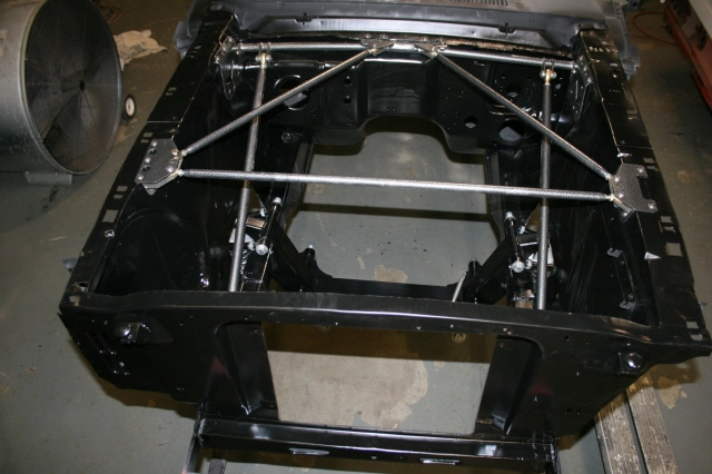

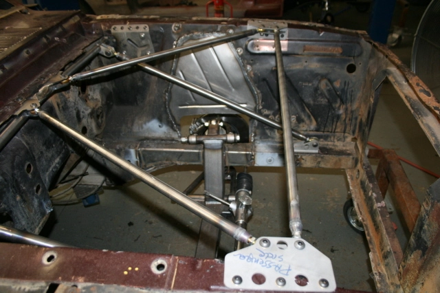

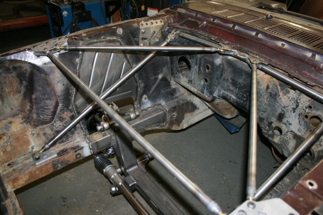

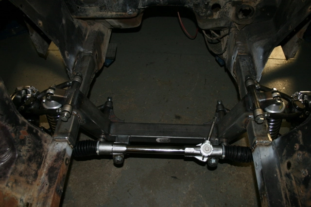

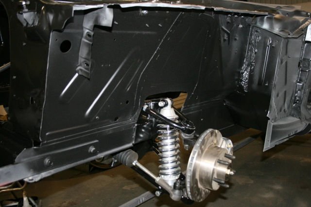

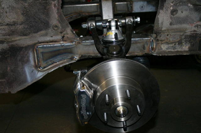

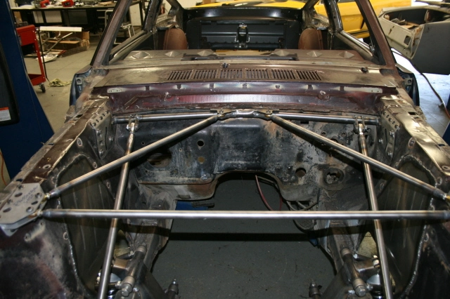

just thought i would show a couple update pics ron sent me on the coupe to fastback they have the motor compartment painted and the suspension is bolted in. they are going to do a photo shoot with mustangs monthly. they will be installing the new Kenny brown rear suspension, going to try to be there for the shoot should be interesting and fun.
That underhood bracing is nice, I'd I had a mII style front suspension I would insist on that for added stiffness, heck even on a track car with stock style suspension it would help.
