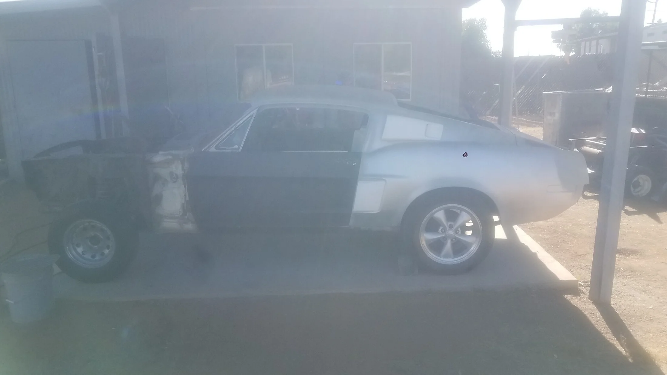

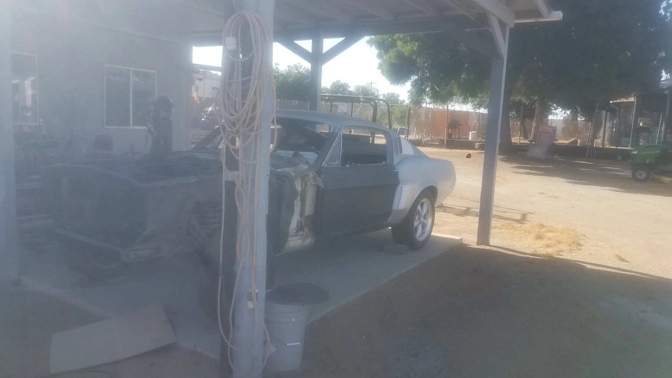

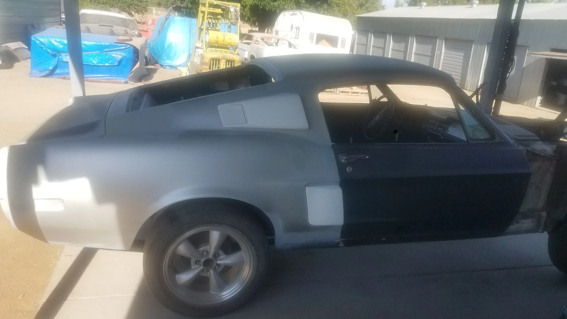

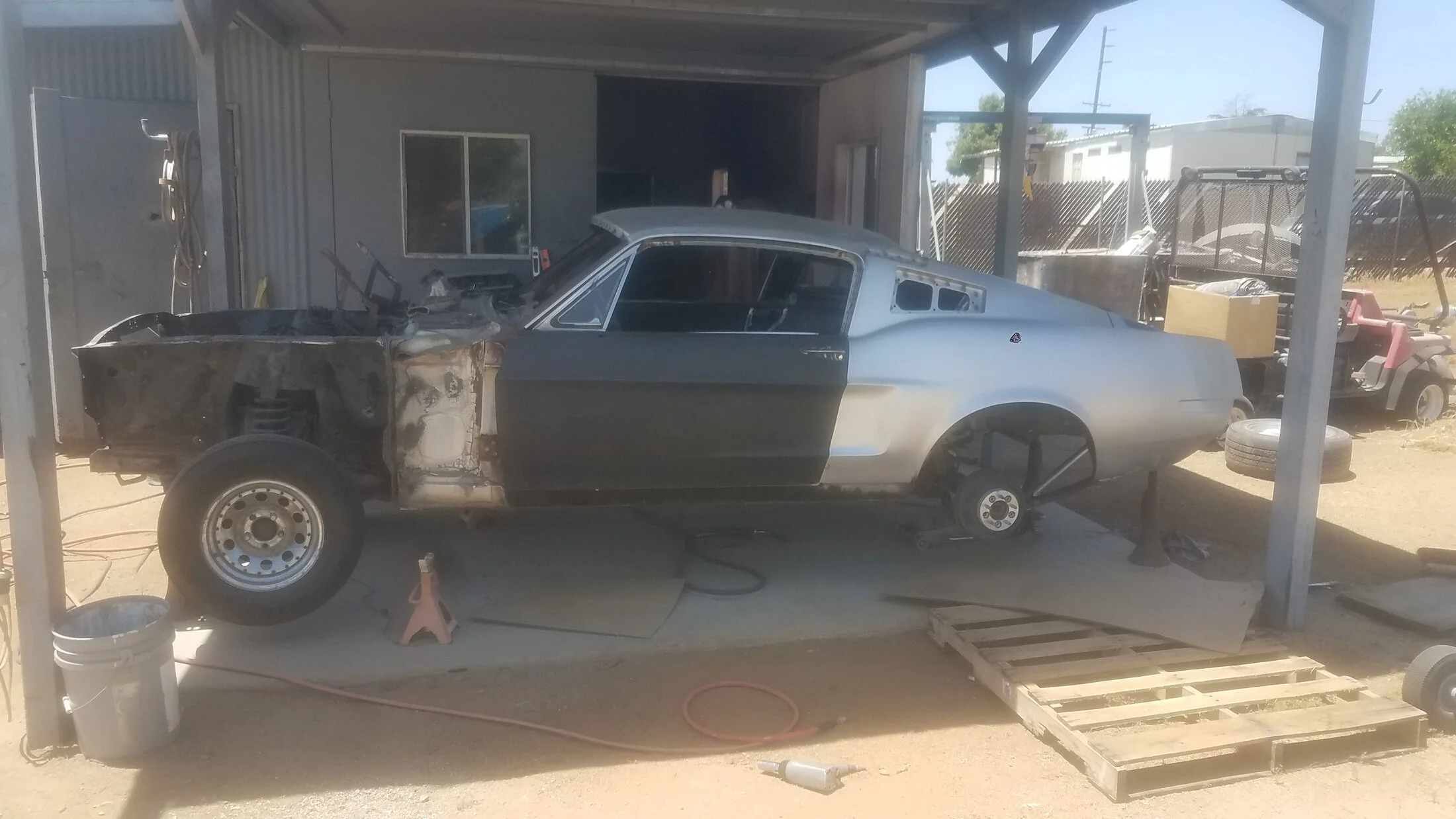

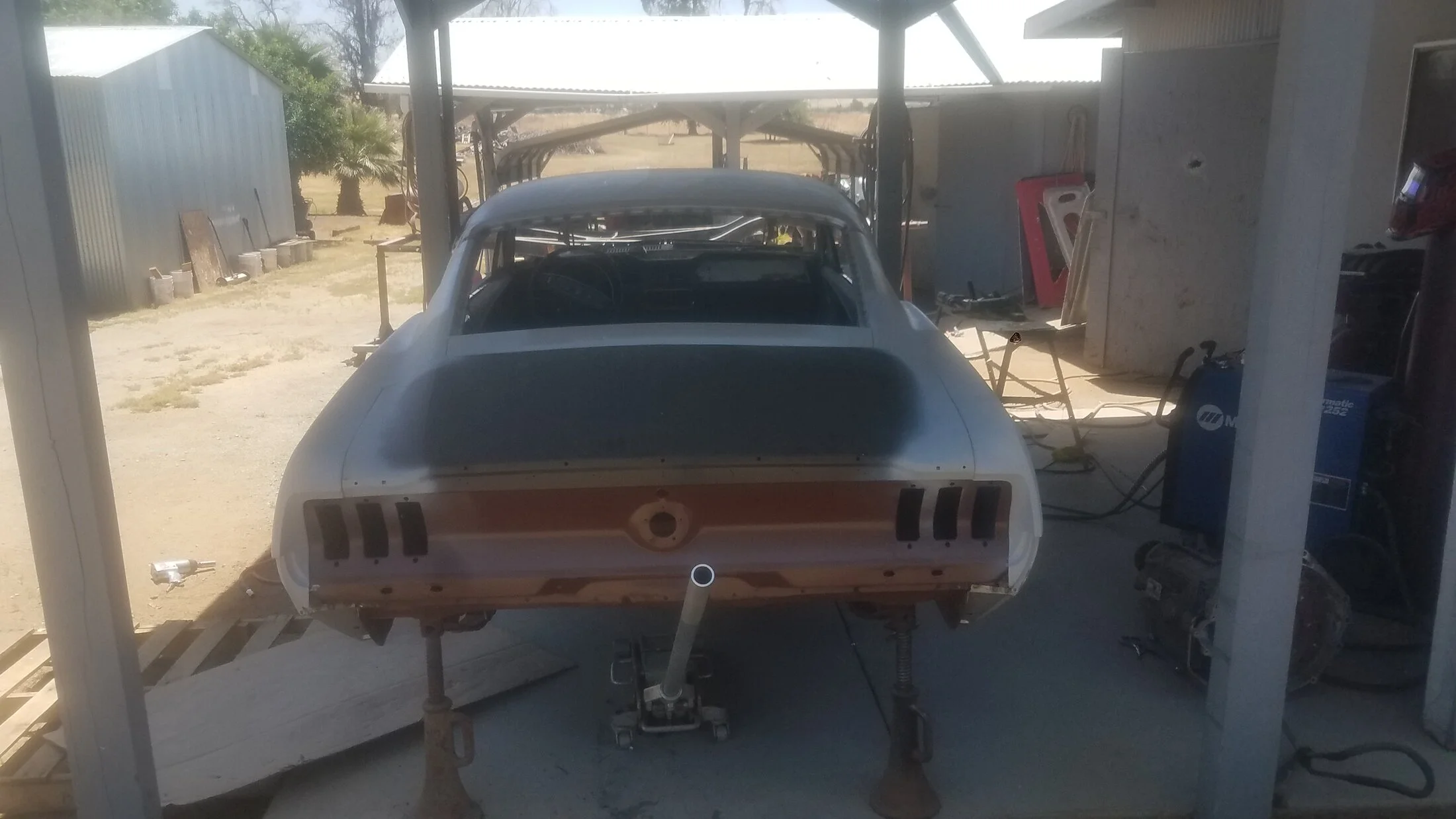

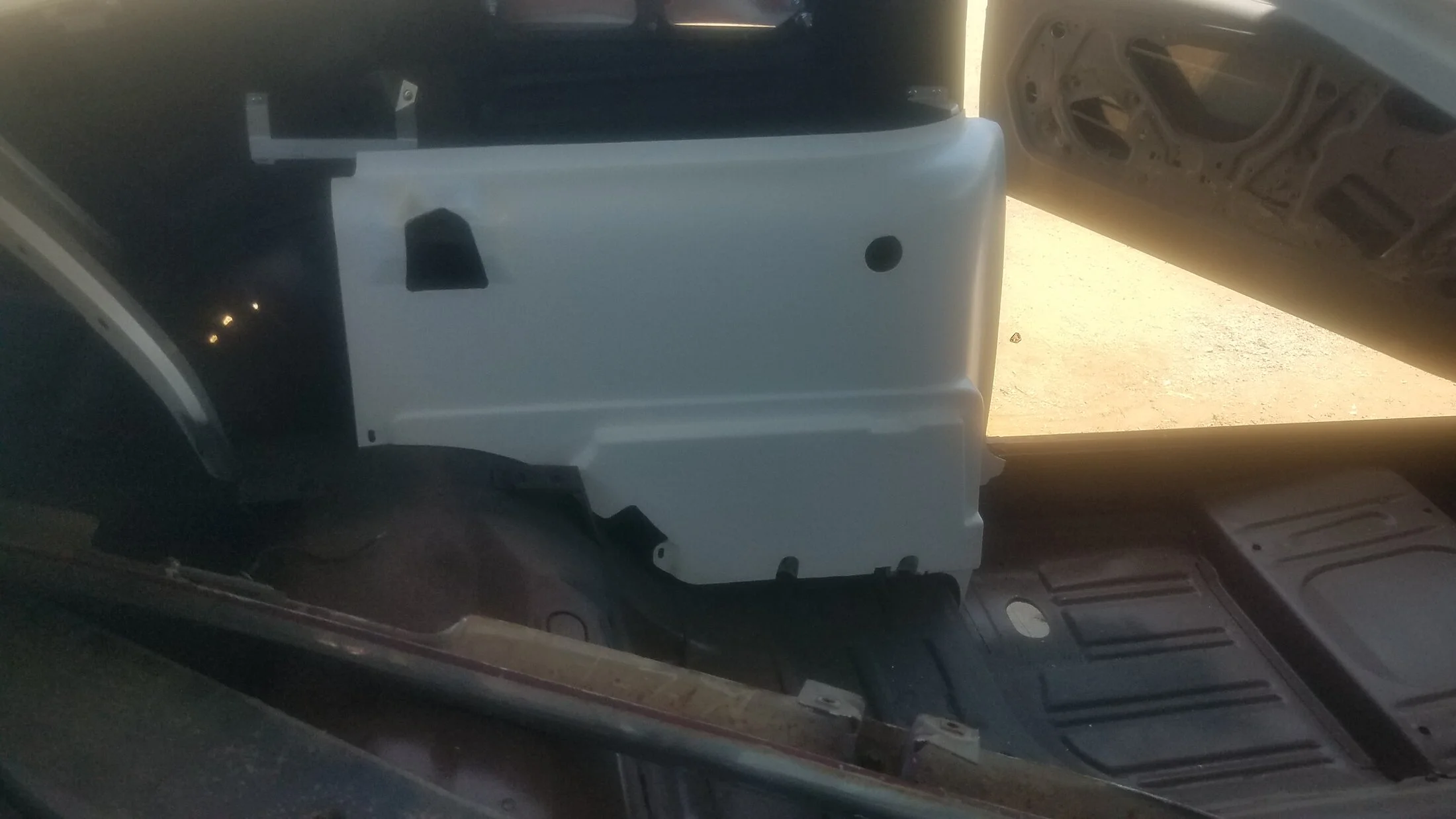

A 67 fast back conversion for Mrs. bbettto !
The old back is all better now.

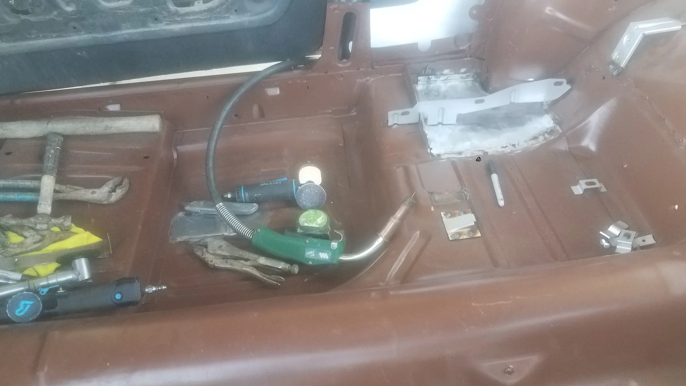

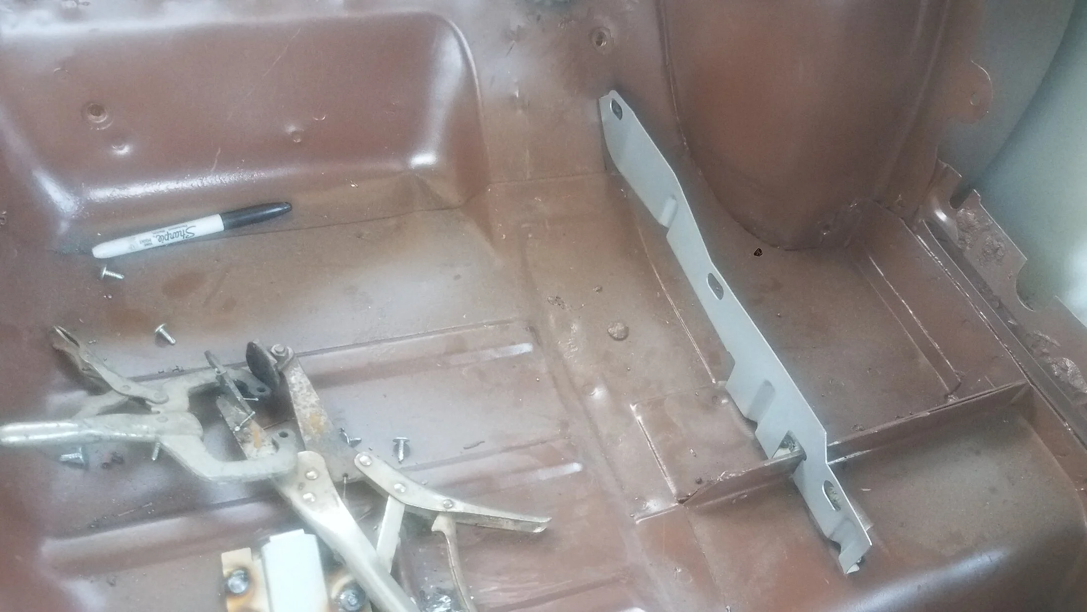

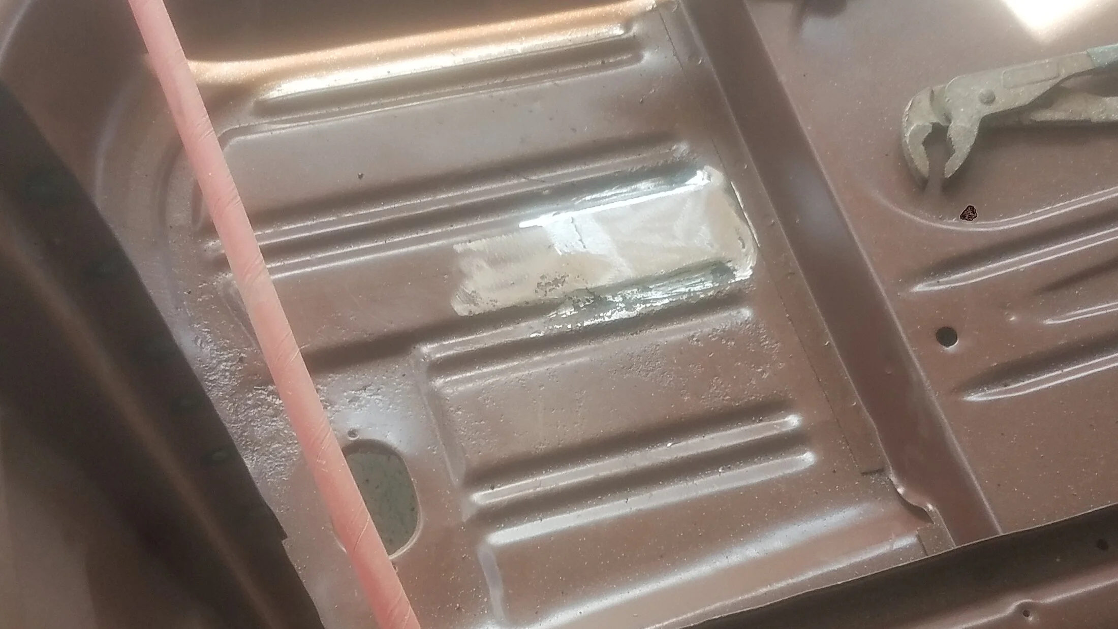

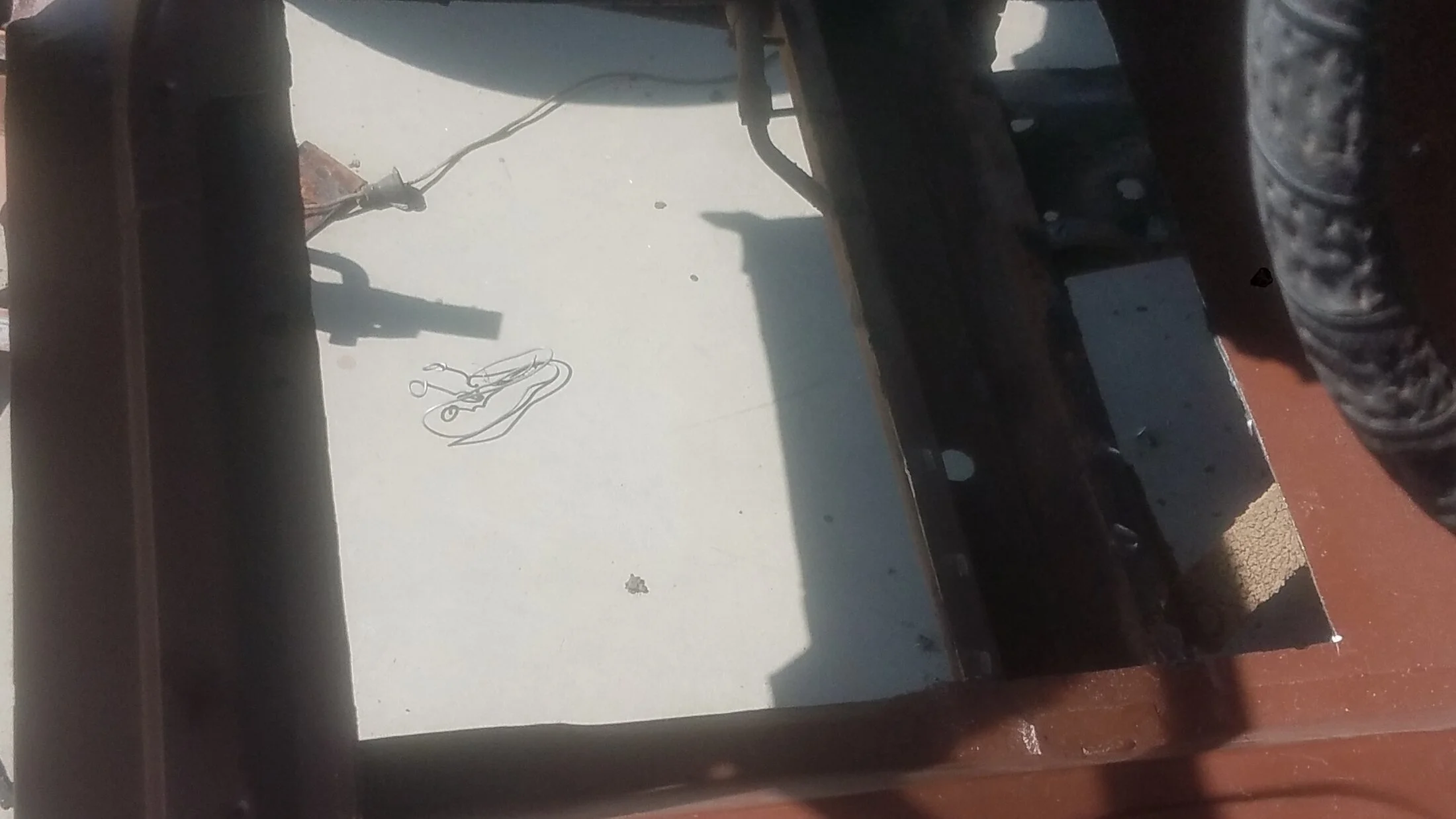

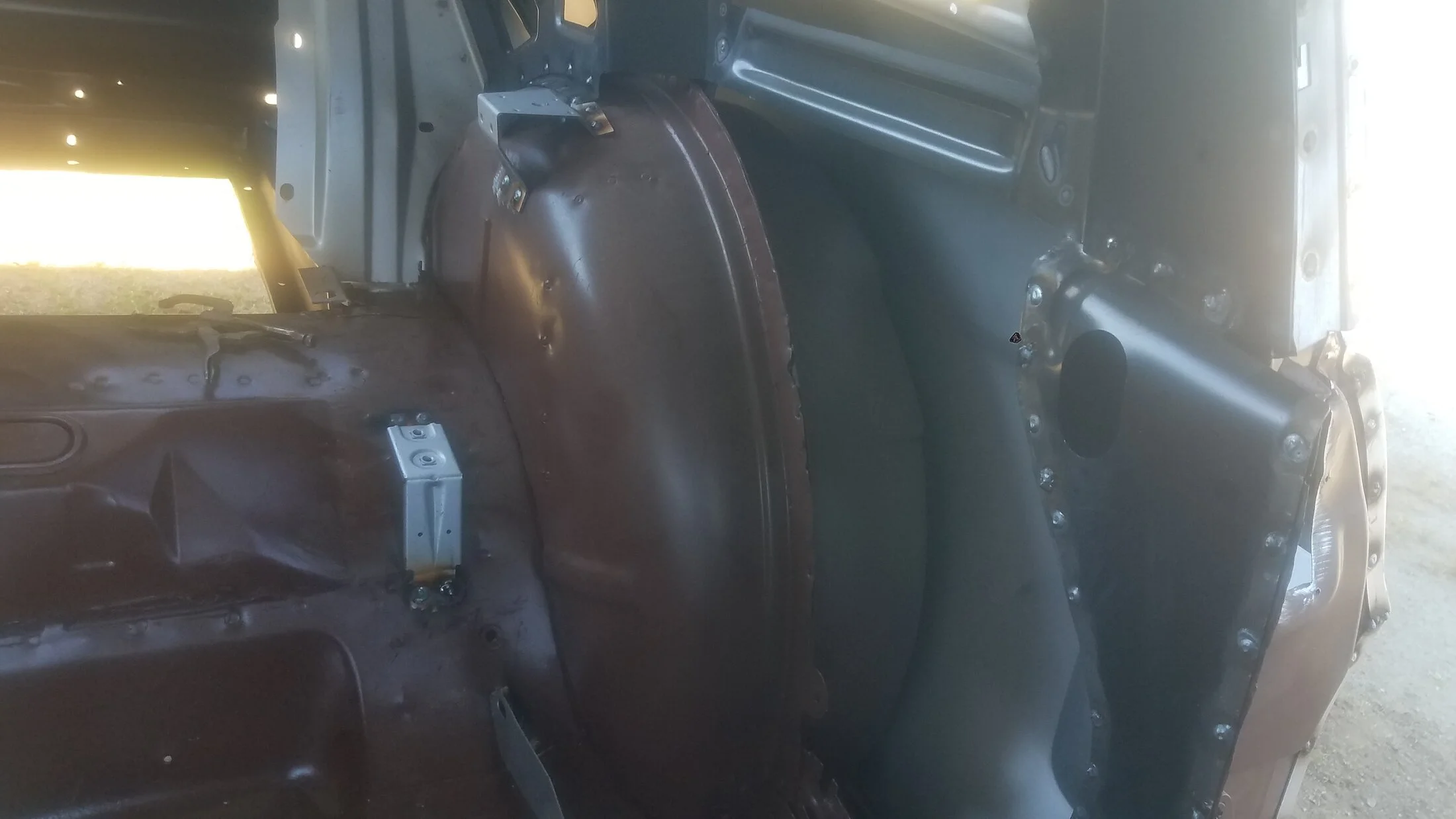

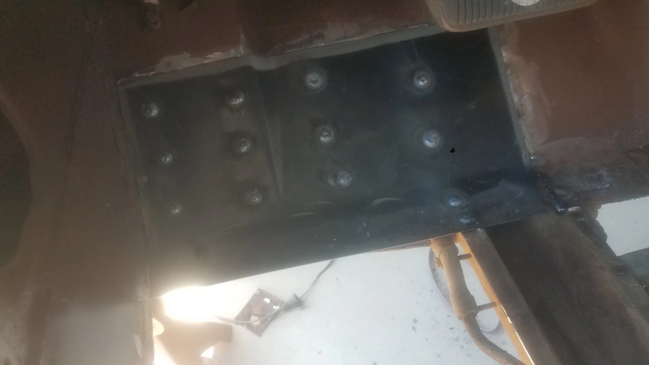

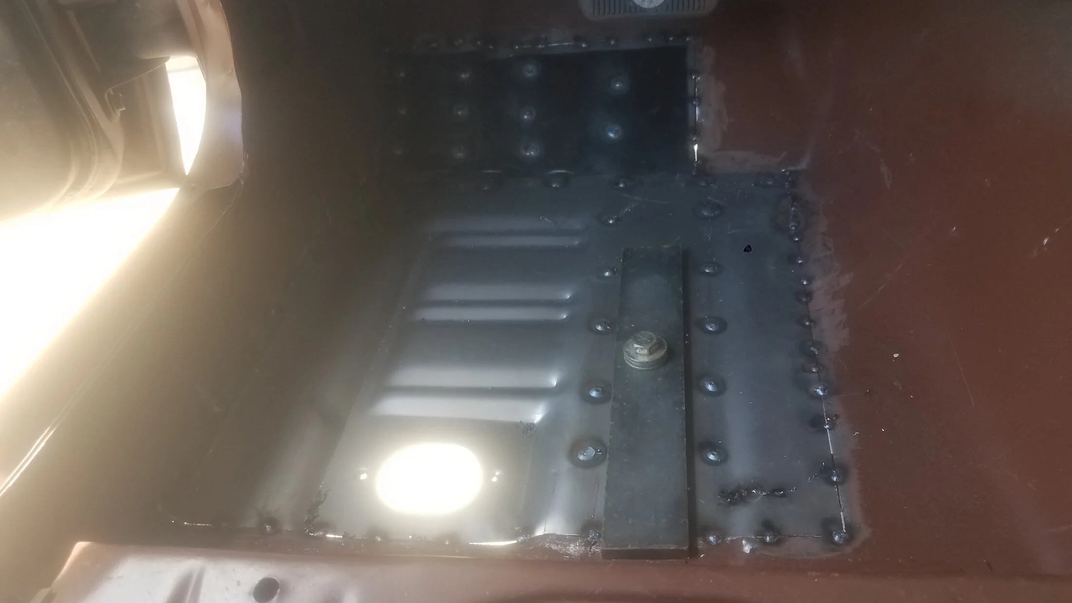

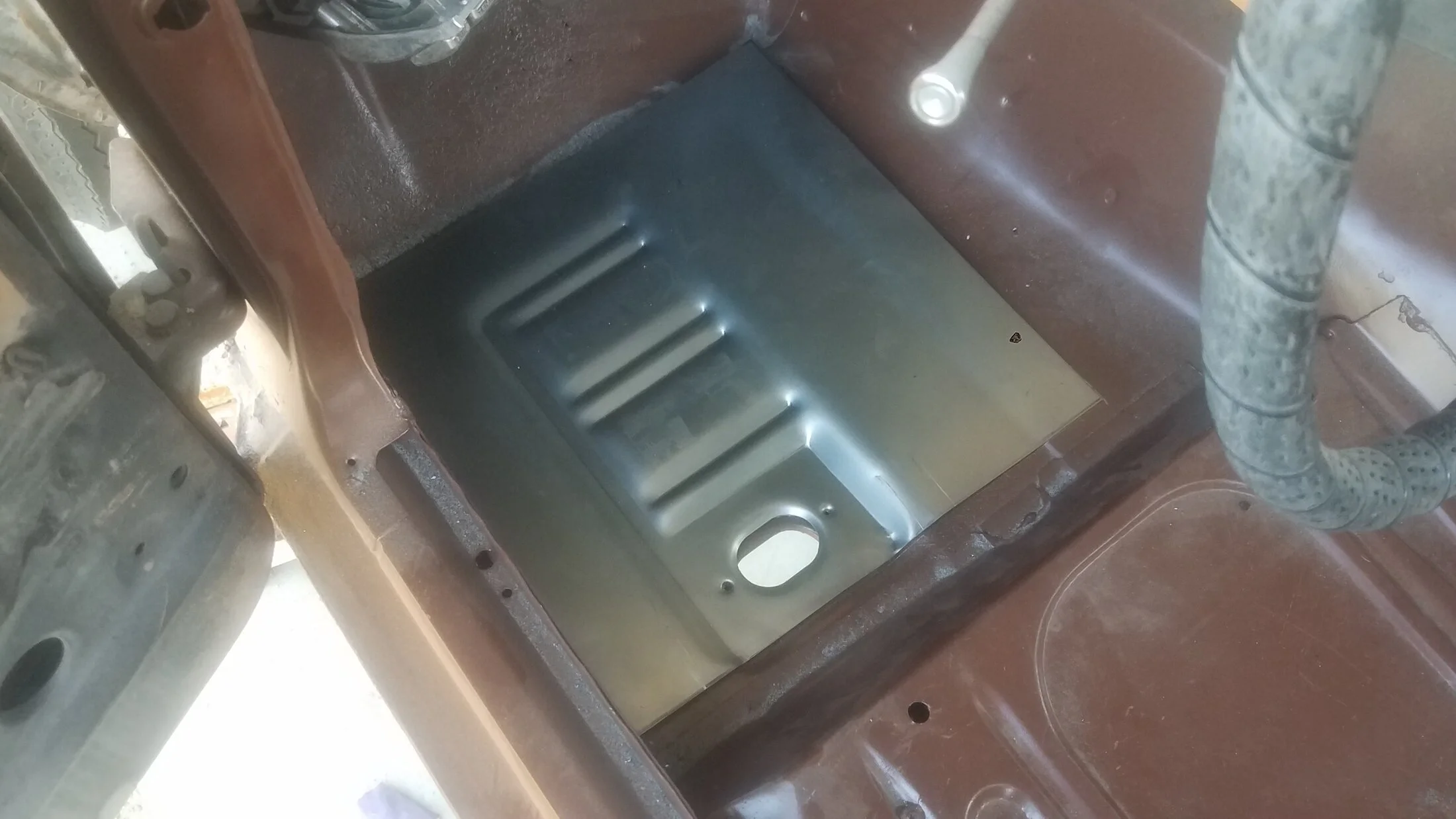

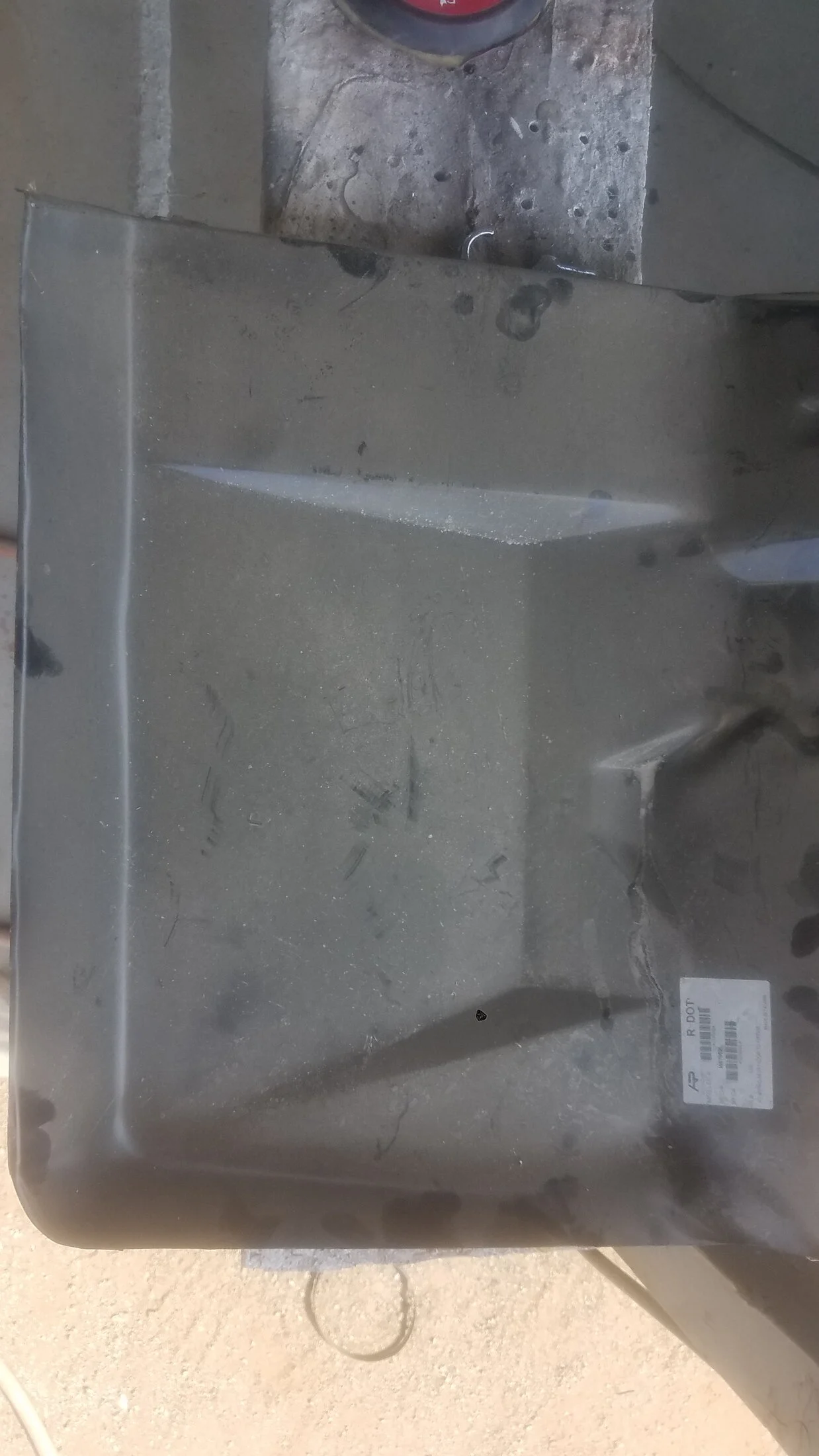

Got most of the interior brackets in today with a bit of welding it still needed. The floor patches are trimmed ,just need to cut out the floor.
All that should be left is the front apron patches and radiator support . Hope to have it finished by the week end .

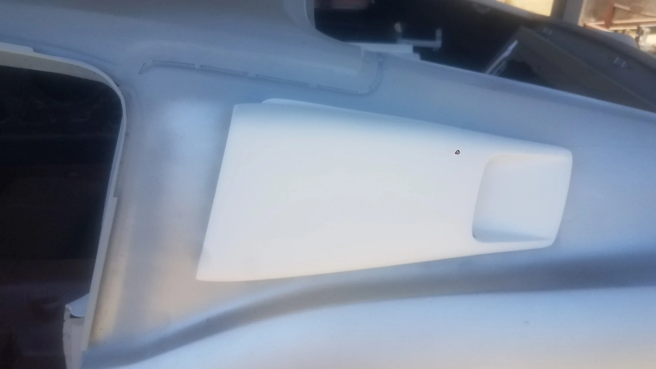

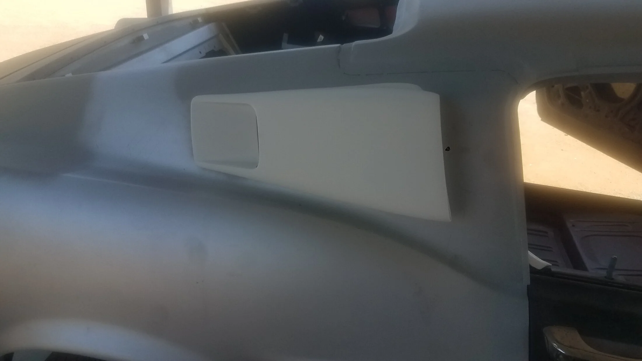

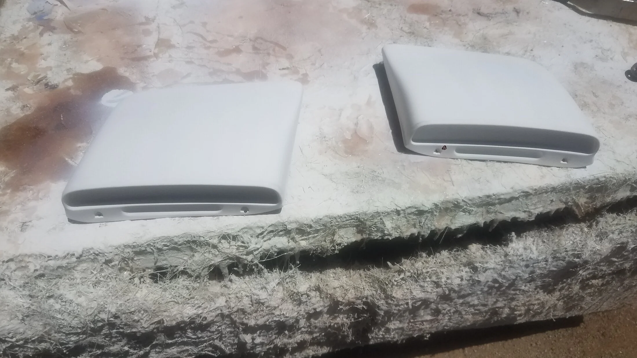

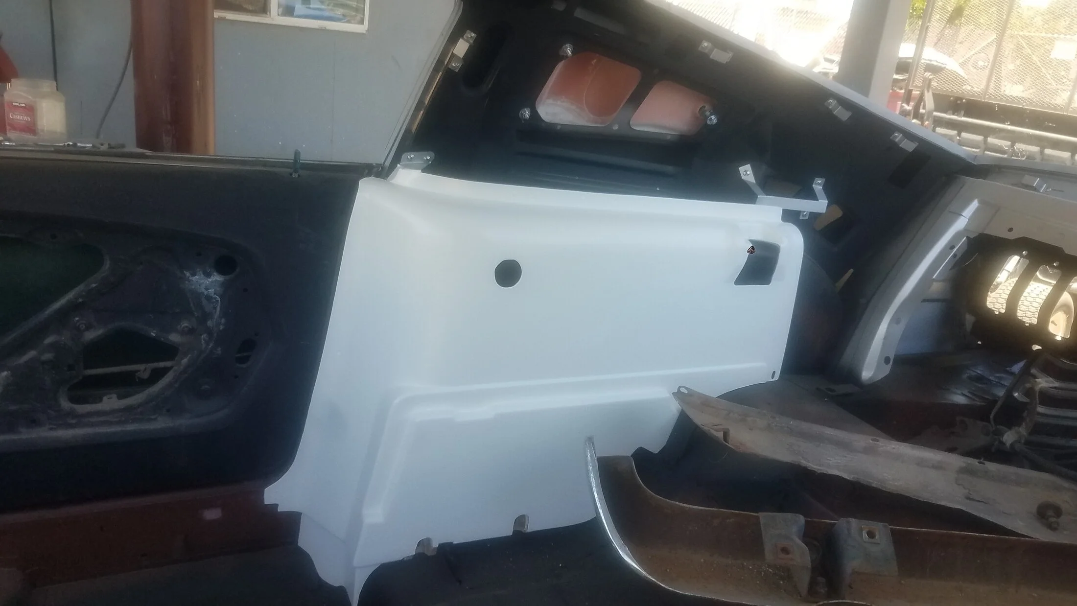

I have been waiting for 3 weeks now for fiberglass supplies ! I need to make the upper scoops and the big interior panels . I was messaged that it will be here this evening but i have heard that a week ago . Guess i have to find a new material supplier . If it does make it tonight i should have the pieces made late tomorrow. Its getting hard to get any supplies lately !

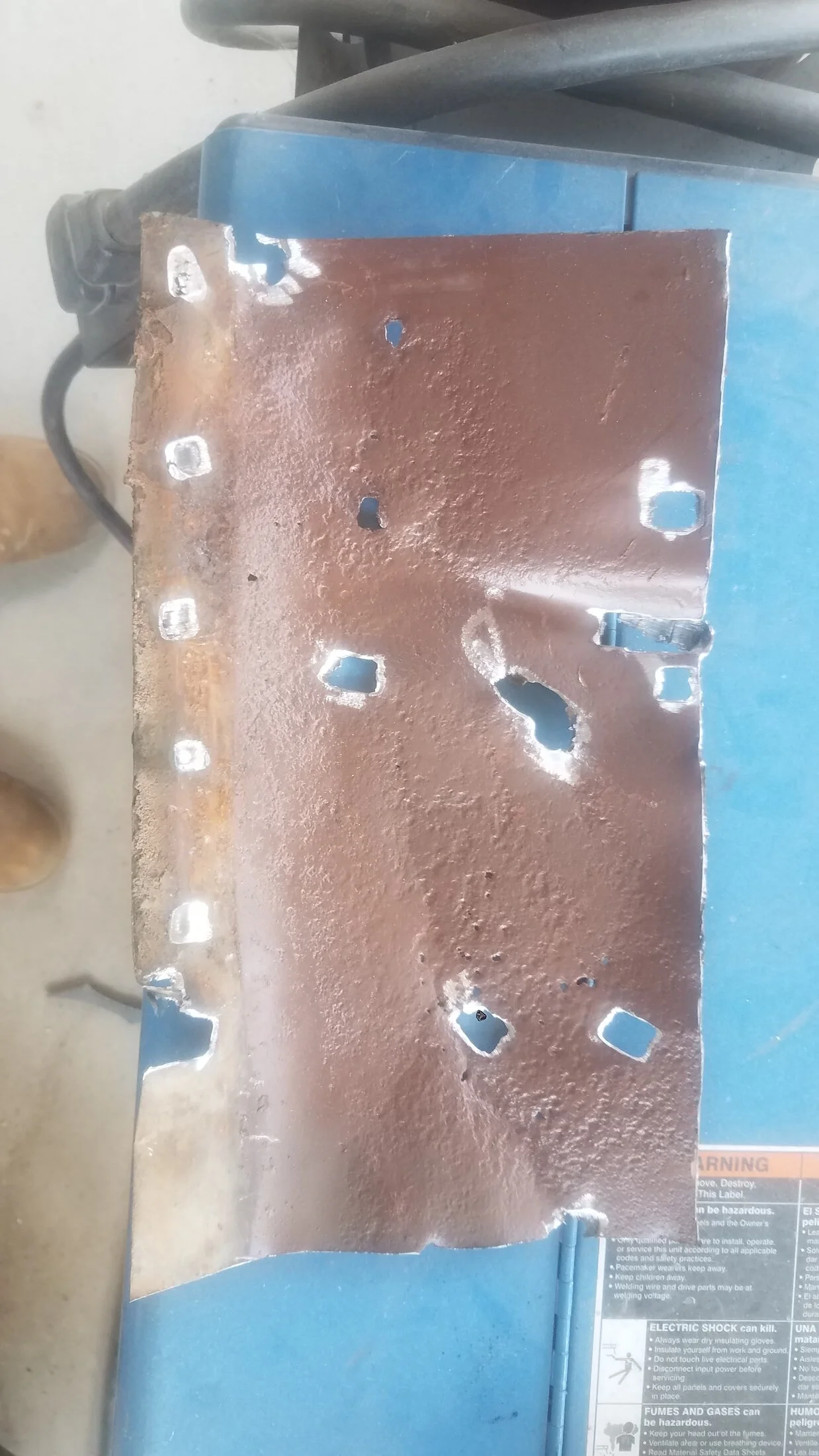

Jim, post #67. I like your flat bar idea. We still haven't dragged out our old PanelSpotter to try to get new tips for it. We were discussing dipping the tips in some kind of paste flux before each weld. When we parked it, the tips were getting half welded to the sheet metal part.

Also, I like the looks of your fastback rear interior panels. I'd like to talk about them more in the future. Keep up the good work!
The spot welder actually worked quite good ,the only problem is it weighs around 30 pounds and after about 50 welds its all i can do to hold it up .it didnt seem to stick on the body panels like it did on the small pieces of sheet metal .
The interior panels were made from molds taken from a 60,000 mile un touched GT i had ,they are just about perfect with correct graining .
