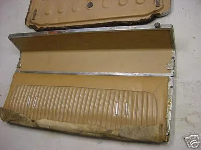

Check out this picture I boosted off ebay. THe part you are trying to remove is in the top of the picture. THis is a view from the bottom, looking at the rear edge. You can see the clips that I was refering too. Lift the front edge up and pull it towards you like I said. Should come right out. In fact, this is the only way to get to the bolts to get the rest of the fold down seat out. But you should not need to do that if you are only trying to get to the shocks.

Thanks, I'll check it out. The picture is just as I thought the piece would look like. The four screws would be the little oval/oblong foot rest for the seat back? Correct? once the little oval pieces are removed that will give me access to the screws for the spring clips, correct? I tried prying up the panel but gave up after I felt resistance, I was afraid to break something. So what have told me makes sense. I suspected there were screws under the footrests but wasn't too sure.

TOtal of six screws. Four holding the foot stop brackets-two each. And two at the front. One on each side. Buried in the carpet. You cant see them cause they have been there so long, the carpet pile has "washed" over the heads of the screws. FInd these two screws. THese go down into the hinge/bracket for the front part of the fold down seat. THe clips you see in the picture are at the rear and are held in by one screw on each side at the rear. You have those out. Get the front ones out and you can then lift up the panel and slide it out.
