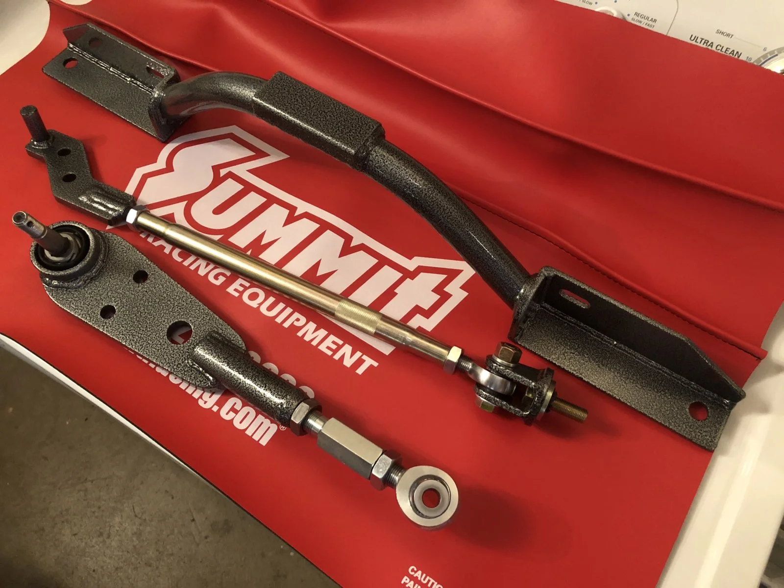

If you're on a budget, contact Pacific Thunder Performance Engineering for the lowest priced HD bearing strut rods and LCA's I found, but be forewarned, he's a one man band, fellow classic mustang fan, and he builds in batches. His website often says 'sold out', until enough orders are in, then he makes them. Great quality products, nice powdercoating (my optional color shown), chromoly rod ends, all hardware included. Below is his HD lower crossmember that also includes camber lockout plates in the hardware kit. I am no way affiliated, just happy to find someone that makes affordable replacements. Here are parts I've purchased from him:
