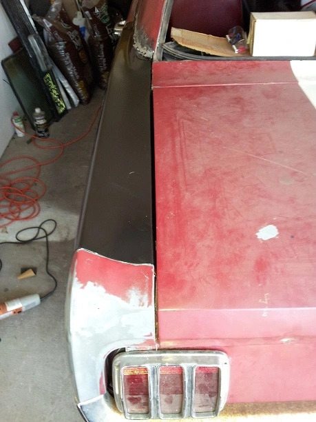

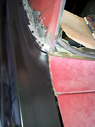

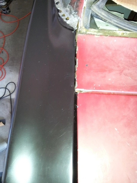

Upon test fitting the panel I just cannot seem to get the gap flush where it meets the piece right infront of the trunk. The best I can seem to get it is about 1/8th an inch or so. Everything else seems to line up okay except I'll have to massage the door area at the bottom as it scrapes the door when I push it flush with the rocker panel.
I'm not looking for a show car as this will be driven to work everyday, but am definitely curious if this gap is acceptable or if there's any suggestions on how to get it flush? This is a dynacorn panel I got from CJponyparts.. and knowing that not all panels will fit perfect I kinda expected this area to line up flush.
if you dont have the panel welded in place yet take it back off and dolly the piece flat at the back window and grind any metal like spot welds or any other metal flashing that will not let the panel close up the gap. clamp it together from under side you should be able to force the quarter back enough to make the door gap and the back window area line up. some times a sheet metal screw will hold things in place
you are doing great so far. you may want to check the door jamb were the quarter over laps as well .make sure its as flat and straight as possible it will make the quarter that much easier to fit.if the quarter still will not go back far enough you can push the outer edge of the door jamb back a little:nice:

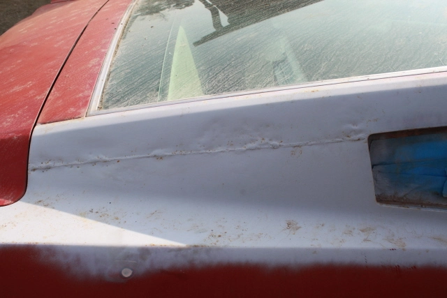

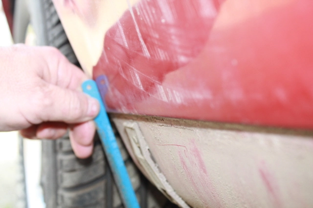

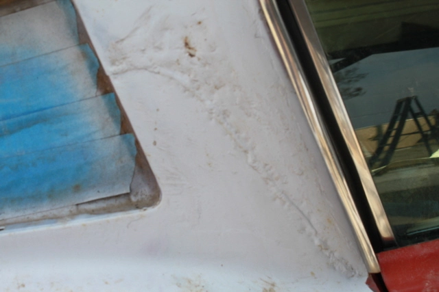

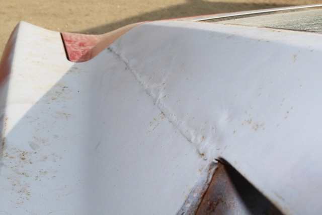

a friend of mine just asked me to do some work on a 68 fast back for him.it has had a quarter replaced several years ago. i thought you may want to see what a truely nasty repair looks like. instead of replacing the full quarter they cut it at the rear roof area and torch welded the new one in place, overlaping the panels. the lower portion that meets the rocker over haings almost 1/4 inch. the welded area at the top is so warped and disstorted that to me it was a waist of time and sheet metal, they just plasterd it with bondo. nasty nasty:nonono:
Yeah I appreciate the pics and all the help, im still having a hard time with the door gap and lining up at the bottom. I took the panel off to finish prep work and im hoping to get things done by Saturday so I can start lining it up and welding it in. Is it easier to sheetmetal screw the door area and get it lined before lining up the rear?
