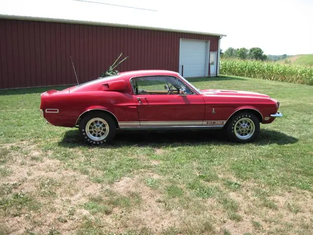

I want to paint my 66 mustang a dark red like the pictures below. I believe this is candy apple red, but as I've searched the internet I've noticed that once the paint is on the car there are many different shades/hues of Ford Code T Candy Apple Red. I want the dark shade that looks like dark red even in the sunlight.
So my question is how do I get my car's paint job to look like the cars below? Dark red even in the sunlight. Is it the brand of the paint, a different color than code T candy apple red, or the way it's painted? Thank you.
Thanks. Any other suggestions on how to find that color red in the pictures where it doesn't change much in the sunlight? The fastback above turns a much lighter red when the sun hits it.

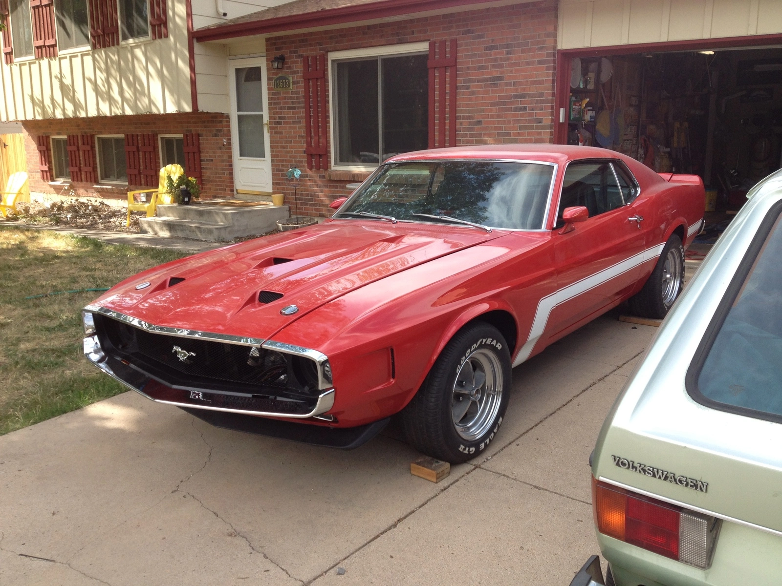

that color changes in different lighting ,in bright sun light it looks lighter . just going from one side to the other looks different . one of my favorite ford colors .i have owned a few candy apple /t code cars. a clear coat realy brings out the color
both of these cars were candy apple red. the white stripes make the 65 look lighter than the 70 with black stripes especially in bright light .it tends to look darker without stripes or with black stripes.

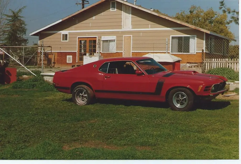

You have to be very careful with photos. If the 70 you posted had been properly exposed, it would look more like this.
