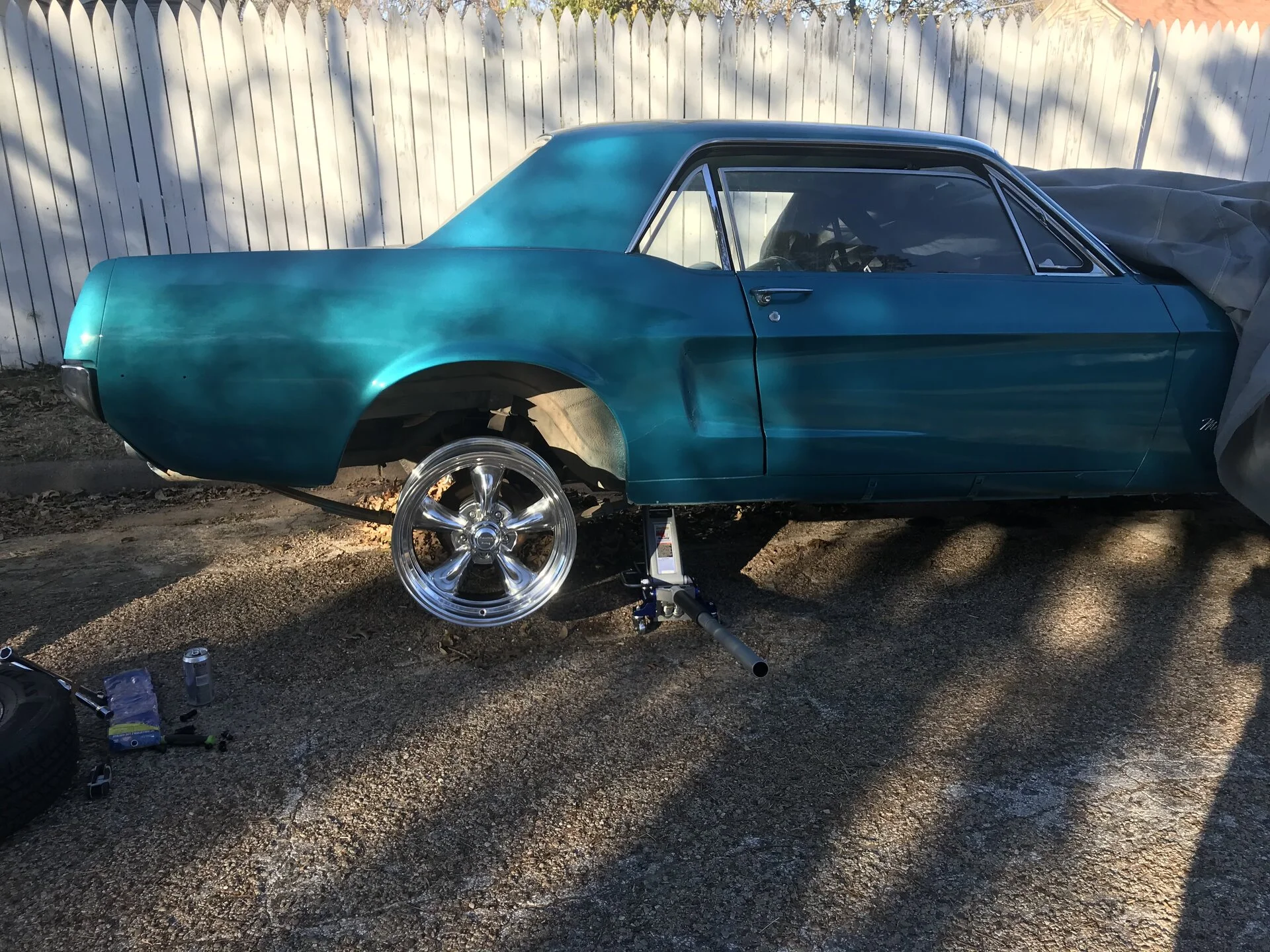

That’s the whole reason I’m doing the swap, to be able to run the wheels I want (17x7, 4.5 backspace) With adapters, they are about an inch out of the wheel well, so I can deal with spacers
