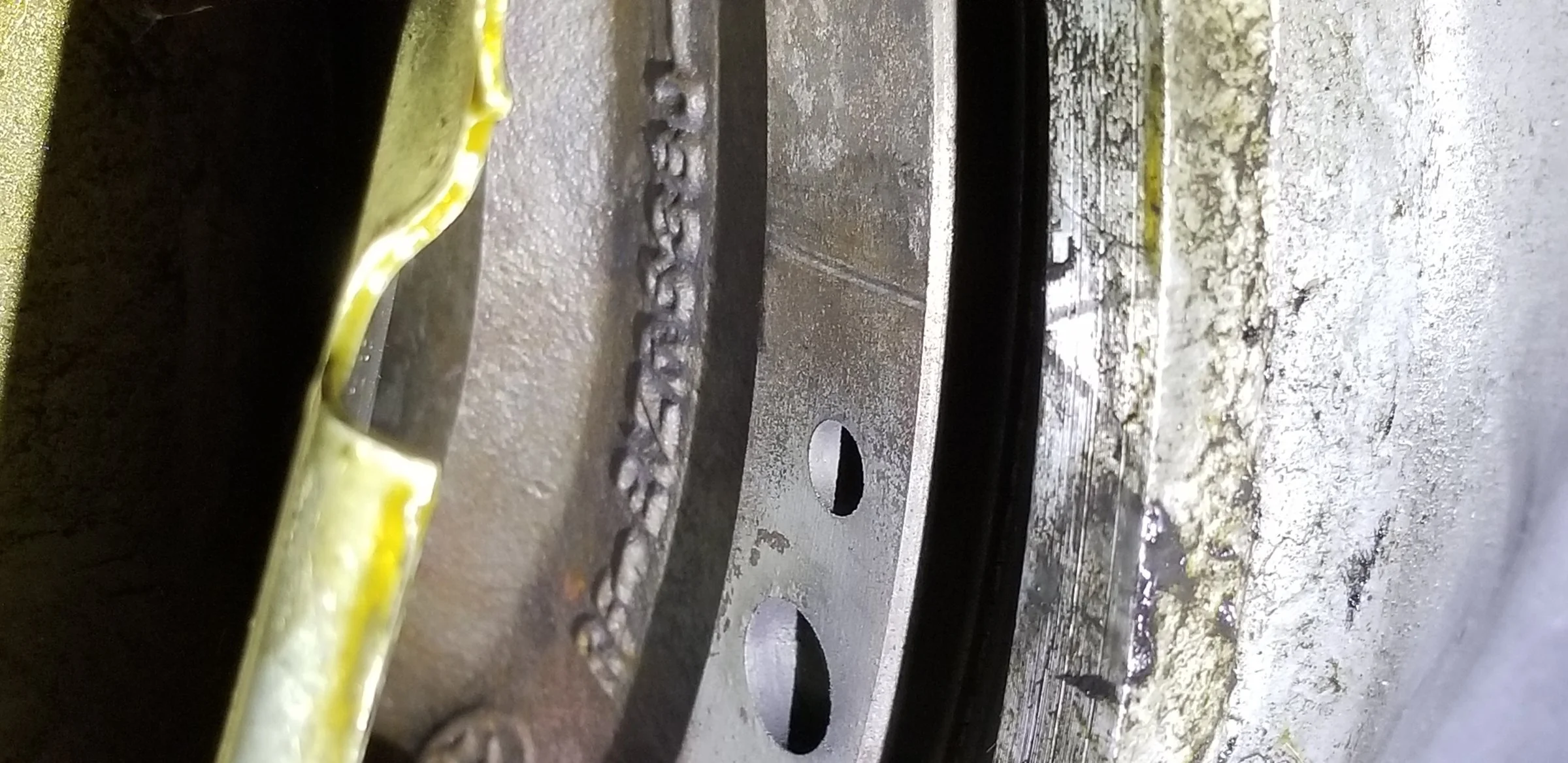

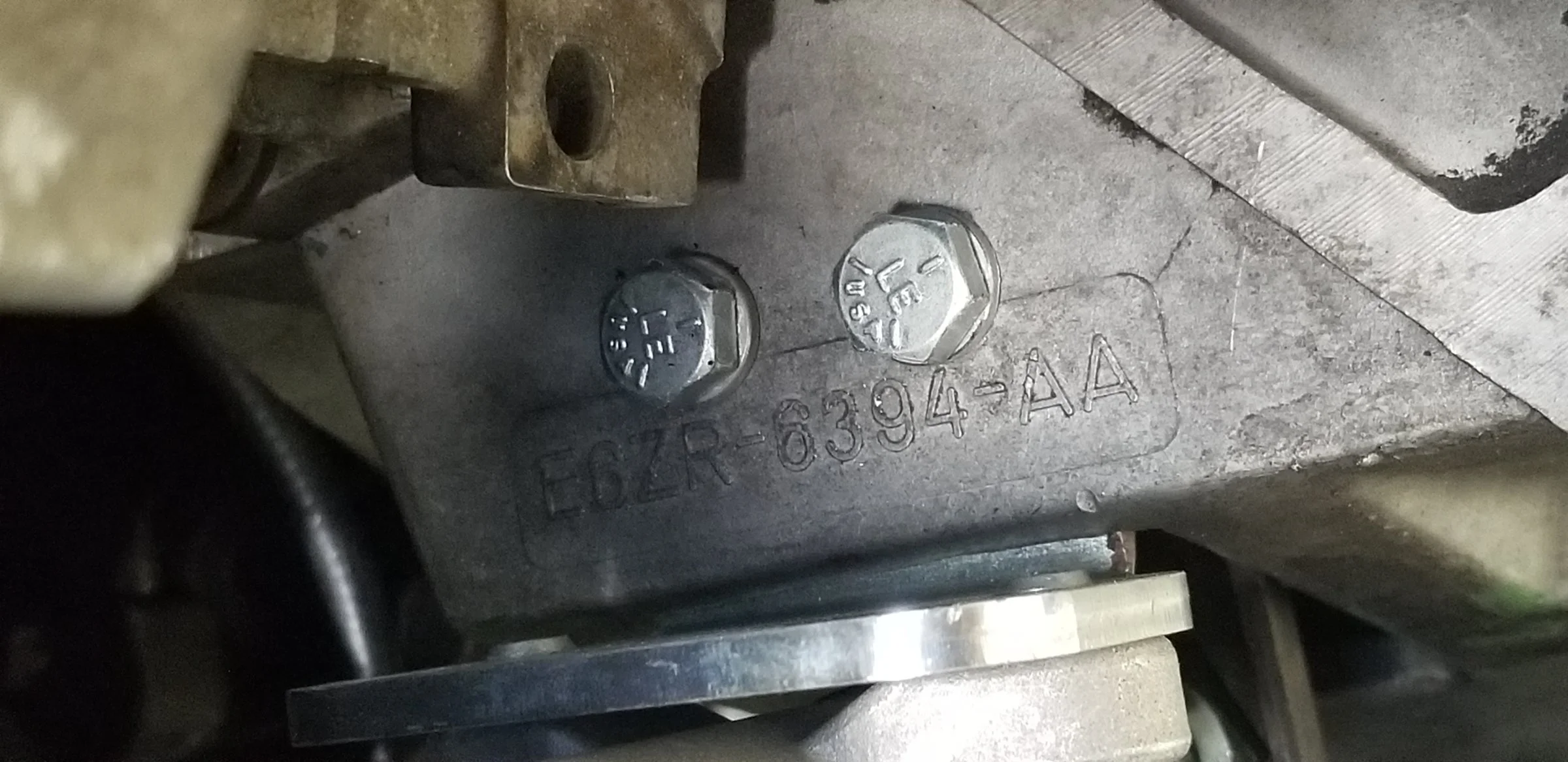

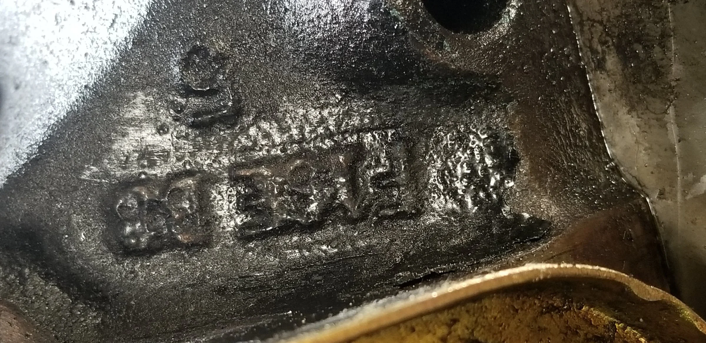

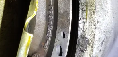

Hello everyone, I recently purchased a 66 mustang that has had a 90-91 302 engine installed. There is some very heavy vibration felt in the car at 2000rpm and higher - even while in neutral. I've been told not to drive the vehicle as this shaking will damage the engine. Ofcourse the seller who sold me the car never mentioned this issue and I just thought it was how a old classic feels. After doing some research I have found out that either there is a wrong harmonic balancer or flywheel installed. In the worst case I may have a bad engine. I have gathered all the serial numbers off the engine (F16E) the serial number off the harmonic balancer (E4TE-A3A) and the flywheel (RF-E1ZR6380.) I also attached pictures of the serial numbers just in case I am not reading them correctly lol
If anyone has any knowledge about this vibration and can help that would be so greatly appreciated. Im hoping the harmonic balancer or flywheel is not correct and that I don't have an engine rebuild ahead of me. Any ideas?

I am using a brand new harmonic balancer and flywheel both rated at 50oz. Ive replaced the clutch and driveline as well.
YET still excessive vibration. Some machine shops are saying I need an engine rebuild, while another shop told me they can almost guarantee its not the engine and to keep looking at what "additions" could be causing the vibration.

Without knowing more specifics, I wonder if your balancer and flywheel are correctly balanced to the engine. The part number dates decode 1981 for the flywheel, 1984 for the balancer, and 1991 for the engine block. I believe that they made the switch from 28oz to 50oz balance in 1982? If that is correct, and assuming your crank is indeed the original crankshaft for that block, your flywheel may be incorrectly balanced for the engine if it was not previously rebalanced. I would inspect the flywheel a little more closely. This, of course, is also assuming that there is nothing mechanically wrong with anything else, i.e. no loose bolts or anything anywhere.
