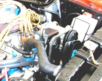

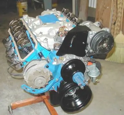

I reused the stock bracket with some mods done to it.
The sanden comp is smaller and lighter but I didn't like the way the idler bracket attached to the pump.
With cutting it down and making my own mount, I have more room to the dist and water outlet.
Just take your time and line up the belt/pulley so it won't fly off at 6k rpm. :D
