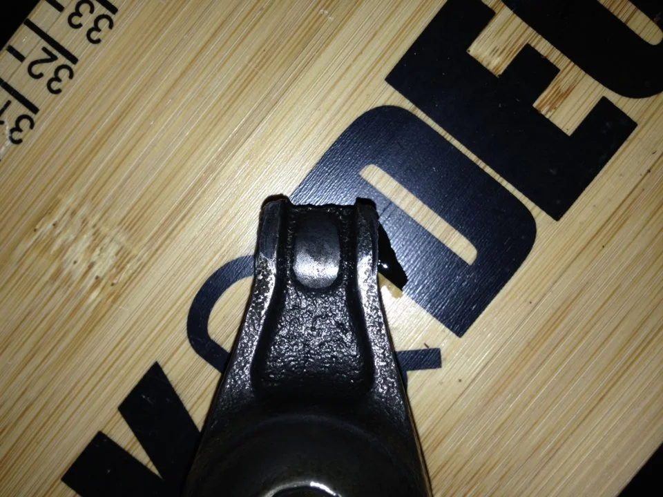

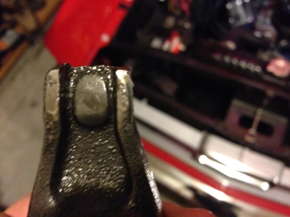

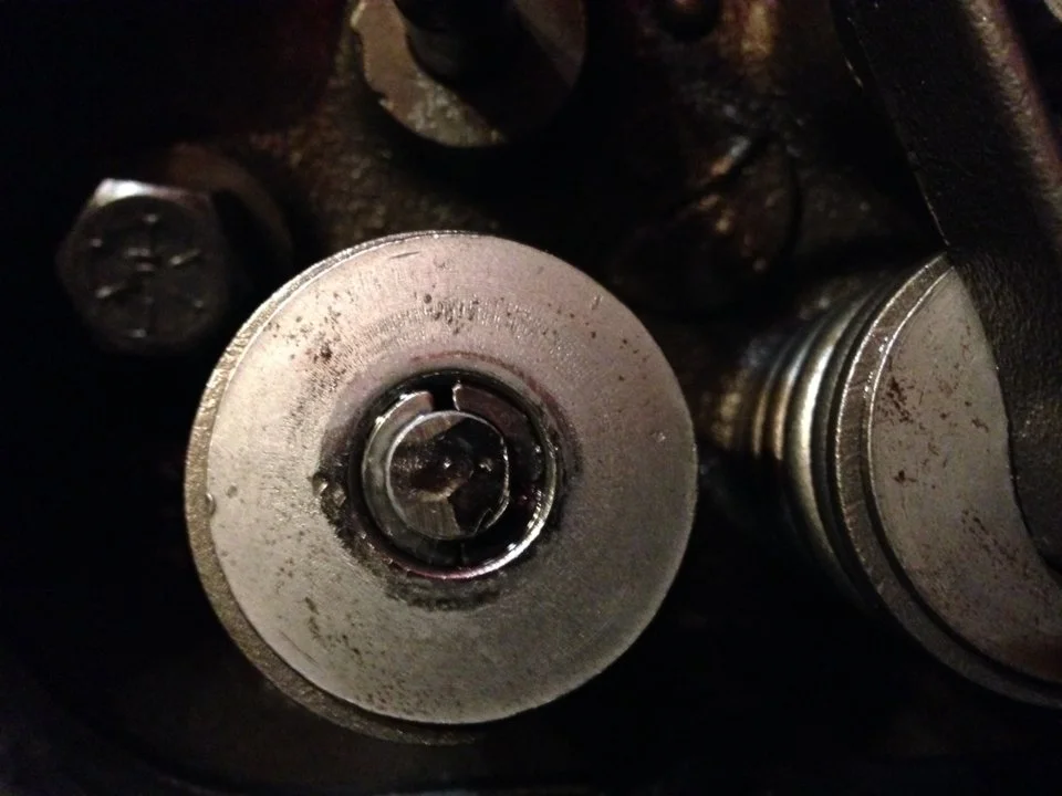

I pulled the valve covers and removed one of the rocker arms to take a look, it appears that I have a very large wear pattern that nearly swaths the entire valve stem. I have pretty much decided purchase a measuring device from comp, measure what I need then purchase hardened pushrods. Attached are pictures of what my situation looks like. You may or may not be able to see what I am referring to after the upload. If I go 0 lash at 0 lift with the engine cold will that give me enough of a measurement to purchase the rods or do I need to pull out a hydraulic lifter and replace it with a solid lifter to get my measurement. I would rather not pull off the intake but will if needed.

What ever pattern its leaving should be centered on the valve stem. I guess I thought you had roller rockers, they would leave a more confined pattern but these stock rockers are a lot more forgiving when it comes to push rod length. I would still blacken them up somehow on the valve and on the bottom of the rocker just to see it clearer.
A couple things in your pics concern me though. It looks like the valve is not smooth on top and it also looks like the rocker has a worn are off the side of it like it rubbing. Maybe these are shadows in the pics? The only contact should be on the valve stem and little pad under the rocker. See the edited pics Im posting.
I agree, its clear that it did rub on that shoulder, however, I think that may be due to the slop in the valvetrain. I did the test you mentioned by marking the valve stem with a marker, the pushrods appear to be the correct length, it left a nice mark pretty much center on the valve stem. I went through again and checked the valve lash, my method is outlined below.

Ok, sounds like you got the length resolved. Just make sure that your rocker where I circled does not make contact at any time. During operation the only contact should be the valve stem and the pad on the bottom of the rocker.

Looking at the photos, I think you are trying to mix incompatible valve train components together. The rocker looks like the rail style with the (I'm guessing) large push rod slot, while the valve spring side looks like the close tolerance push rod slot style that uses the conventional rocker arms. If so, you are about to drop a valve into the engine.
Realmongo is right. As I said earlier it looks like your rocker is contacting the valve spring washer. THis is probably the noise you are hearing. Those valve stems are too short for rail rockers. You might want to try conventional (early) style rockers. Here's a pic of some 289 heads I have for sale on Craigslist. Notice the stem height.

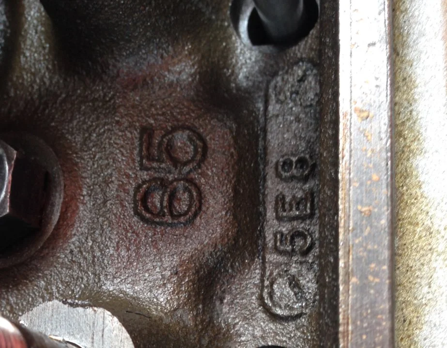

Yeah thanks again for the advice, I thought that my heads were the original 67 heads, but looking at them they have 65 stamped on them. I planned to use pushrod guides to keep them from walking off the valvestem. Picture attached.
