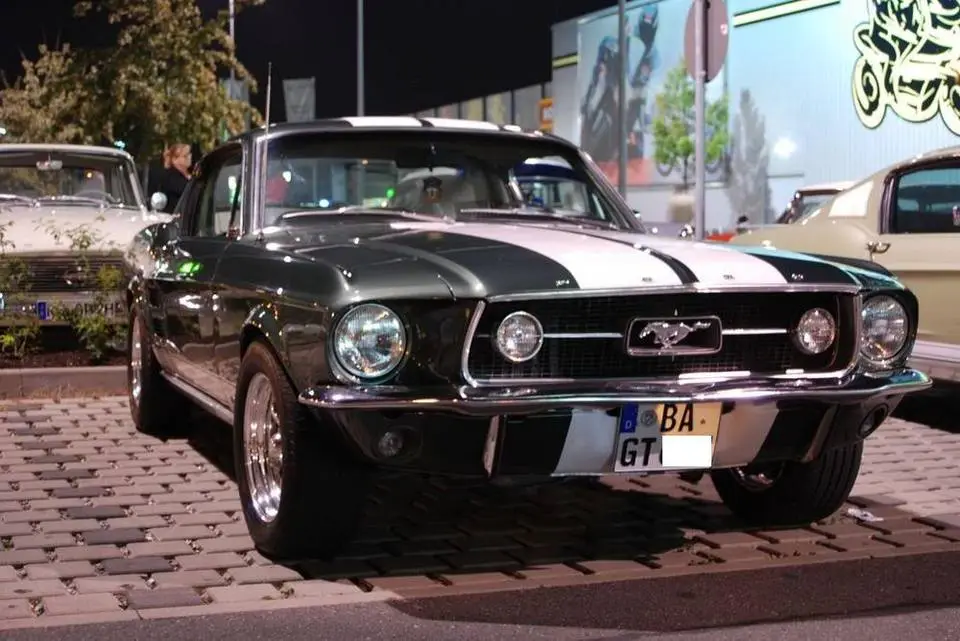

Here's my ride:

By the way, welcome to the board and your pic link isn't working for me..

JonK,
Too bad the link isn't workin' for ya, his car is GORGEOUS!:jaw:

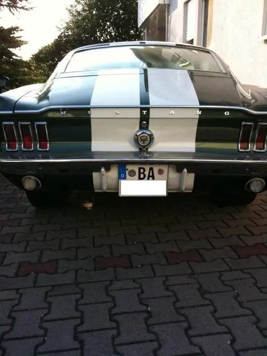

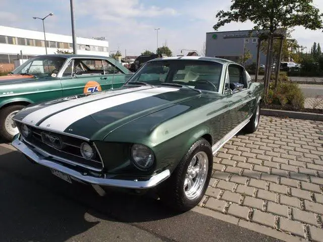

Thanks for the compliments, been a lot of work. I re-did the interior over winter, and am still working on a few issues. Here's a few more pics:
