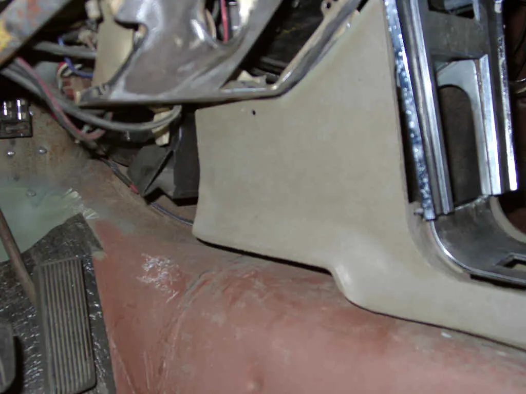

This picture is where I have loosely stuck a chopped 67 console in place. Notice the console butts up to the floor vent and the opening of the vent protrudes beyond the sides of the console. If this were an unhacked console the vent would prevent the console from sliding in place under the dash. So the picture/details that I am looking for now is what does the floor vent look like for an AC/console car? are the vents facing the firewall? or is it a very short piece that would go over the top of the console sides?

That looks right to me. The floor discharges of the heater do protrude slightly and point about 30 degrees down and 45 degrees towards the passengers, just like in your photo. I'm a bit confused though about why a "chopped" console would be so close to the discharge. Are you 100% sure your blower housing is from a 67/68 Mustang cougar and not perhaps a 69/70? That fitting with the discharges connects directly below the blower motor right?

The blower housing/motor are definately 67/68. The motor is original and has a C6 or C7 part number so I am quite certain they are original to the car as there is a fender VIN/accessory tag showing it originally with AC and vinyl top.
From this exercise i see how consoles could have been chopped over the years....all because of the floor vent...that I still dont know what is suppose to look like.
