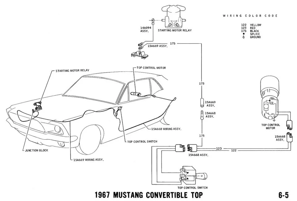

'67 Convertible top fuse location

Since nobody answered you, I will take a shot. First off, I don't know where it is on a 67, but I do know where it is on a 65 or 66, maybe they are the same. There isn't a fuse, it is a circut breaker, and it is bolted directly to the starter solenoid, this wire runs right to the power top motor.
Sorry...I missed this post earlier...here ya go bro...
I see no fuse (?)
