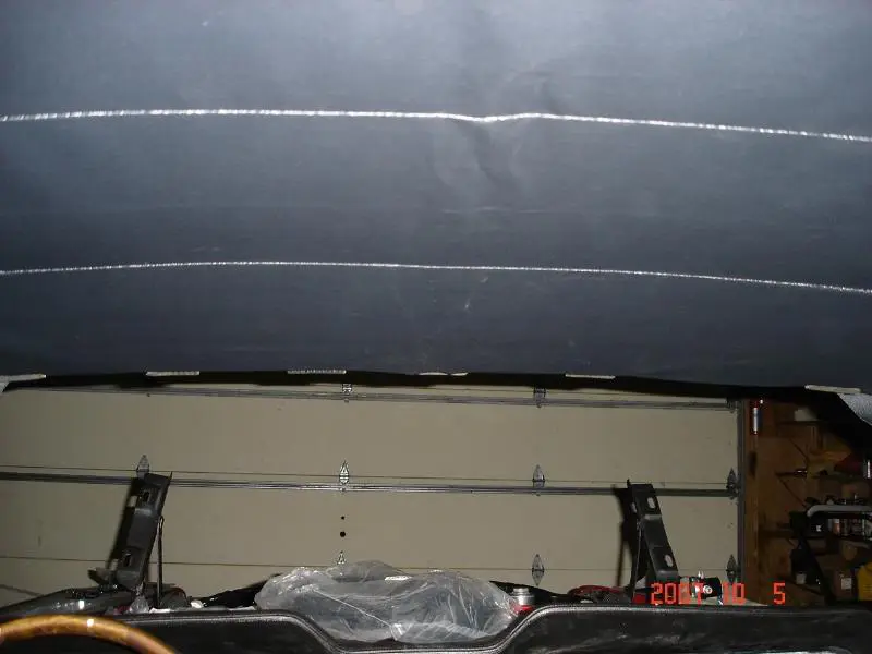

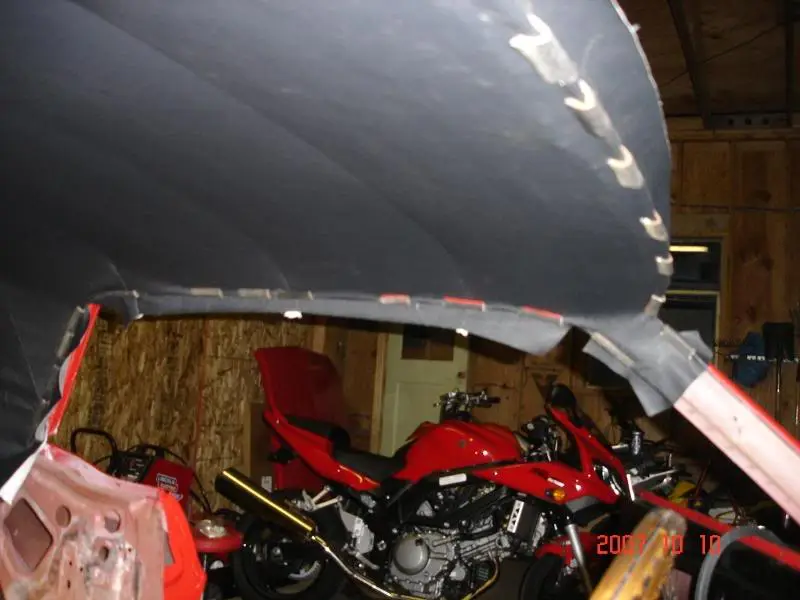

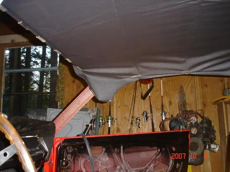

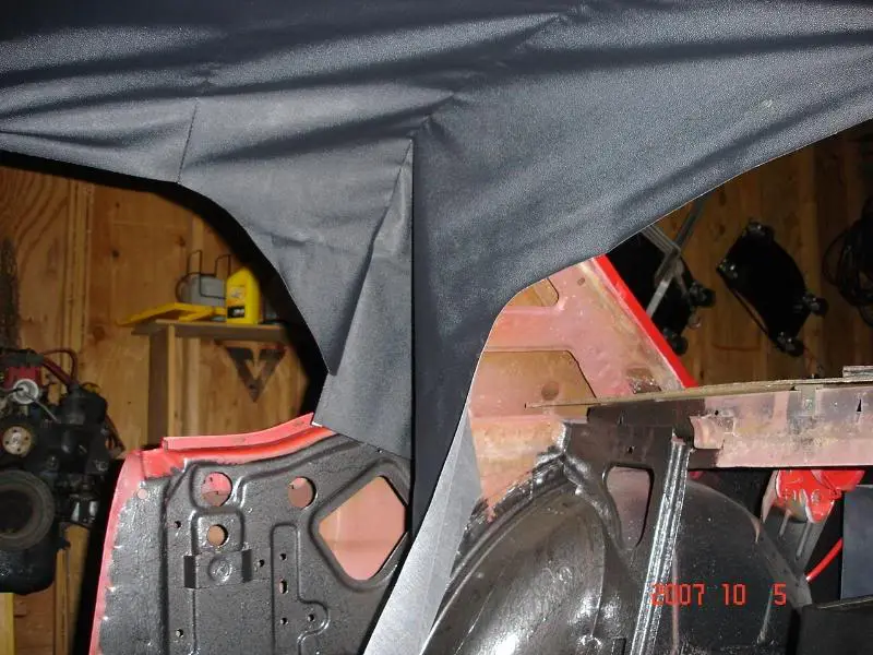

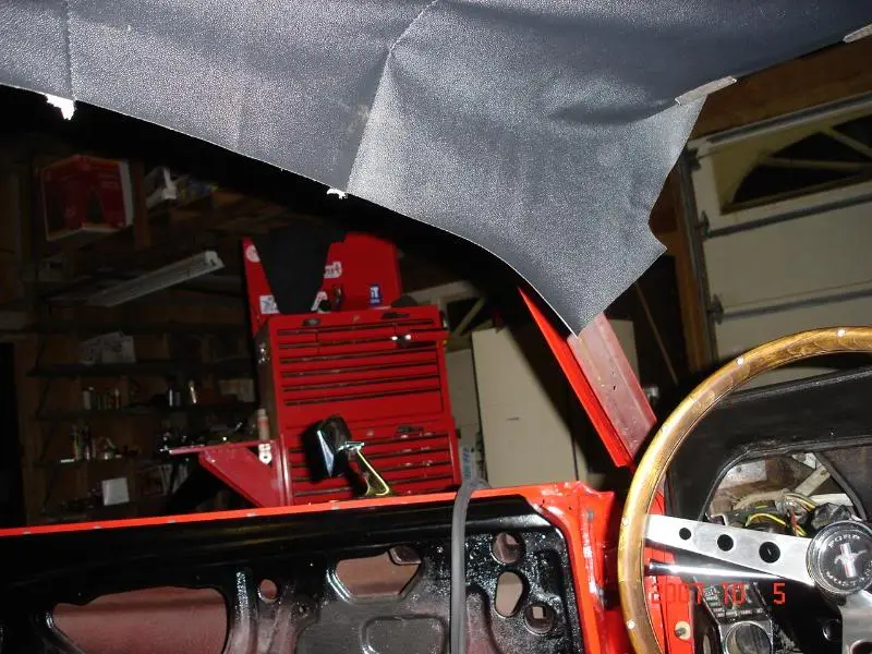

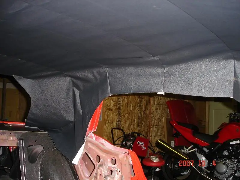

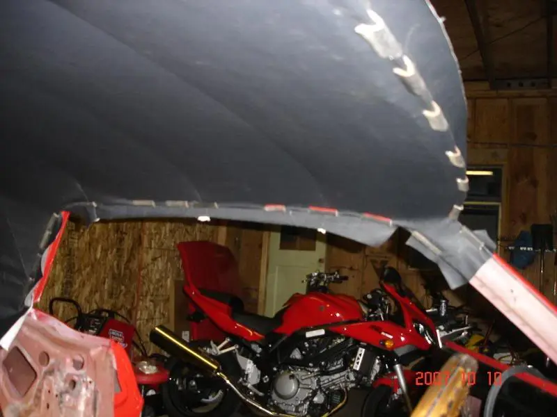

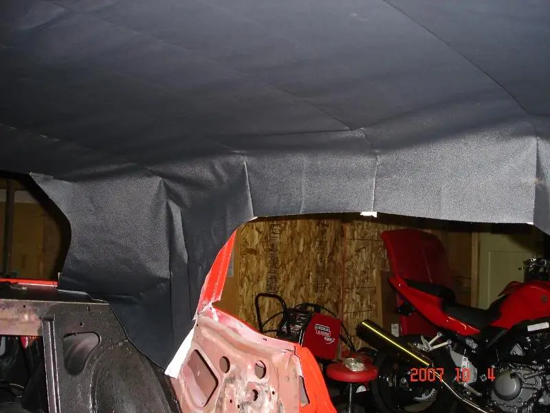

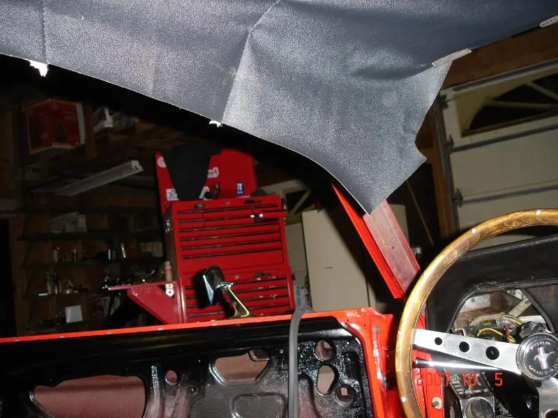

I did snap a couple photos as I quit and grabbed a beer, as I was afraid I was getting too angry to work it. lol I see looking at the photos and a little more calmed down now, I just need to go ahead and start doing some trimming in the corners and get a buddy to come over and be my counterpoint to pulling and stretching. It just is too much of a pain with one person.
I am sure that those of you that have done this before are probably laughing at me. :nice: I don't blame you, definitely a learning experience so I am still glad I am doing it. If it takes me three headliners I will get this thing done my self!!!! :lol:
None of this has been heat gunned yet, I figured I would get it as tight as I can and set, then start trying to get some of the wrinkles out and finally glue it in place. Always fun, when you are in Washington State and it is only 50 outside.

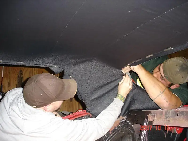

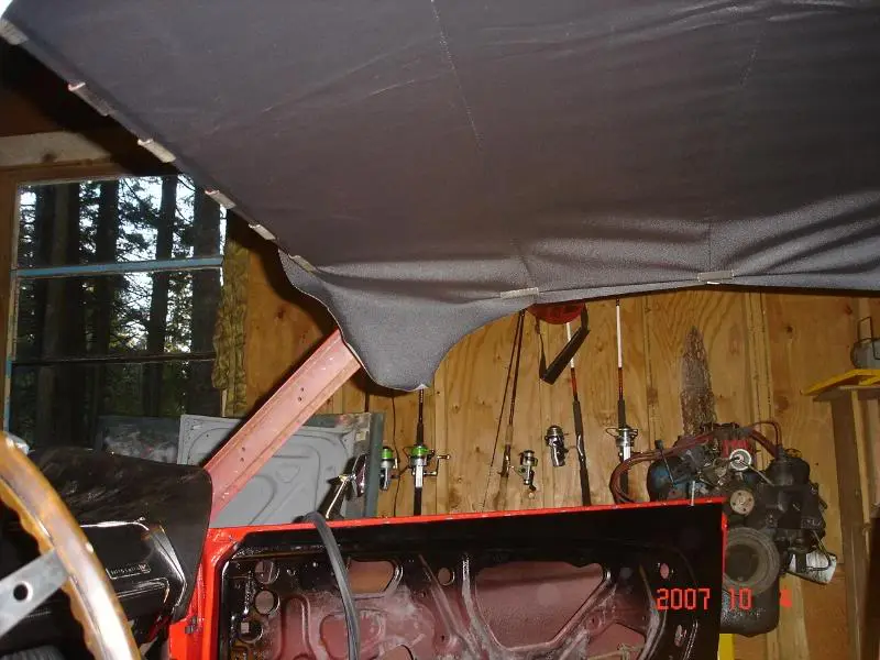

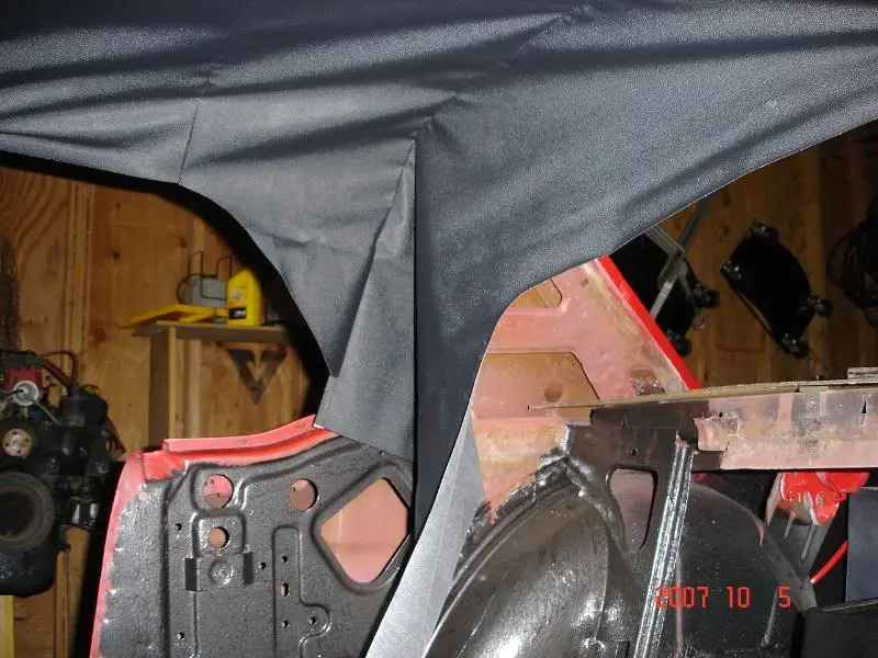

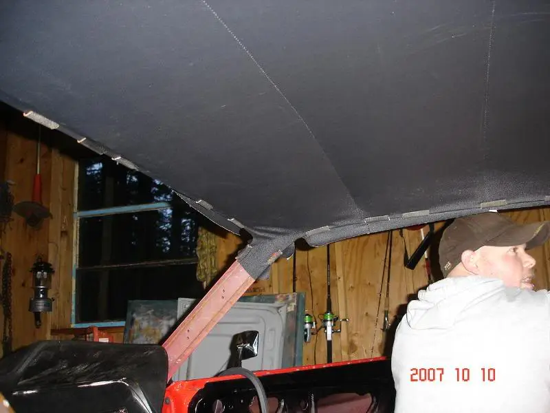

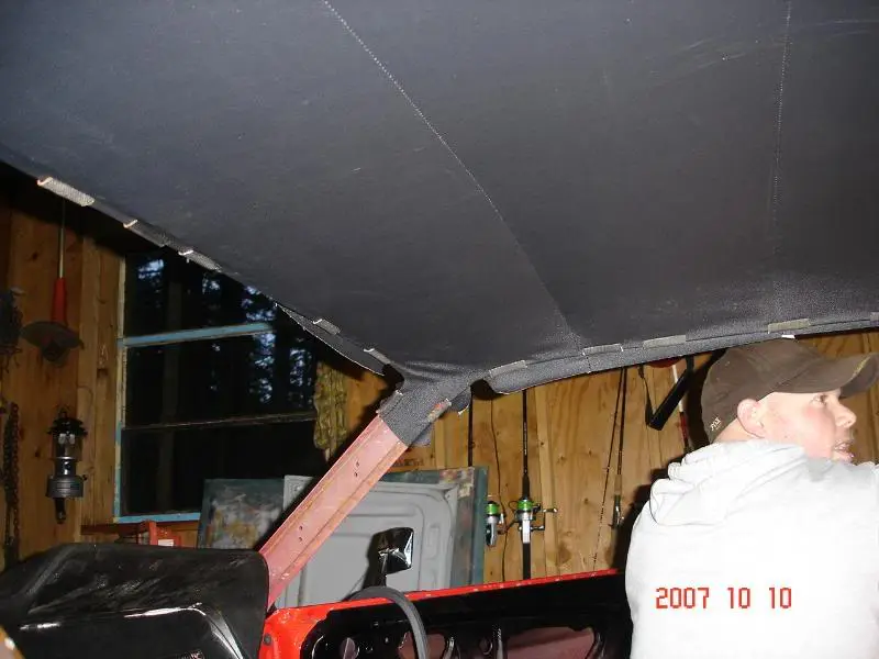

I finally gave up on trying to do it alone. It is doable, but I got so tired of running from one side to the other only to find out I needed to go back to the other side to fix something, that I said screw it and bought the beer and invited a couple buddies over to lend me their hands. :D
If you try this alone you are a better man than me. I would HIGHLY suggest having some other hands involved. Here are some photos of where it is now. Suprisingly easy with helpers to hold and pull and even a third set of eyes to look while we were holding and pulling. I only made six cuts on the entire headliner so far to get around the pillars.
I am hoping to glue it all in place tonight. So wish me luck! :rolleyes:
