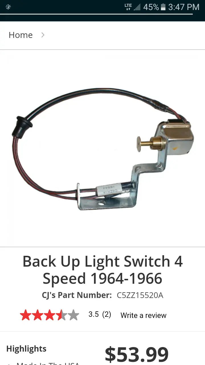

I have a 67 Fastback that was converted from an automatic transmission to manual. Problem is, there is no activation for the reverse gear lights (white) and I can't pass the safety check until this is rectified. How do I add an automatically activated switch for reverse gear that will turn on the reverse gear lights? Is there a kit for something like this?

It bolts to the shifter body ,when you shift into reverse ,the arm on the shifter pushes the plunger and turns on the back up lights.
