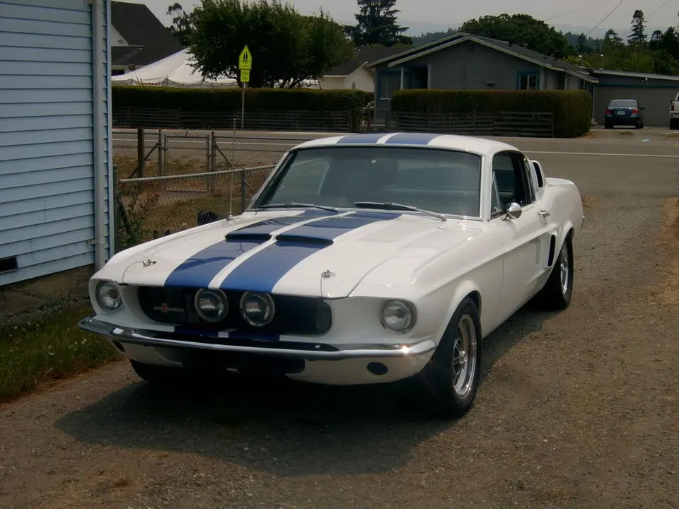

Thanks for the compliments Mike, I can't begin to describe how it feels after 6 years of garage-therapy. The pic I posted was taken a few minutes after the Highway Patrol left! It was Sunday and I had just gotten the car licensed and insured on Thursday, but the DMV hadn't entered it into the computer, so when the cop who followed me home ran my plate, it came back as unlicensed. I showed him the registration and explained the whole thing and he was cool about it, and had to check it out before he left. Since these pics I put the front signals on as well as the "GT 350" rocker stripes. Oh, yeah for you and anyone else who's thinking of building a Shelby clone GET YOUR EMBLEMS AND STRIPES IMMEDIATELY!!! According to the Branda salesman I spoke with, Shelby won his lawsuit and very, very soon repro emblems and stripes will no longer be sold to those of us building clones, only original Shelby owners will have access to these things. I assume you'll need a vin# of a real Shelby to buy these parts. I'm buying spares of everything next payday, just to be safe. I've put a little over a hundred miles on it since it's been done and every time I get out of the car with an ear-to-ear grin. It's worth whatever it takes and whatever it cost.
