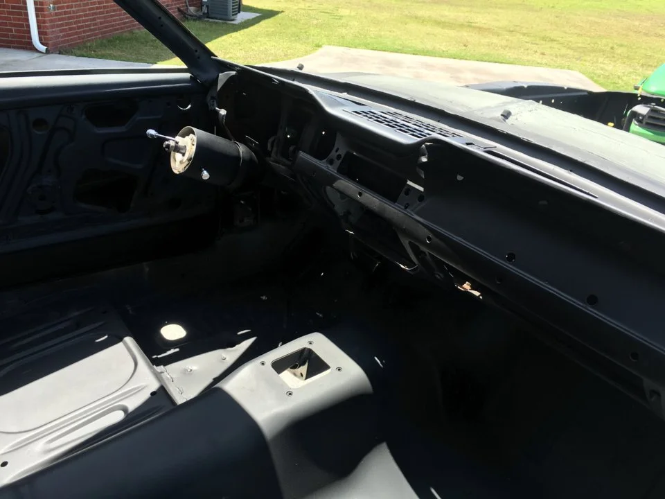

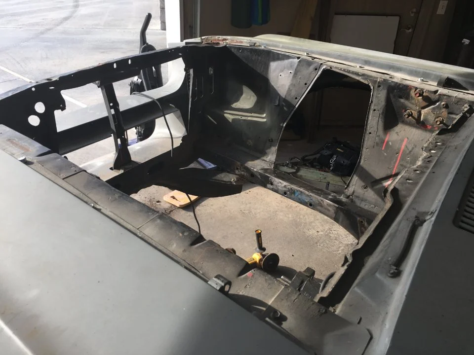

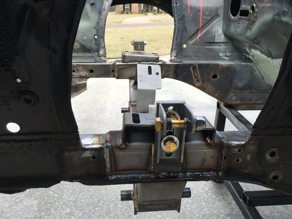

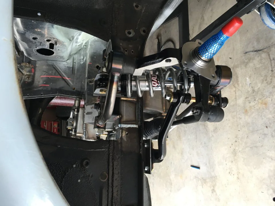

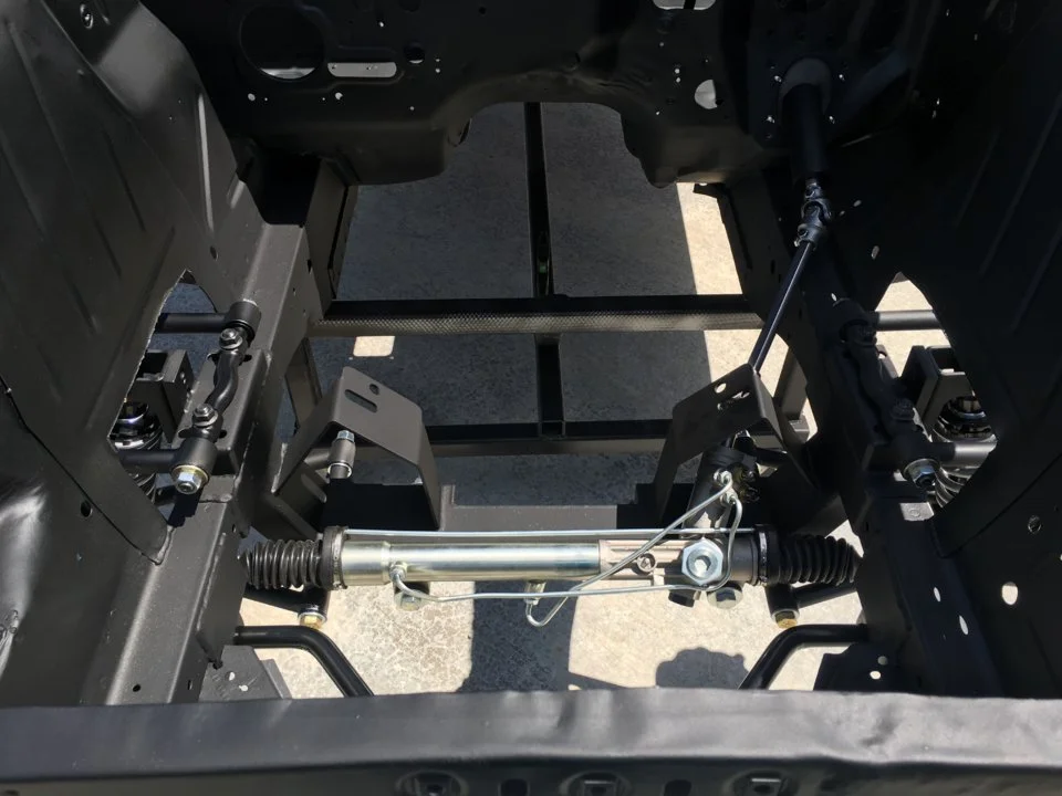

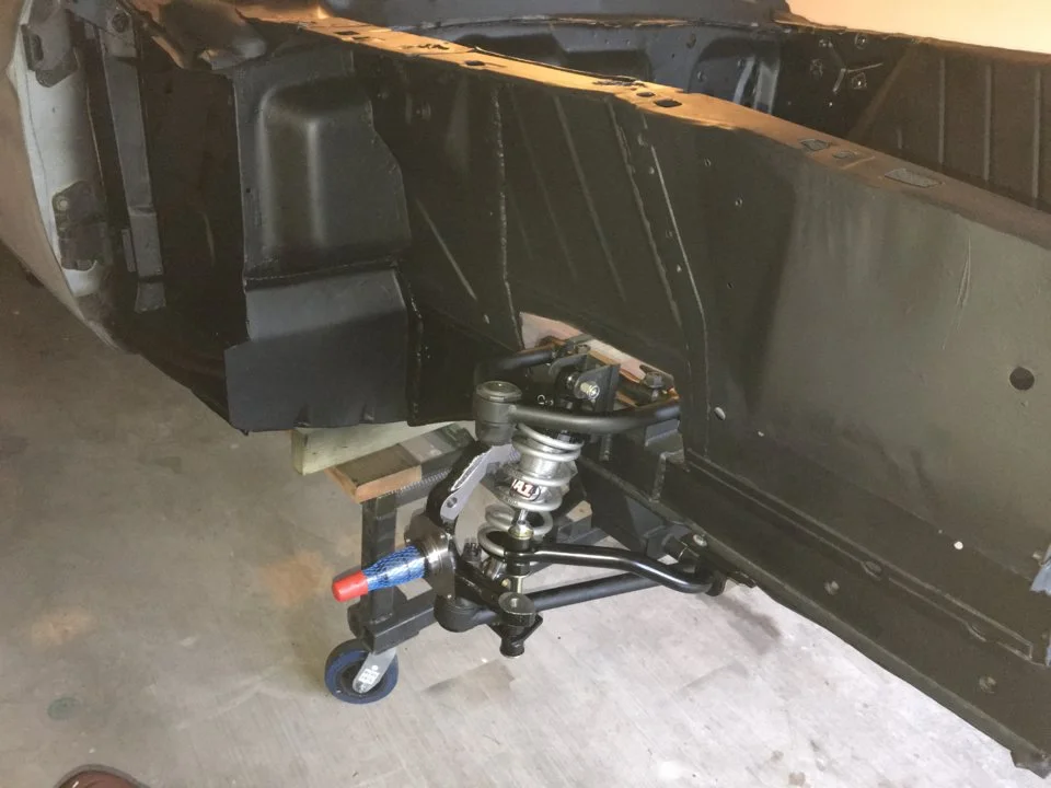

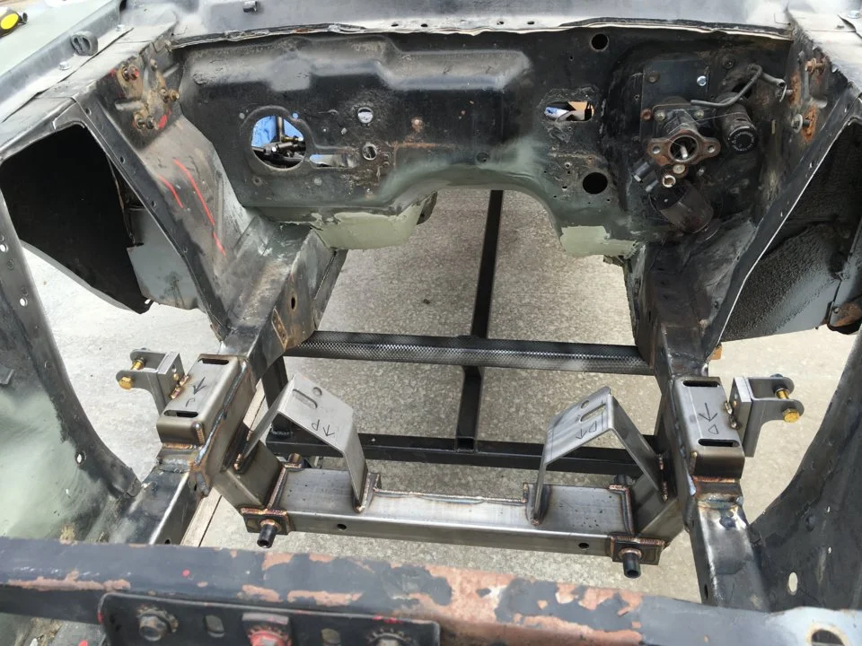

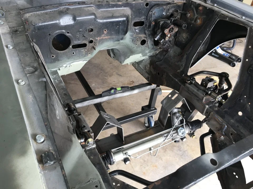

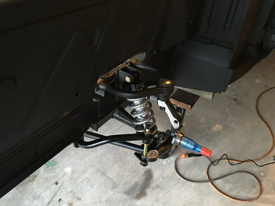

Hi just joined but wanted to post up some pics of the rod and custom ifs install. It went really well and is a solid built kit. Cannot wait to get the car on the road!
Welcome, It looks great. I wish I had done this during my build. Although I kinda like that classic steering feel sometimes.

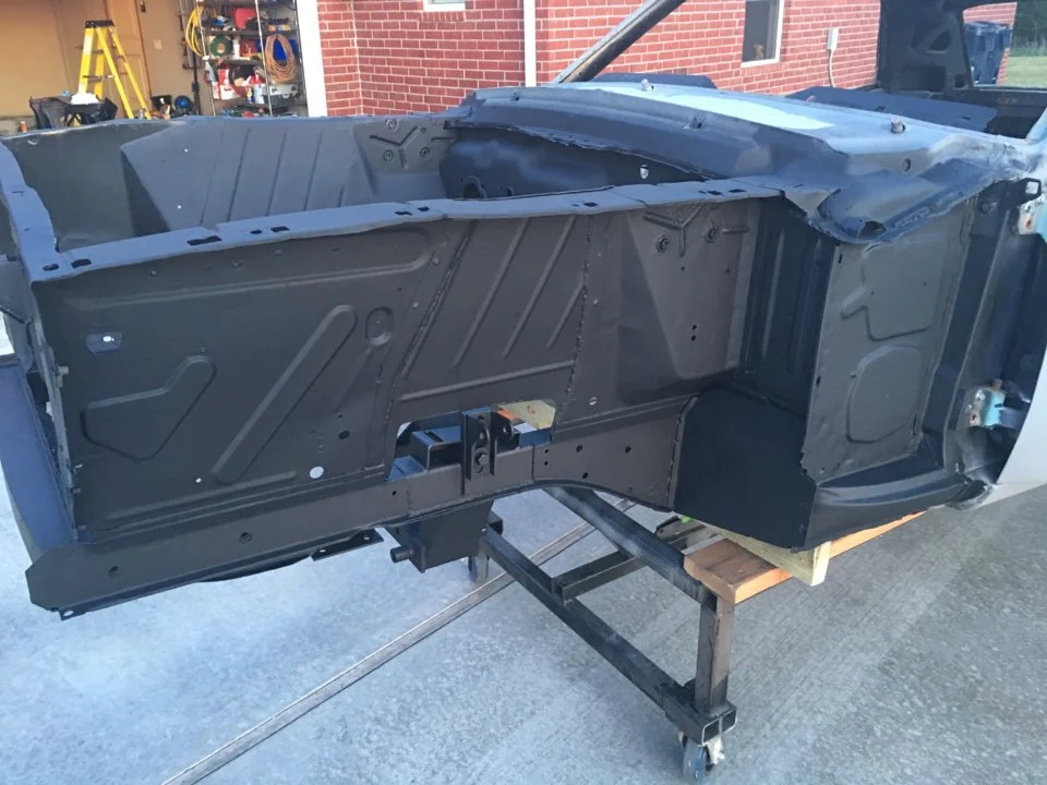

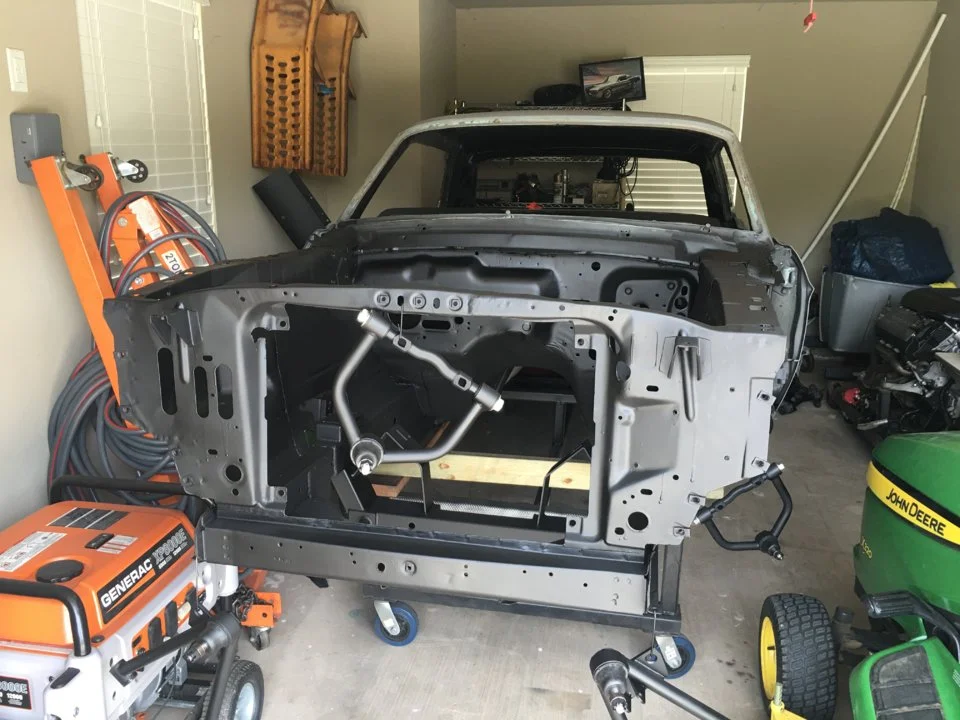

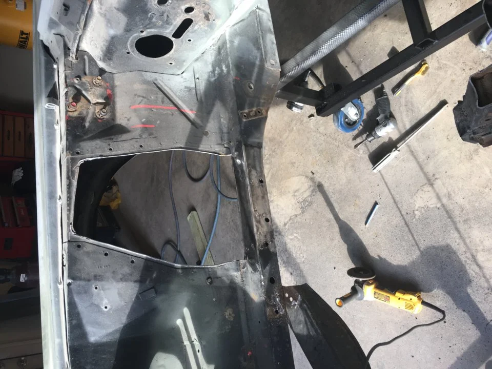

Thanks, yea I understand that. My hands were somewhat tied to removing the shock towers since I decided to go with the coyote. Also wanted rack and disk brakes and this was the cheapest way to get it done, I've never driven one with this kit on it so I hope I like it, I'm also putting the rod and custom rc114 rear 4 link coilover kit and tcp's subframe system so hopefully it's nice and sturdy

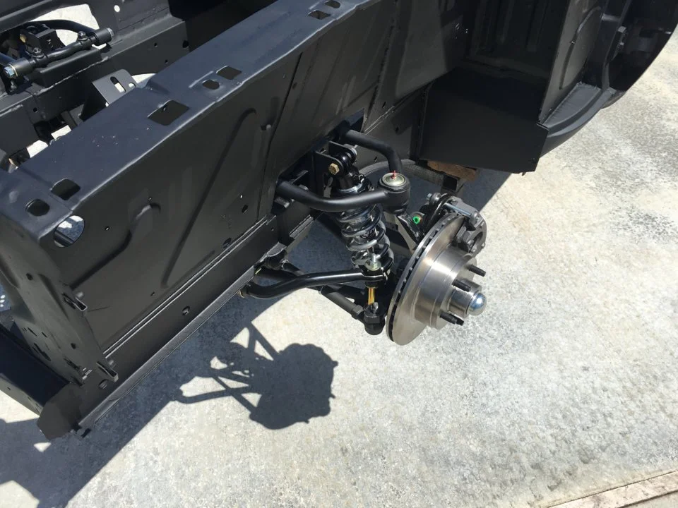

Updated with paint and shock tower delete covers welded in, still need to put the rotors and brakes on but waiting for the wilwood kit to show up
